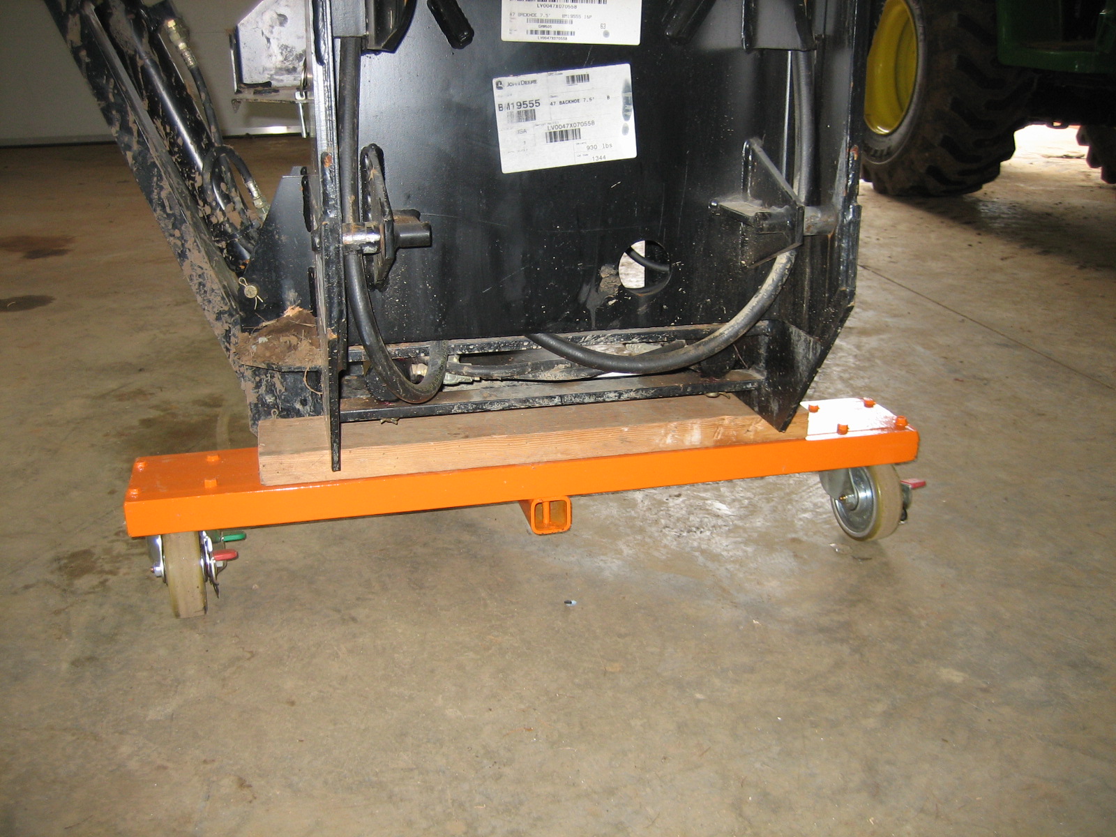

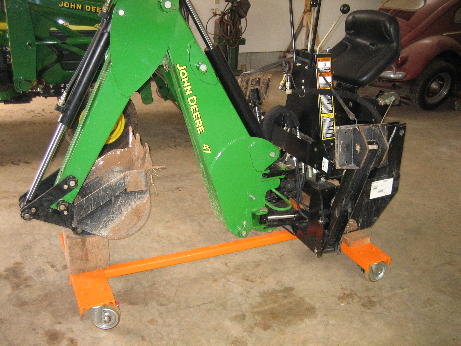

OK time to show off another scrap metal project. Got the idea from the gang on the site and made this simple dolly. Oh what a difference it makes in hooking/unhooking from the tractor, and rolling it to a corner of the shop. Literally a 2 minute job. Highly recommend a dolly for this kind of attachment.
Color is not 'tractor orange', but I like to think of it as 'safety' orange. Actually, it is 1969 Chevy truck orange.
Trick to the design was to flip the angle over, and mount the center beam to the bottom of that. This way the unit sets well on the 2x6 and no interference from the drop under the swivel.
I plan on making a perch for the bucket end rather than the wood block. Just haven't gotten to it yet. I would like to have it sit so I can reach all the grease fittings on the dolly.
Enjoy.:)

The dolly looks like it's lower than the BH when BH's mounted on tractor; did you use stabilizers to lower onto the dolly? (Thinking about "stretching" hydraulic lines, possible damage...) What was your procedure for placing onto dolly?
/ Hello Dolly (for backhoe)
Dolly had to be low so BH would clear the lower hooks of the frame plates on the tractor. It drops down about 3-4 inches when setting. That is why I had to flip the channel over, and lower the center bar as well. I could have used smaller casters but I did not want to sacrifice rolling or wheel load.
The hoses on the JD backhoe are disconnected (rockshaft is then connected to hydraulic power), then the rockshaft is used to lift up first, pull the pins, then set it down on the dolly.
Hooking it up is just that easy too. Just wheel it up to the plates which have corresponding guides on the BH, then raise the rockshaft to the top, and put the pins in. Then swap two QD hoses and go.
Dolly is real stable when loaded too. I shook the unit as much as possible and it will not tip by my force on level ground. I made the front wheels wide for stability.
Dolly is light enough to stand it up in a corner or on a wall for storage.
Dan
