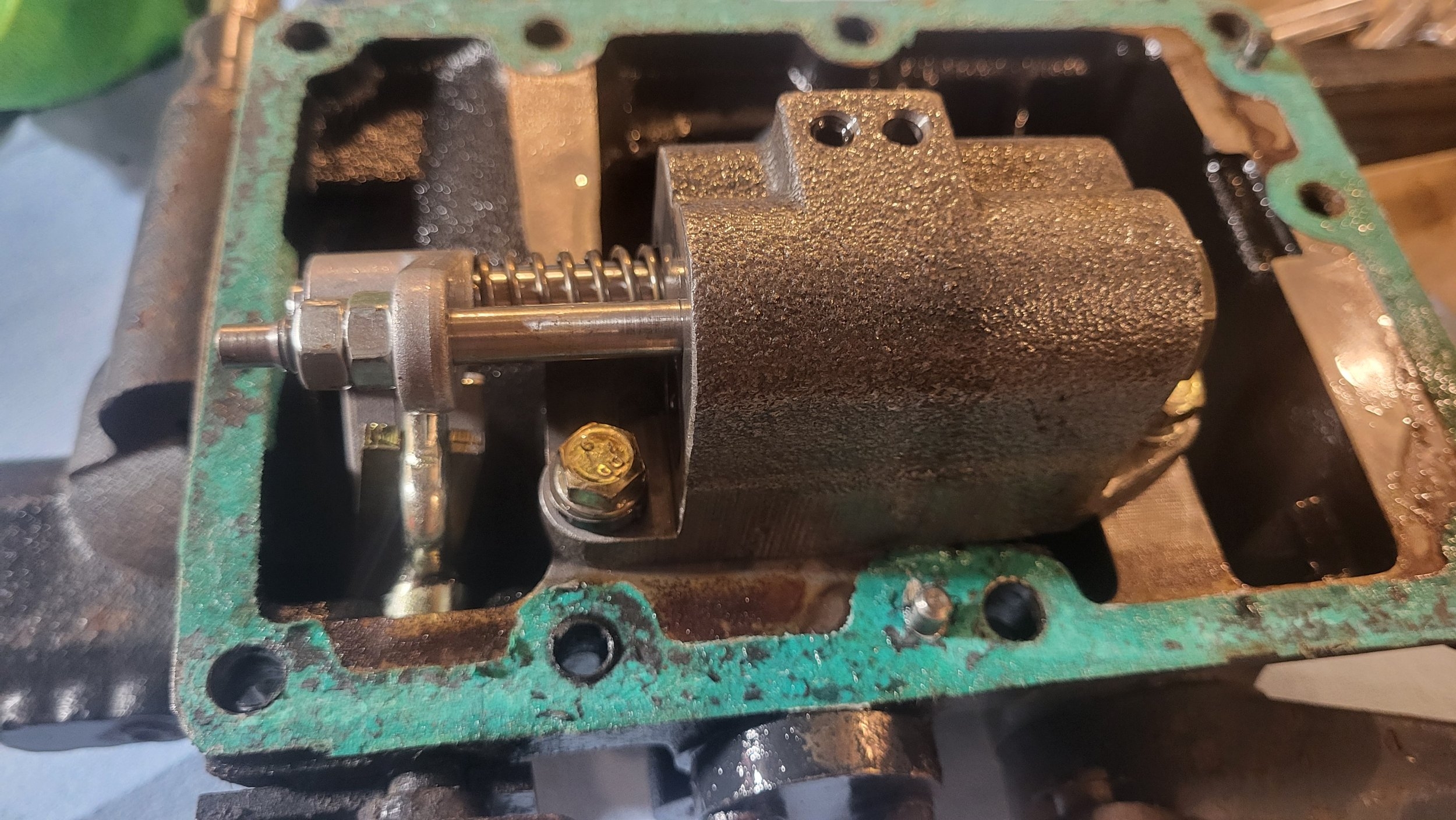

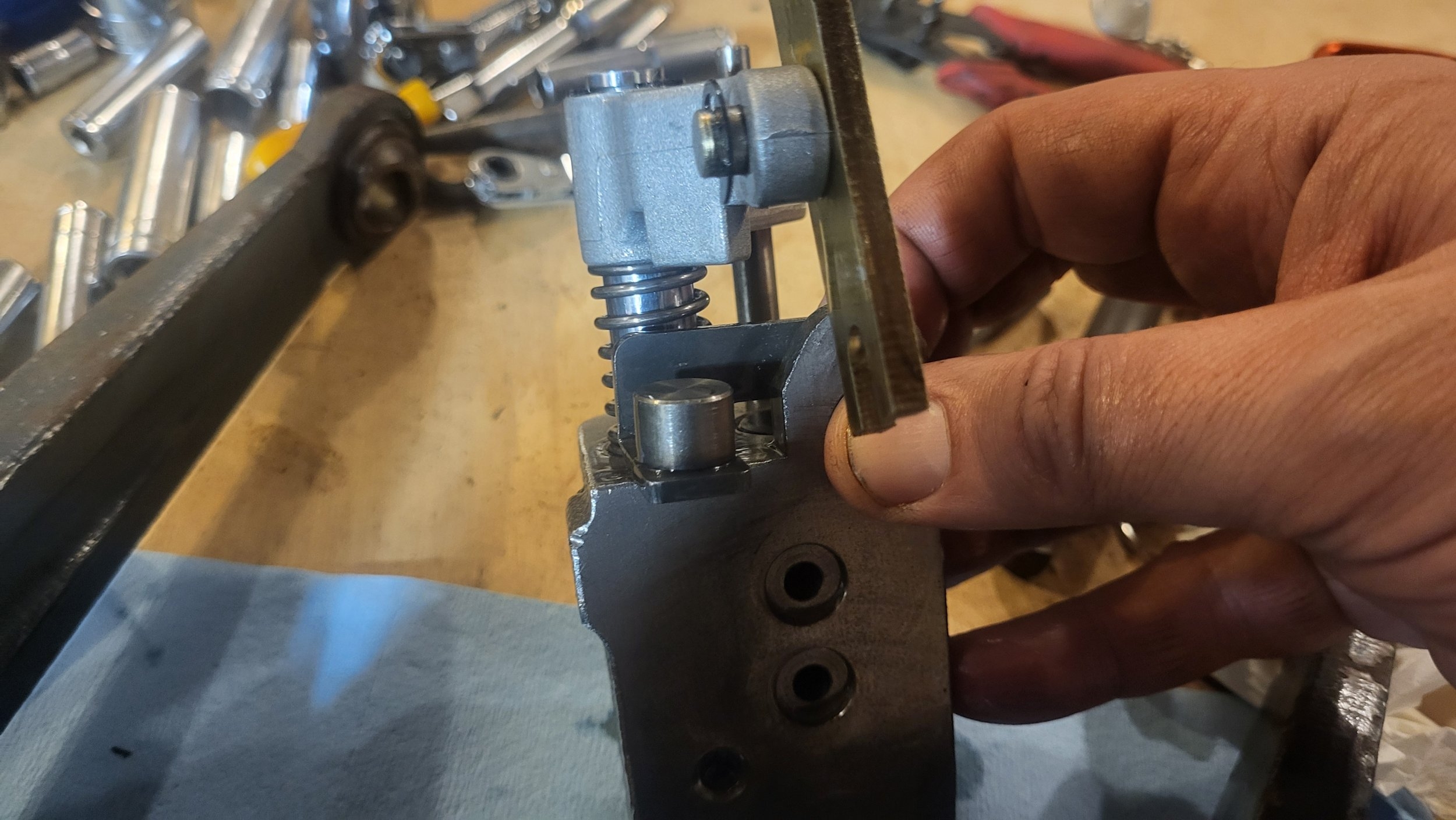

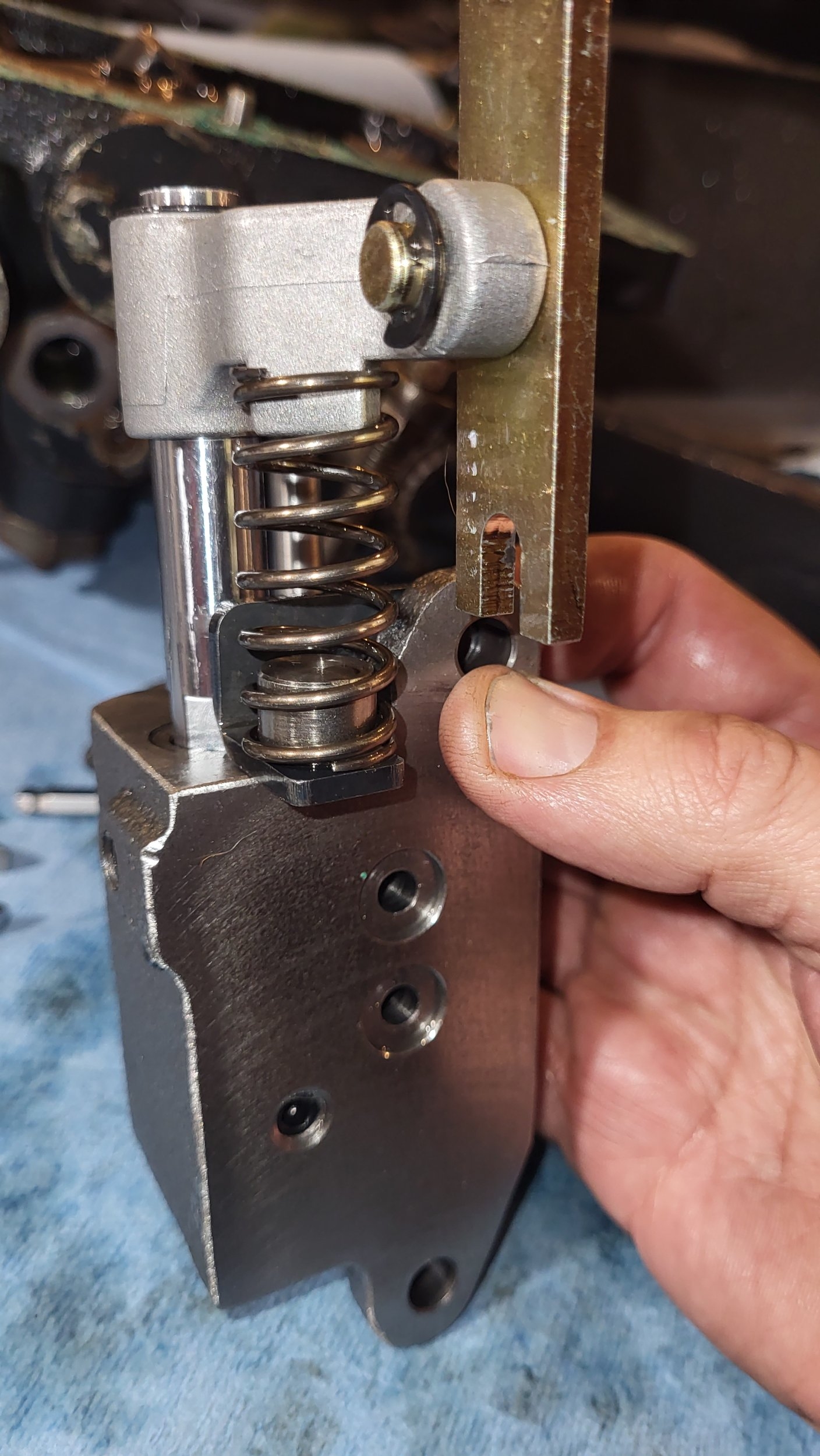

Well I pulled the hydraulic cylinder case again this evening. I may have found my position control valve issue.
Someone was in here before and had reassembled the valve incorrectly. They installed the spring over the main spool instead of between the arm and seat.
It should be like this.
I dismantled the entire valve assembly and cleaned/inspected it. To late to test tonight. Can't wait to test it tomorrow evening.

Moving the spring got my 3ph positioning working. I can now control the positioning fairly well. It still requires about 1400 rpm to move.
I priced a new positioning valve at $506 USD. I'll play with it a bit more tomorrow but it's working for the most part.

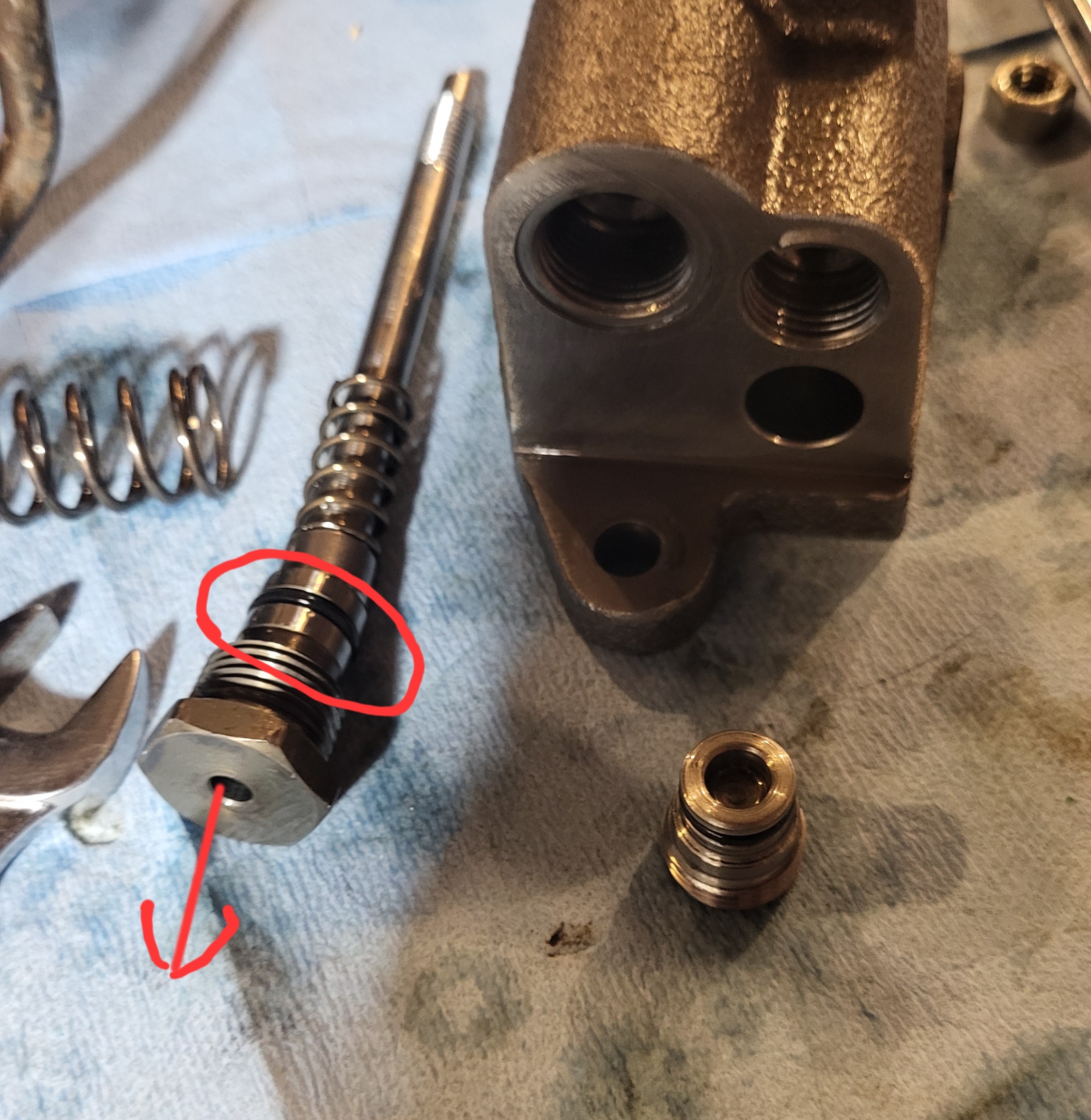

Can you operate the 3 point with the lift cover off? If yes can you tell or see where the oil is flowing with no command to raise? Does the flow stop out that point when command is given to raise?
Just trying to determine where flow is going when give command to raise the 3 point.
   / Hello from a new Branson 2400h owner.
#59
The lift arms stay in position until I lower them. There is no leakage by the piston.
I plan to shim the cover with 2x4 and run it. I suspect to see fluid flow from this port if this O-ring is leaking by.
I'll get the old Mitutoyo digital calipers out and see if I have O-rings that fit.
