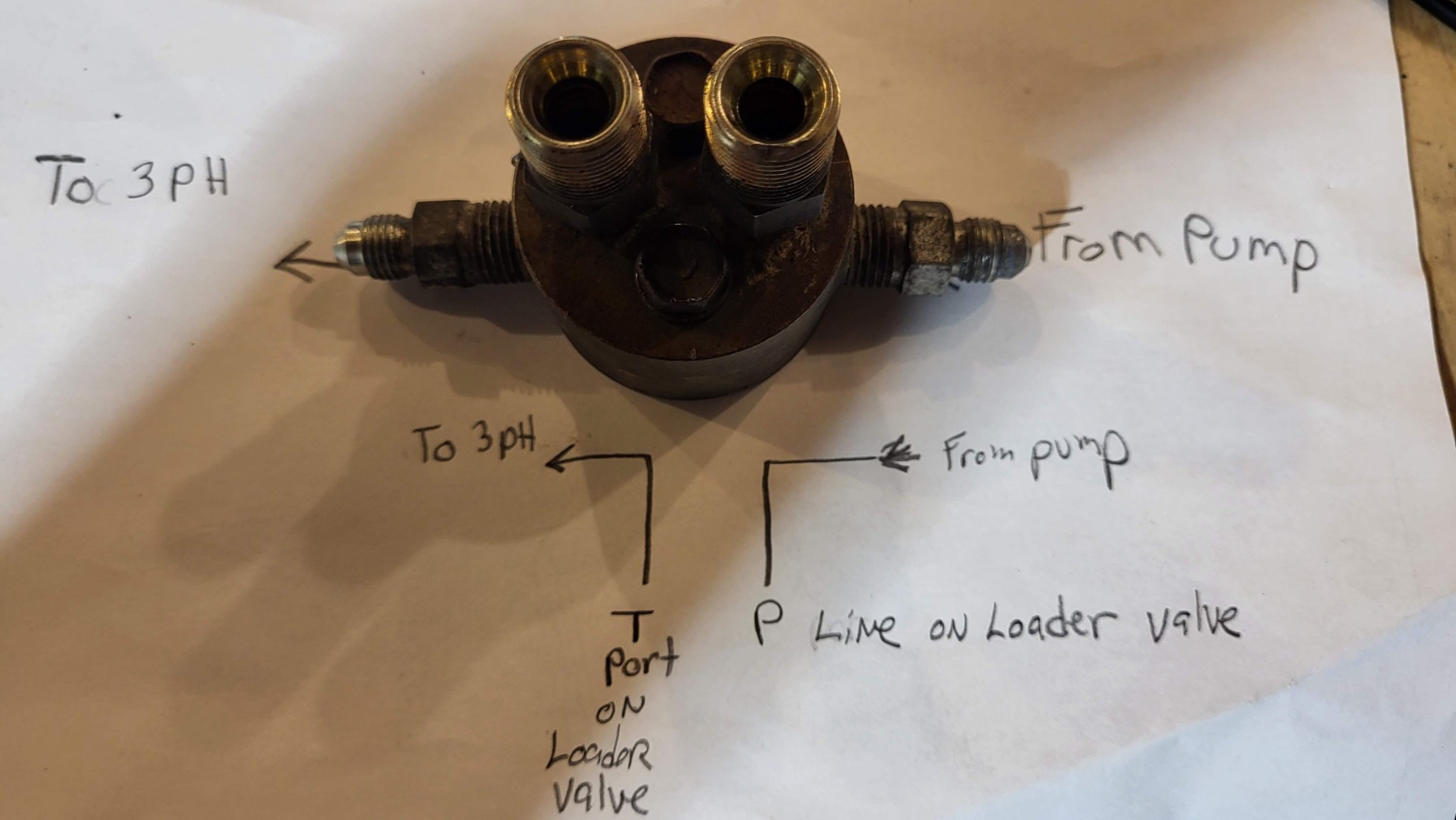

Do you have the equipment to install a pressure gauge in your system in the pressure port of the loader valve? Be curious to what the pressure is while operating the loader vs the 3 point while engine is at idle or around 1,000 RPM for reference number. If won’t build pressure on 3 point then need to determine where the oil is going. If out T port of loader valve that would point towards a problem in that valve like K5 suspects. If not out T port of loader valve then would point towards something in the 3 point system.

I zoomed in on that power beyond sleeve and noticed it looks to have a Teflon oring backer. Mine does not. If I can't find one I'll make one on the lathe. Would be nice if it was just that backer missing.

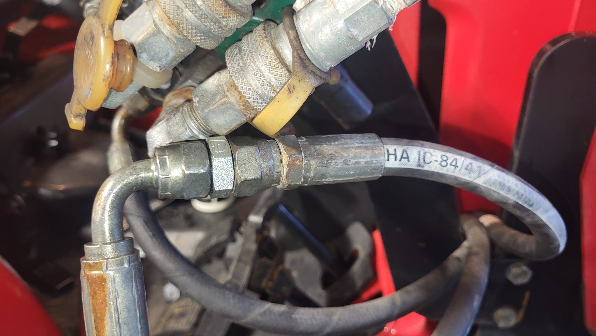

It might be worth a try just loop these two ports together and take the loader valve entirely out of the system for testing purposes of the 3 pt hitch. As far as we know, the 3 pt piston seals could be damaged and it will only lift with more flow by increasing the engine RPM.
   / Hello from a new Branson 2400h owner. #45
I like PTSG idea of eliminating the valve. Could possibly take hoses off valve and connect together if don't have jumper hose.
   / Hello from a new Branson 2400h owner. #46
That was just a generic picture not the one for your valve. Backup ring is not necessary on all sleeves.

I bypassed my loader valve to rule it out.
Problem remains. I now suspect the 3ph positioning valve again. I need to get a procedure for adjusting the freeplay on the positioning valve.
