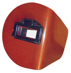

/ Helmet "Cheaters" #19
/ Helmet "Cheaters" #20
What's the reason for only one side covered?
