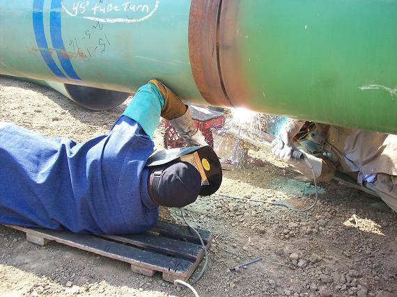

What's the reason for only one side covered?
When welding pipe, one ear or the other is exposed to the sparks. Right handed welders need to cover their left ear. Left handed welders need to cover their right ear.
