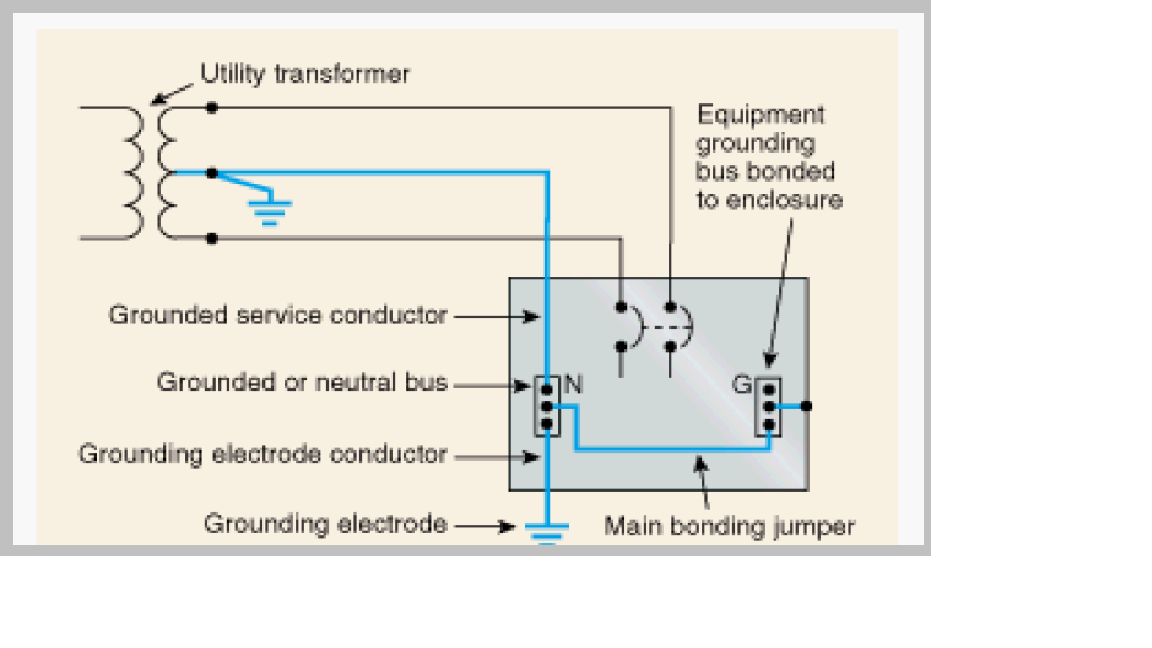

Most likely in the neutral connection some where, either the connection at your box, in the cable, or at the utility's transformer. Note: Your panel neutral bus should be "grounded" to 0 Volts by a connection to your ground rods. This connection should be made at one location only, at the first disconnect point of your service. Typically there is a jumper between the panelboard's neutral bus (white wires) and the ground bus (green wires) in the panel, and the ground bus is connected to a ground rod in earth.

Most likely in the neutral connection some where, either the connection at your box, in the cable, or at the utility's transformer. Note: Your panel neutral bus should be "grounded" to 0 Volts by a connection to your ground rods. This connection should be made at one location only, at the first disconnect point of your service. Typically there is a jumper between the panelboard's neutral bus (white wires) and the ground bus (green wires) in the panel, and the ground bus is connected to a ground rod in earth. <img src="http://www.tractorbynet.com/forums/attachment.php?attachmentid=357821"/>
One of the first things the electrician tried was adding a new ground.

Sounds like you may have it narrowed down, another way to check the panel box is to run your appliances and try to see a hot spot in the panel with a FLIR camera. A laser thermometer will work as well. You could also lift both ends of the service feed and megger it...

Temporary cable fixed it. Of course the utility company guy didn't come out until 230 on a Friday so they'll have to come back next week to fix it. Wait wait wait.
