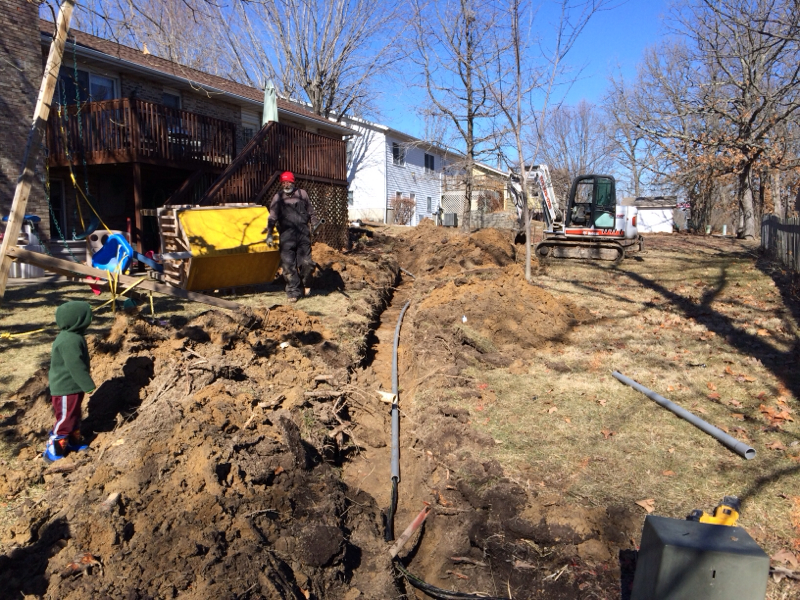

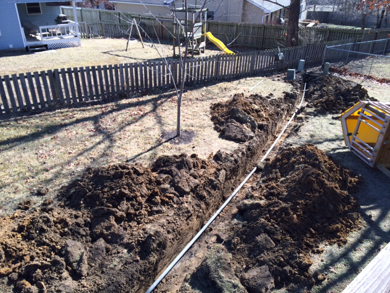

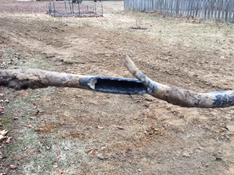

Fixed! I think anyway. I haven't tested any voltages but the kill a watt on my kitchen has been reading 118.4-119.6 since yesterday. It was a damaged neutral. About 2 inches if it was corroded away. The electrician said I was probably using the ground wire pretty heavily.
yup..just like i thought. i little nick in the insulation of urd burial wire = corrosion

I know I'm a little late to this thread, but had the same thing happen a few weeks ago. Half of the house had power, half none. Checked my sub panel, and every other breaker had no power. Checked main service panel, and only had one leg. Called power company, and sure enough there was burn out in one of the underground cables.
This service is over thirty years old, so I guess over time the insulation can form cracks. They dug it up and replaced. They were responsible for service to the meter.
