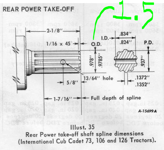

I like your thinking.
I can find 10 spline to 6 spline shaft couplers on the web all over the place.
Will you send me a link to one? I've looked and haven't found one where the 10 spline female end is 1.5" diameter.
   / HELP! Howard Rotavator pto shaft #13
so you are saying to up size this to 1.5?

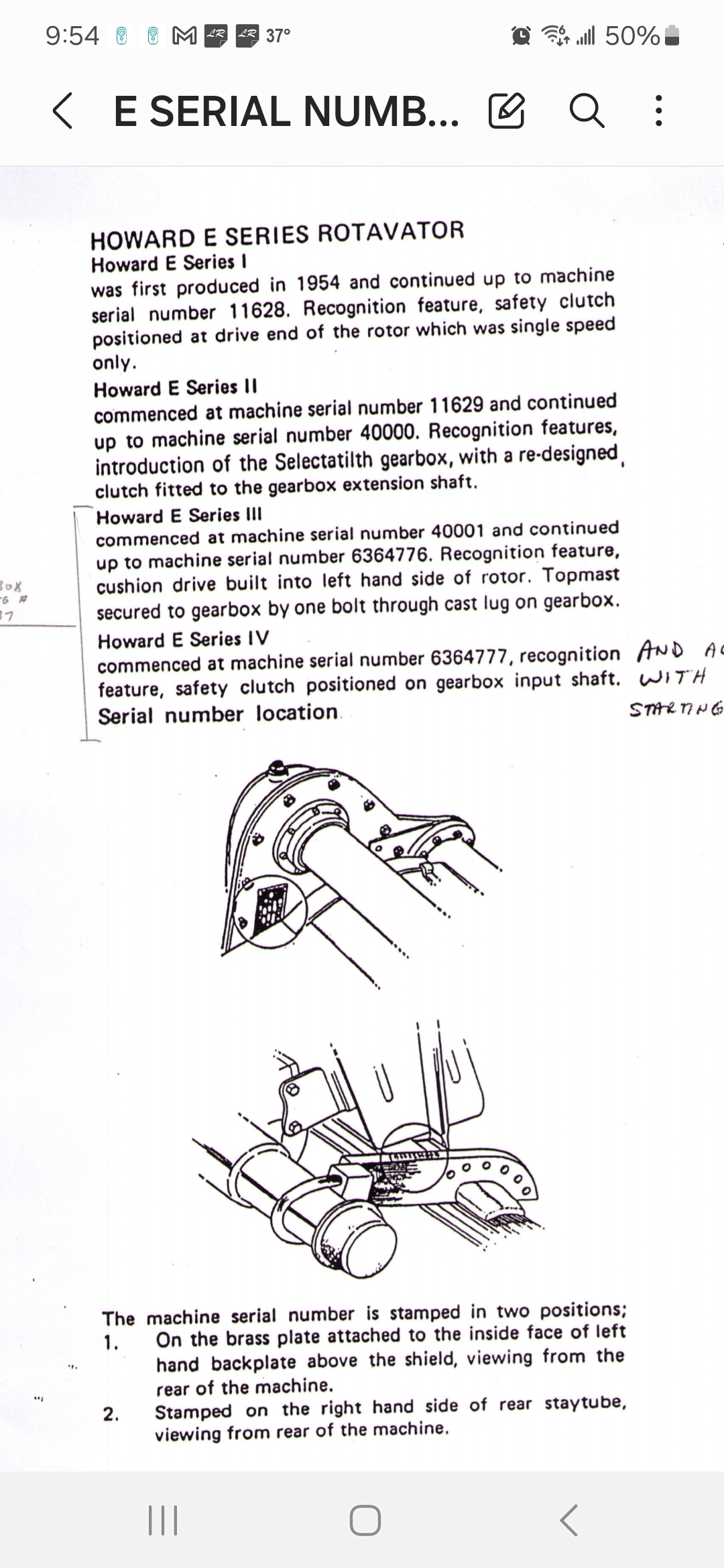

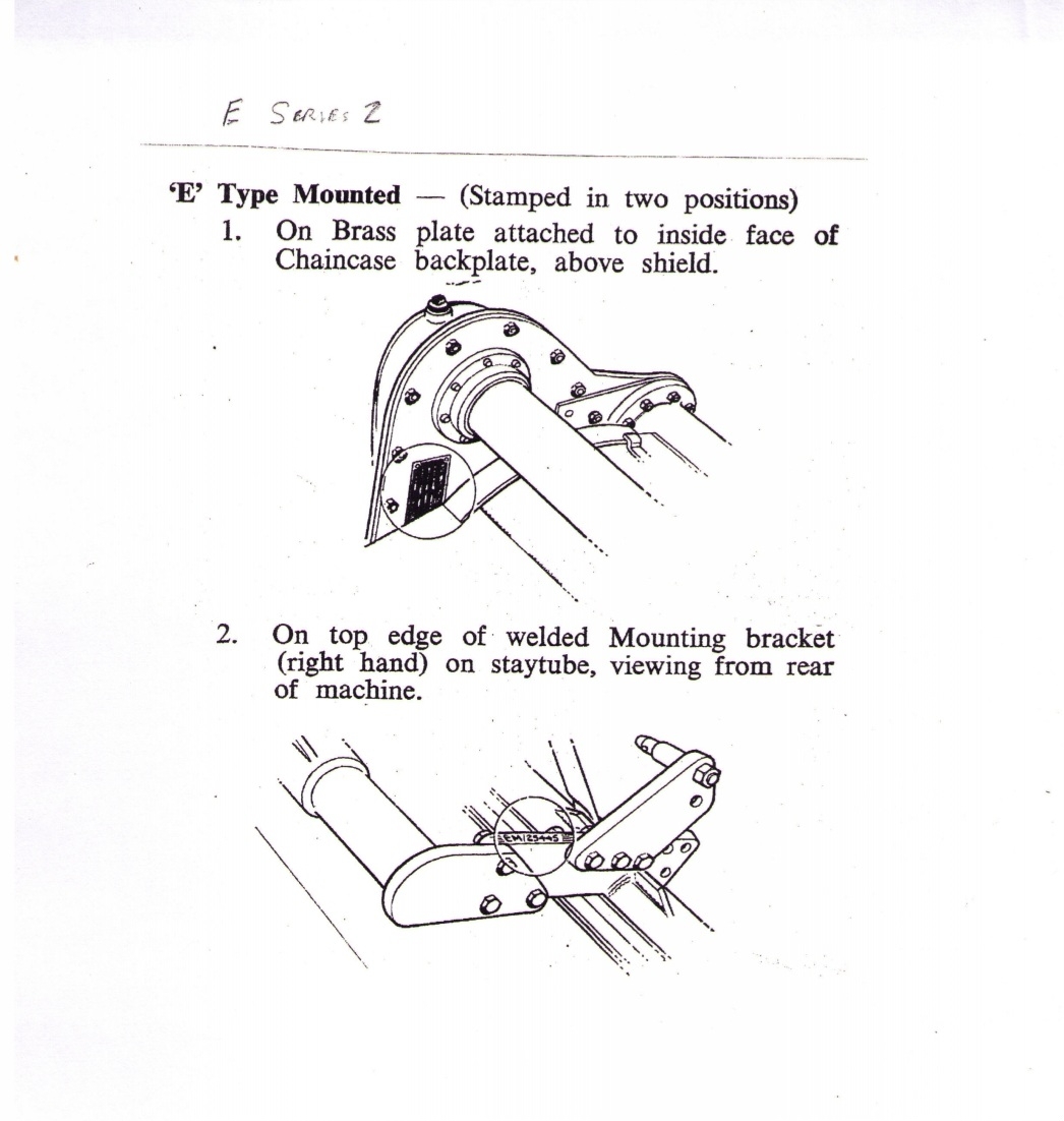

E Series II. Series 1 had a 1 speed gearbox only.

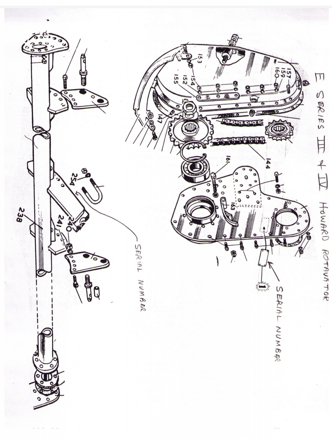

#19
I just found a serial number stamped on the staytube, 6375186. In one manual it had series numbers compared to serial numbers. So given that serial number I think it is a series IV. Correct me if I'm mistaken. See picture.
Again thanks for all the help.

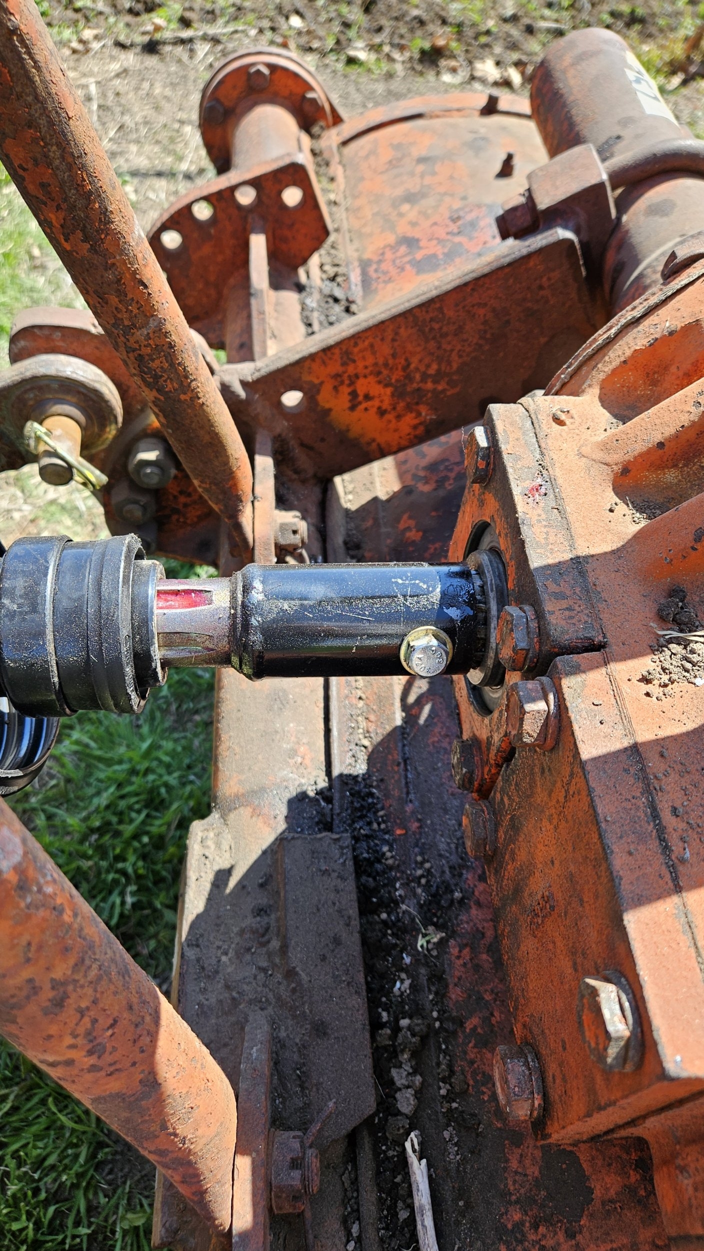

#20
SOLUTION. I ended up having an adapter machined to go to a typical 6 spline shaft. Then added a shear pin.
