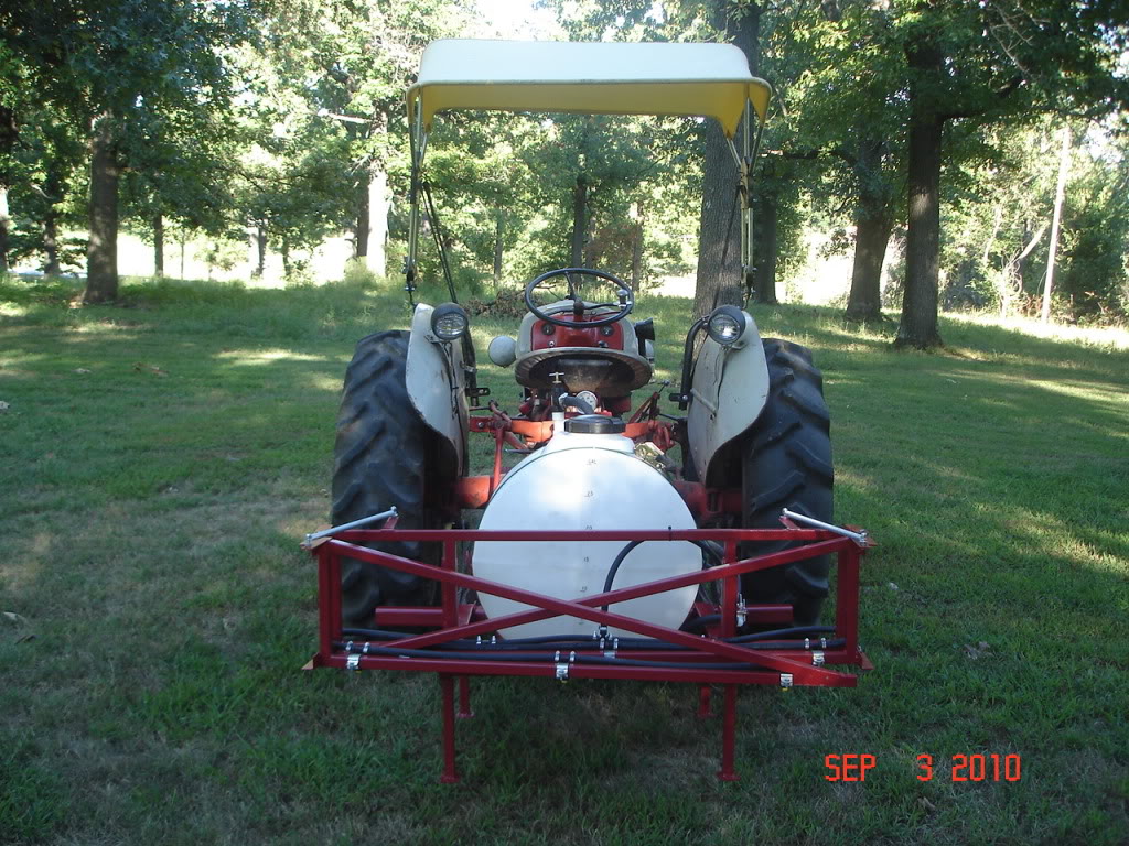

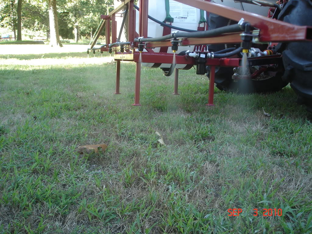

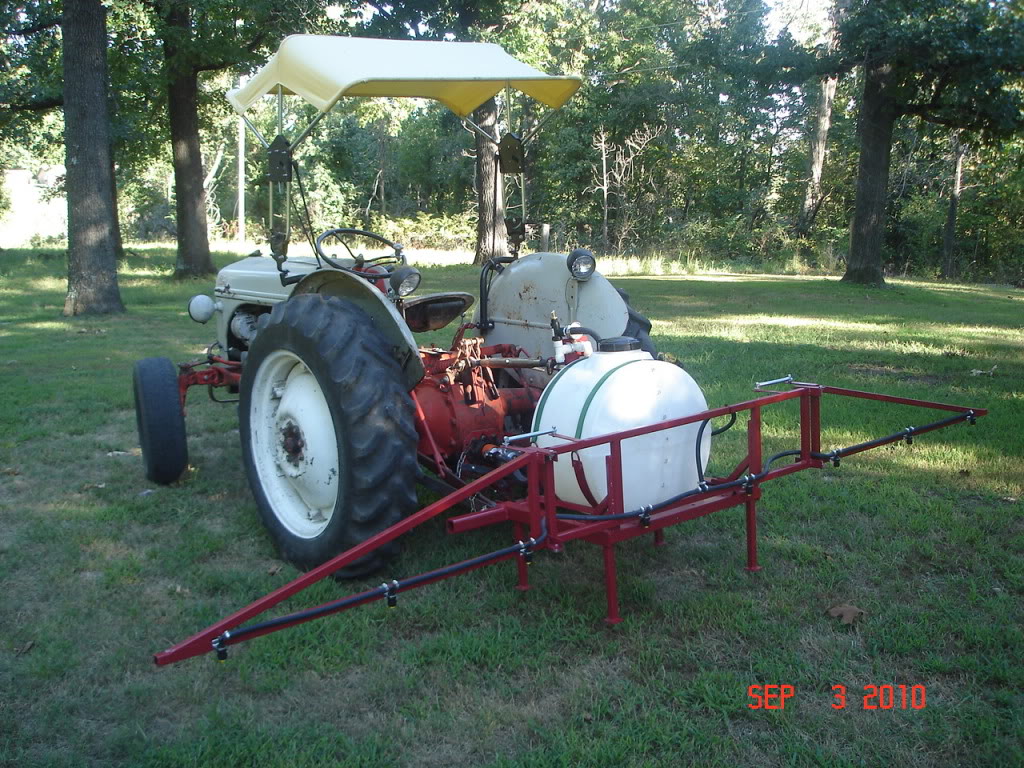

This is what I came up with to spray the lawn. I started with a fifteen gallon tank but made the 3-pt. platform big enough to hold a larger one. Works good for my applications.

Tractor supply is where I got my nozzle bodies, "T" s, nozzles and hose.
They still had all the stuff when I was there last week.
