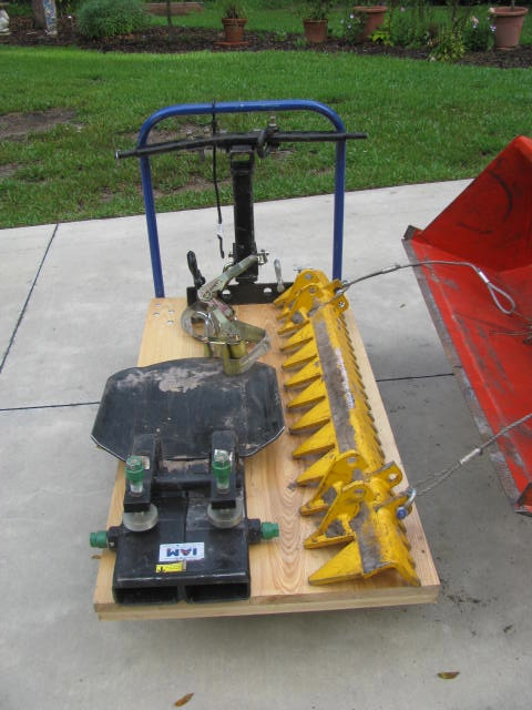

One of the first tricks I learned with my BX2660 was to go to see on TBN what they do and realized it was easy to attach a few casters to a pallet or a few boards and make rolling dollies for my equipment .....the second best advice it took me three years to come across was that it was way easier to align the pto shaft splines with the rear pto splines by putting the PTO shift lever in mid pto position so that I could turn by hand the rear pto shaft. Another very helpful aspect was to replace the turnbuckles stabilizers that you bust your knuckles on loosening and tightening........... with pinned sliding adjustable stabilizers they are so much easier and even hold the three point hitch wide open so you can back up close right away. I got mine from a weblink I found on TBN but I think he no longer makes them.........but there are others out there.

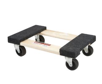

I have decided to put it on dollies.
My idea will be to put it on casters with brakes and then attach it to 2x6 and plywood. I'm hoping that will prevent any type of spin, but at the same time allow for easy operations.
Thoughts on that idea?
/ Help setting up tractor for multiple attachements #31
Worth a shot. I might throw a few bags of cement mix onto the Dolly also, and bolt the Genny down.
/ Help setting up tractor for multiple attachements #32
I have decided to put it on dollies. My idea will be to put it on casters with brakes and then attach it to 2x6 and plywood. I'm hoping that will prevent any type of spin, but at the same time allow for easy operations. Thoughts on that idea?

I think you will need Leveling Threaded-Stem Casters so you can get them off the wheels not just breaks.. if its like my 7KW or puny 2k portable those things rattle pretty good and I think you would be hard pressed to keep it in one space with just brakes on wheels..
