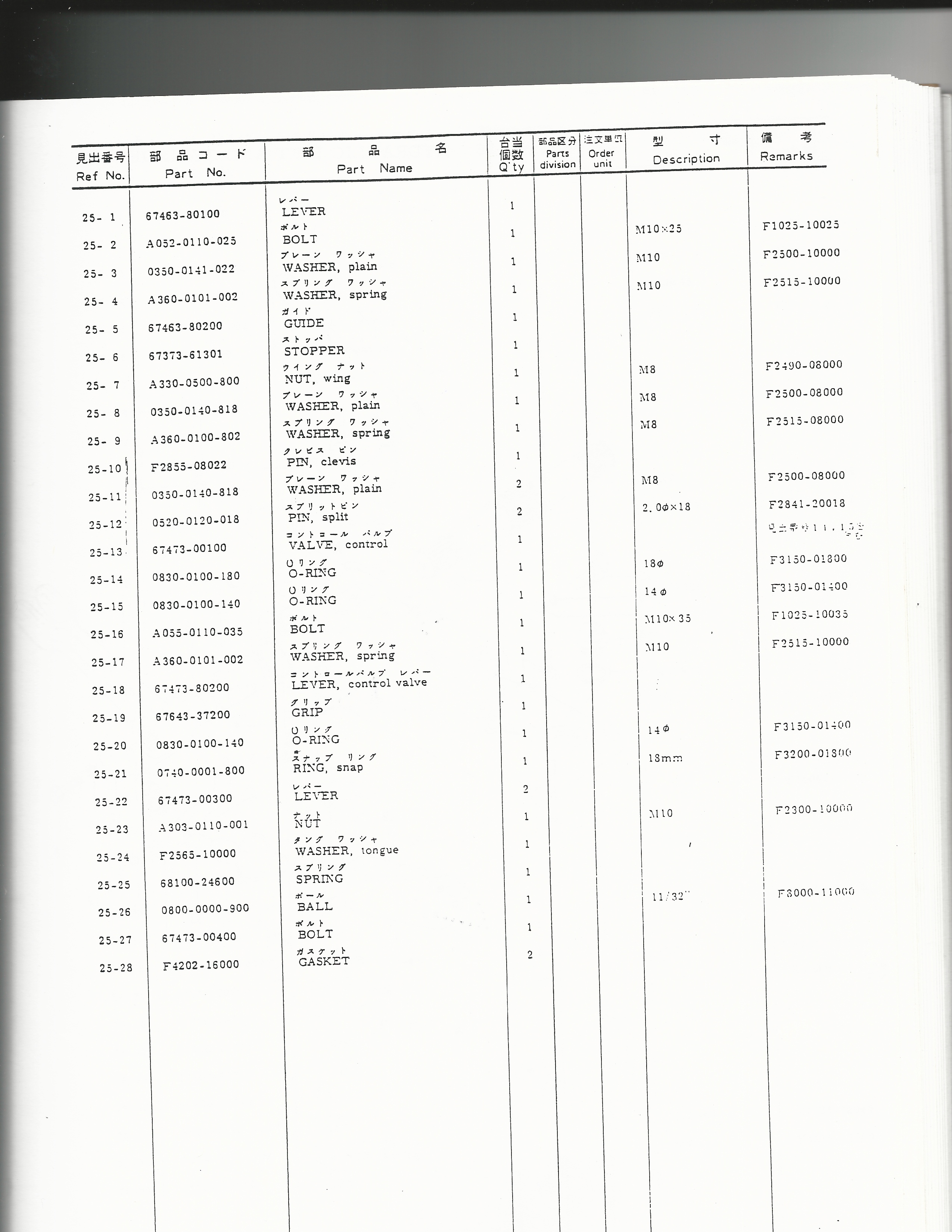

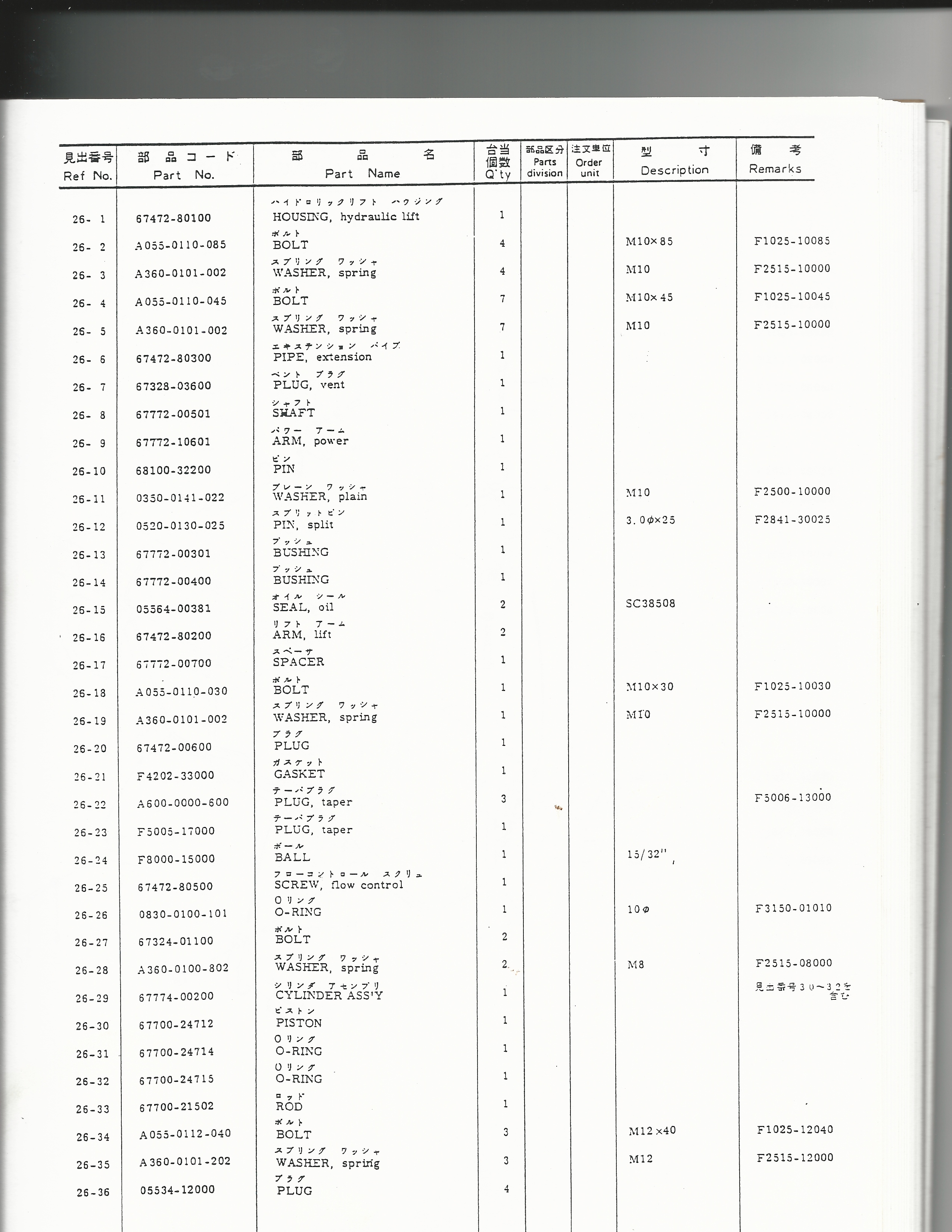

I was finally able to get the pages showing the 3ph to scan for me
   / HELP weak pump or worn lift cylinder?
#43

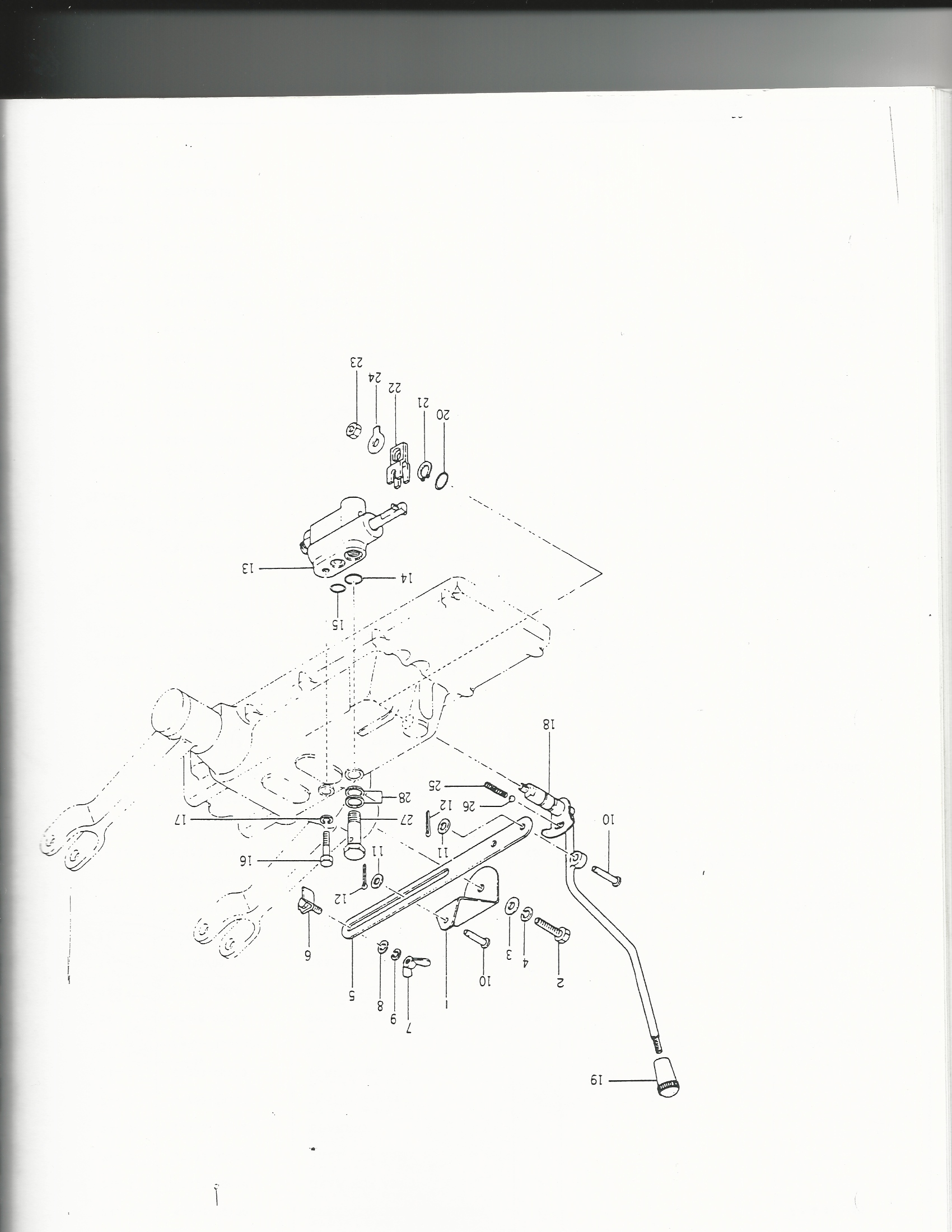

I'm thinking the relief valve has to be built into the control valve, right?
   / HELP weak pump or worn lift cylinder? #44
The scanned pages are a big help but what would make them even more helpful would be photos of the same area of your tractor.
I believe the relief valve would be built into #13 the control valve which looks like it is inside the lifter casing and not accessible. Only the rod of the control valve sticks out is this correct?

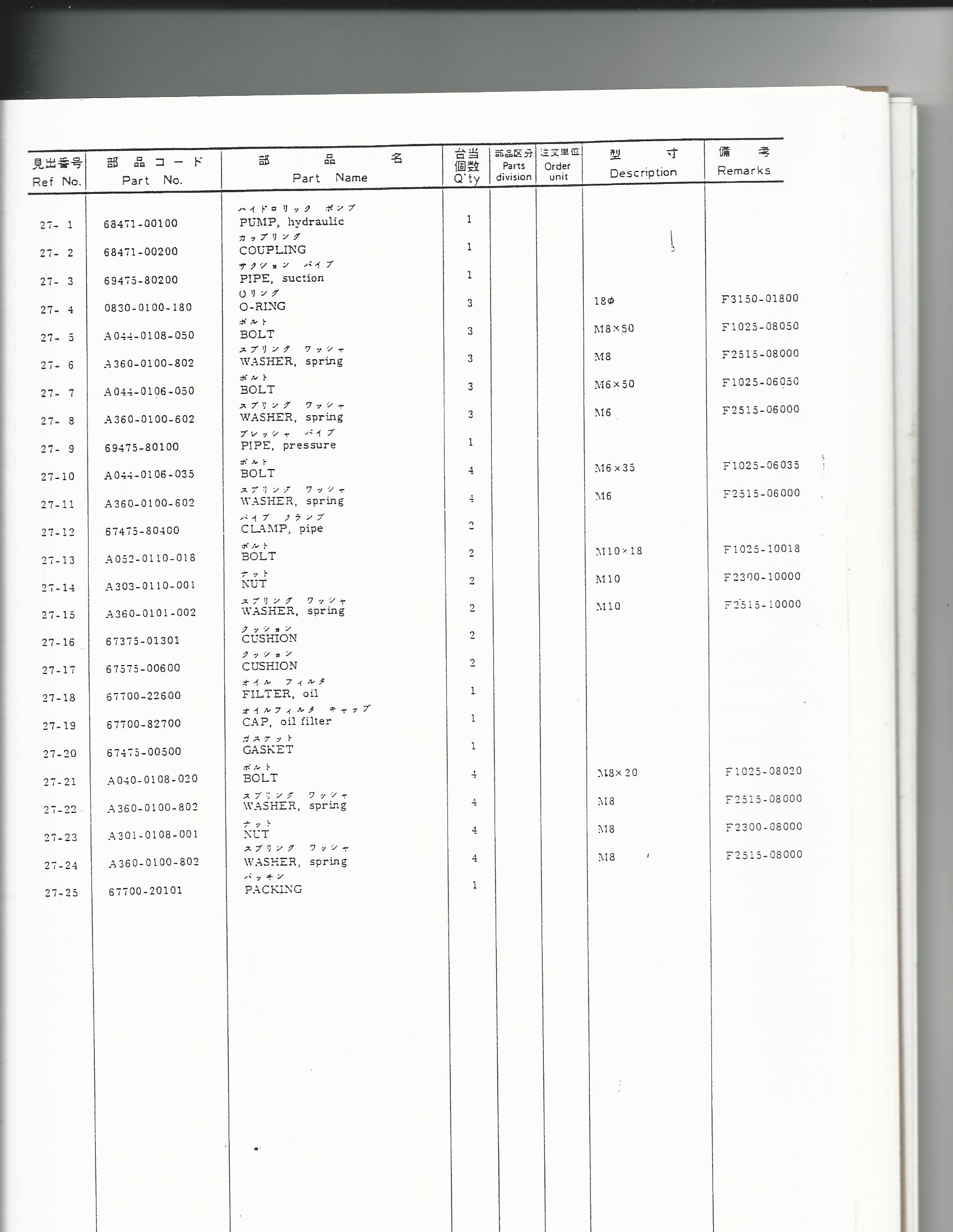

Are there parts pages for the pump and hydraulic pipes which you could provide?

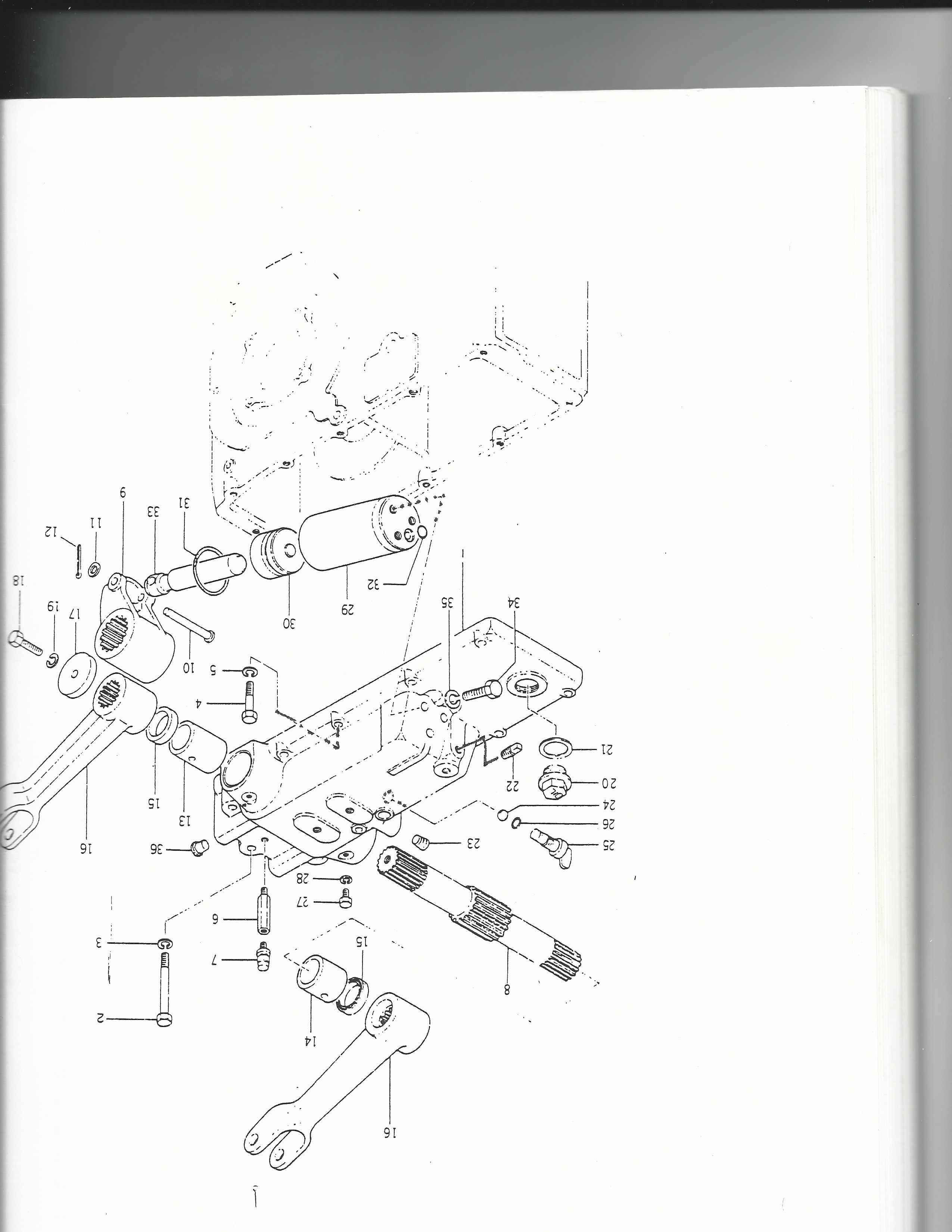

I see two tapered pipe plugs (#22 & #23) and I am thinking if these plugs seem close to where hydraulic lines connect, they could be a place or places where pressures could be checked.

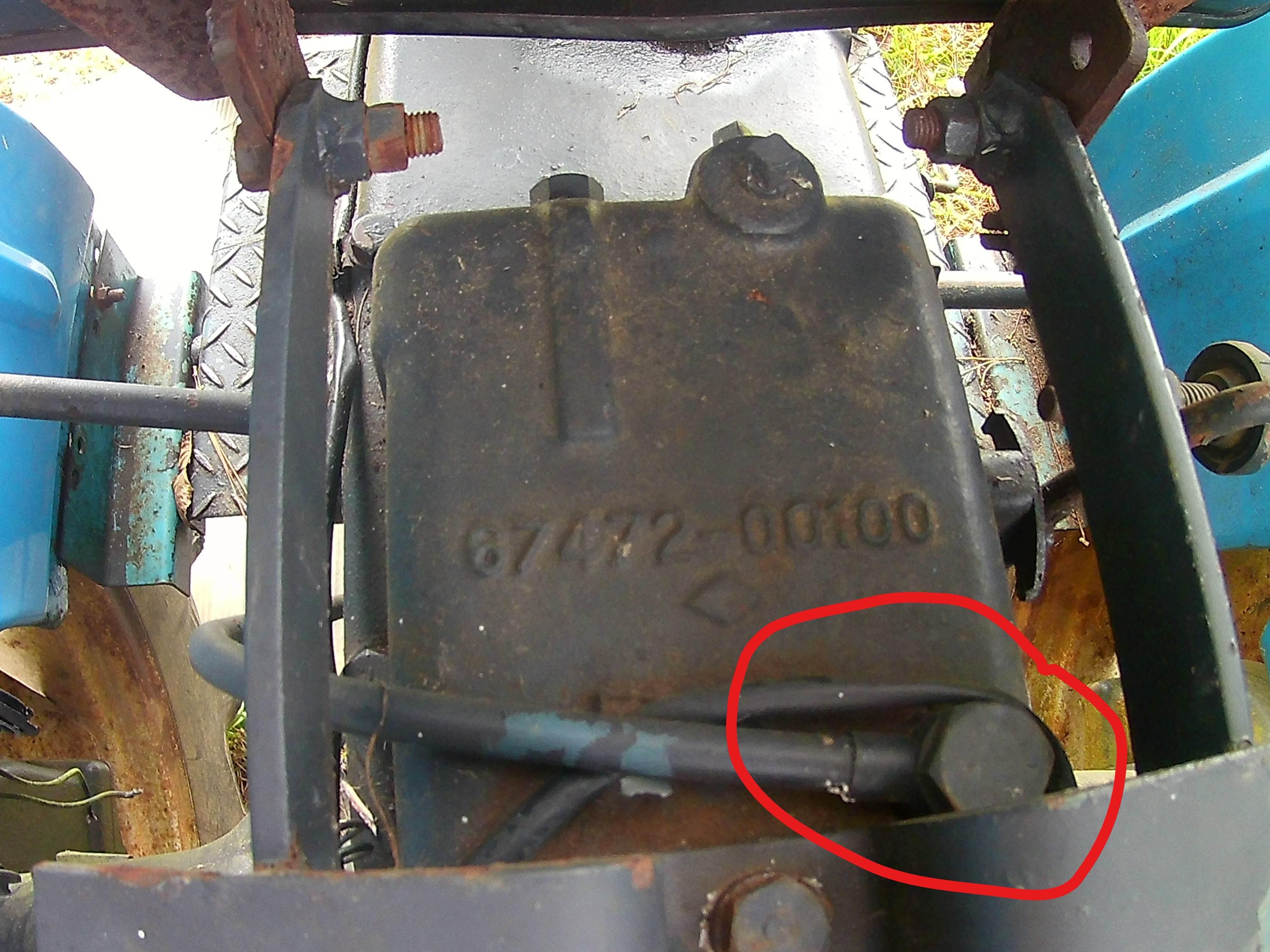

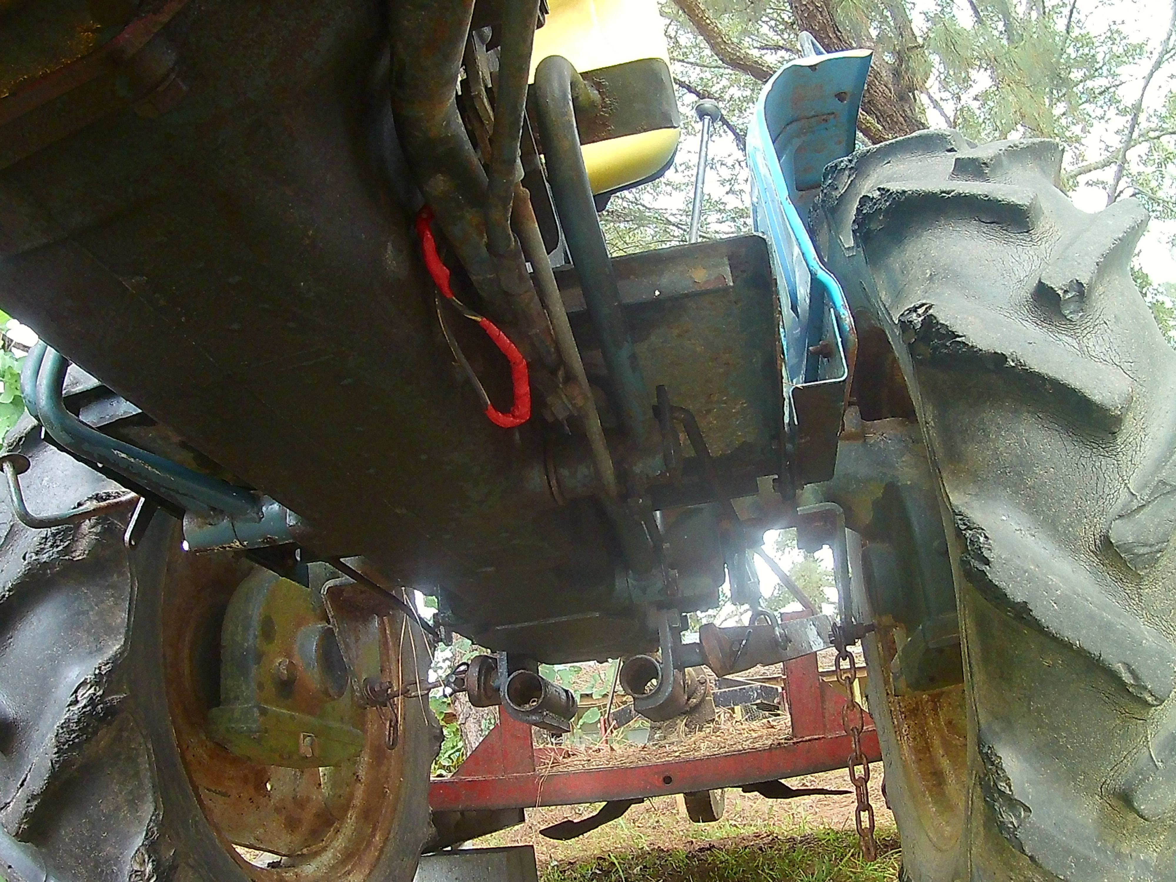

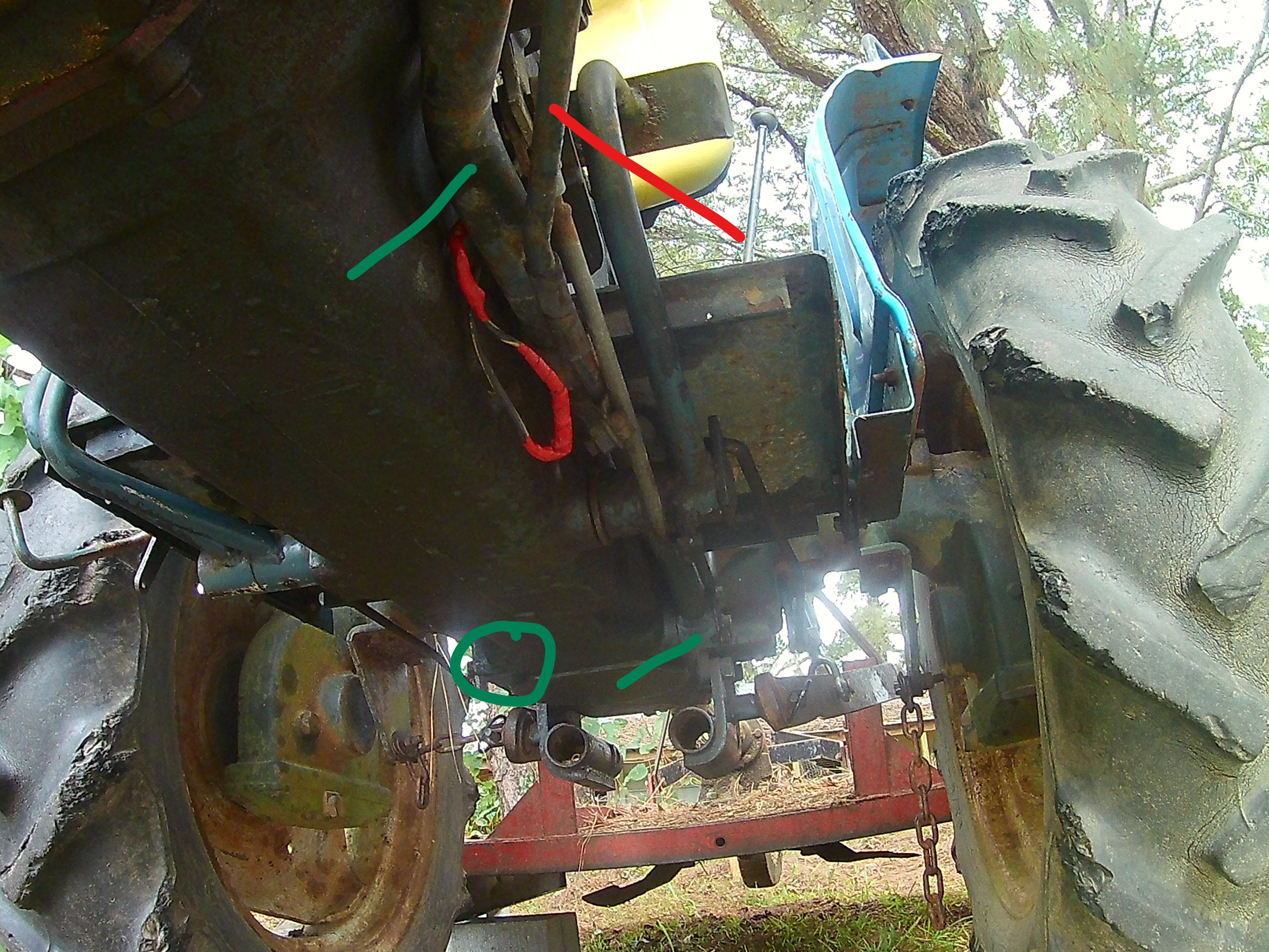

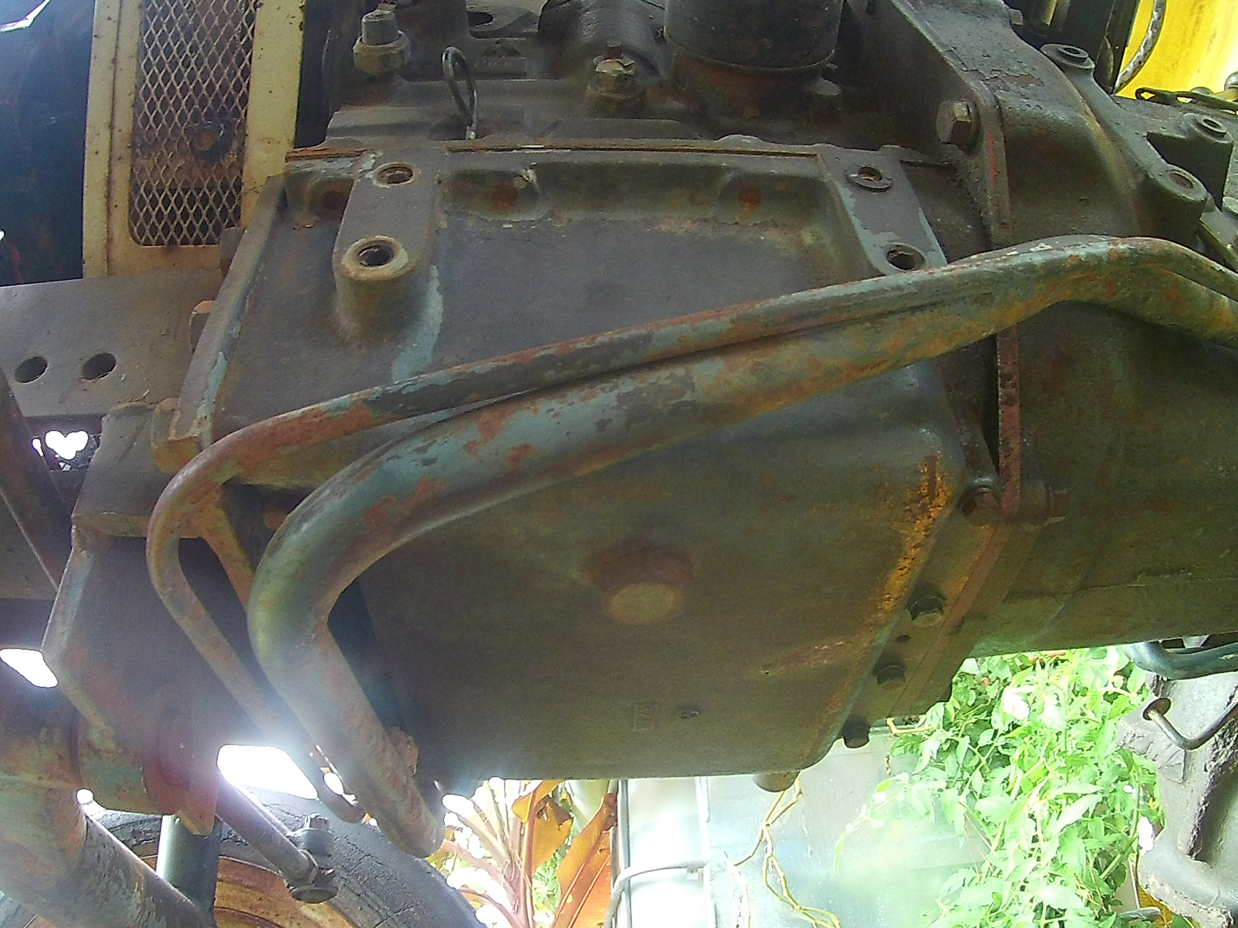

20161222_041726.JPG Big line is low pressure "inlet" to the hyd pump, small line is high pressure "discharge from the pump.
20161222_041722_LI (2).jpg Big line "green" connects to the trans housing towards rear of tractor, green circle opposite side is where hyd filter is located. Small line snakes its way to top of trans housing20161222_041609_LI.jpg

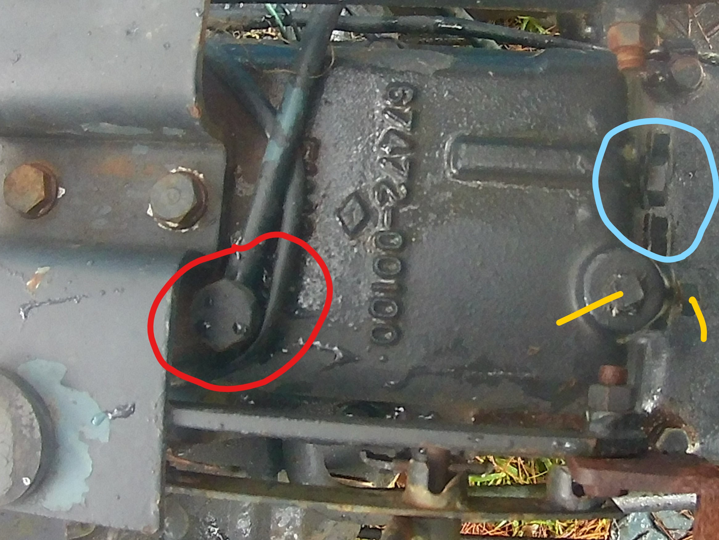

20161223_061745_LI.jpg red circle shows where high pressure connects "#27" on the page that shows "#13" control valve.
Yellow shows 2 of the 3 plugs "#22" on the page that shows "29" lift cylinder assembly. I'm thinking that these plugs are just to block the flow passages that were drilled in the lift housing to get hyd fluid to the lift cyl. These "drilled holes" are did at the factory of course and should provide high pressure for a gauge and at the same time NOT dead head the hyd pump.
Blue shows the bolts "#34" that attach "#29" to the "#1" hyd lift housing.

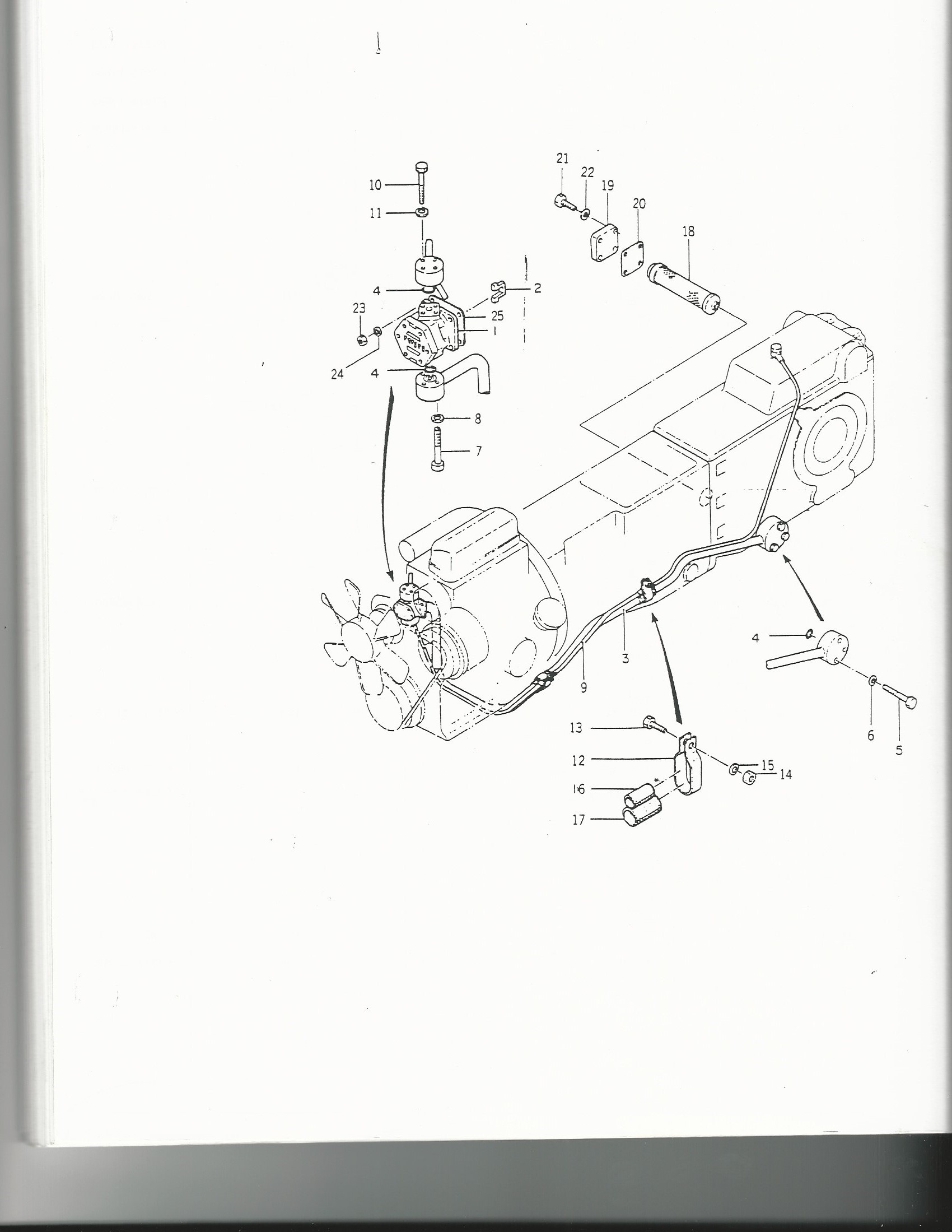

Yes the control valve is inside the lift housing and the control valve lever sticks out the right side of the lift housing.Hydraulic circuit.jpg scan of hyd piping & part numbers

I think removing the tapered plugs and then probing with a thin wire would be helpful.
Two of them may be actually in the same oil passage. As you probe and look at the parts digram you may get a better sense of which plug or plugs are before the lifter valve and which are after.
Getting a pressure gauge and necessary fitting to attach where tapered plug was would be a good idea and I would do it before pulling off the lifter top.
The parts illustration show a number of small o rings between the lifter valve and the housing, between the cylinder and the housing. Any of these inexpensive seals could cause the problems you have.

KAYABA is the manufacturer of your pump. I can find KAYABA hydraulic on google searches.
Another forum member who I asked for some help found a used pump on on ebay but it was sold.
The important info from ebay were 4 photos which I feel closely resembles your pump.
Do you think these pictures look like your pump?
They came from a Yanmar tractor.
In my mind I doubt the pump is the problem first because of the cost of replacing it. Getting a new pump and the system still operates the same way would make both of us feel sick.
I think it would be worthwhile for you to talk to your hydraulics people about doing a pressure and flow test on your pump in their shop..
The number 22 small seals inside the top cover give me a concern as one of them being broken would drain off the pump output and lower the 3 pt.
Consider which you want to tackle first. Pump check or seal check.
