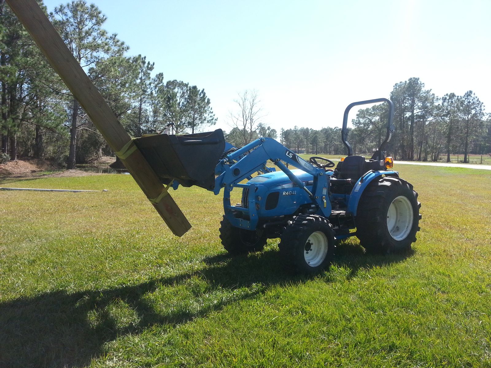

this just gave me the reason why I do need chain hooks welded onto my bucket. I've been stalling on doing that, too many other projects but I just picked up a 5x5-16' post by my poor old body and dropped it into the hole today and this post would have been the solution.

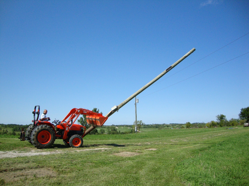

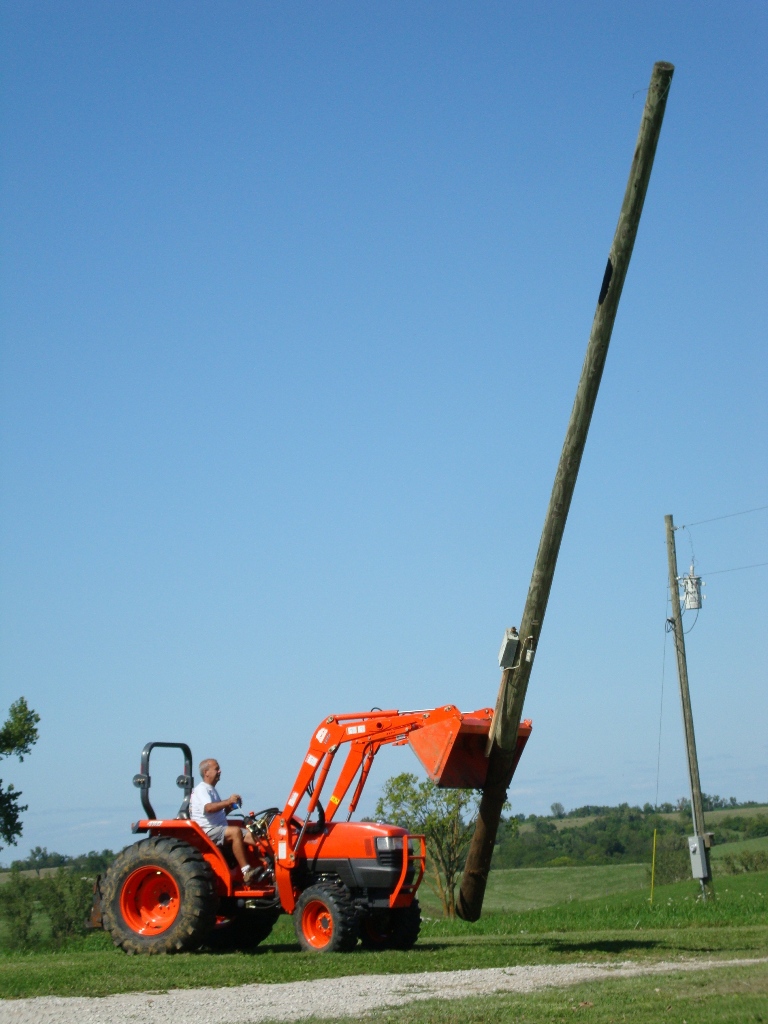

Lay the pole on the ground in front of the tractor in the same direction as the tractor. Roll the bucket completely forward and set it on the pole, leaving enough pole under the tractor or below the cutting edge of the bucket to allow the pole to be set in the bottom of the hole before the bucket edge hits the ground. A chain holding the top of the pole and a chain holding the bottom. Just don't leave too much pole under the bucket or you'll have trouble getting it picked up.
View attachment 358417View attachment 358418

I've used that method several times. It's best to use rachet straps if you have them or a load binder if using chains to get them tight.
Don't let the safety police catch you though!!!! ;)
I have a link hook welded at each end and a slip hook welded in the center. One of the first things I added. I use the crap out of them!!!

took Ovrszd's idea.. and it worked.. used ratchet straps so it didnt destroy wood
it wasnt easy, the first pole took about 3 hours to get into ground.. but 2nd pole took about an hour
thanks for the help fellas!
