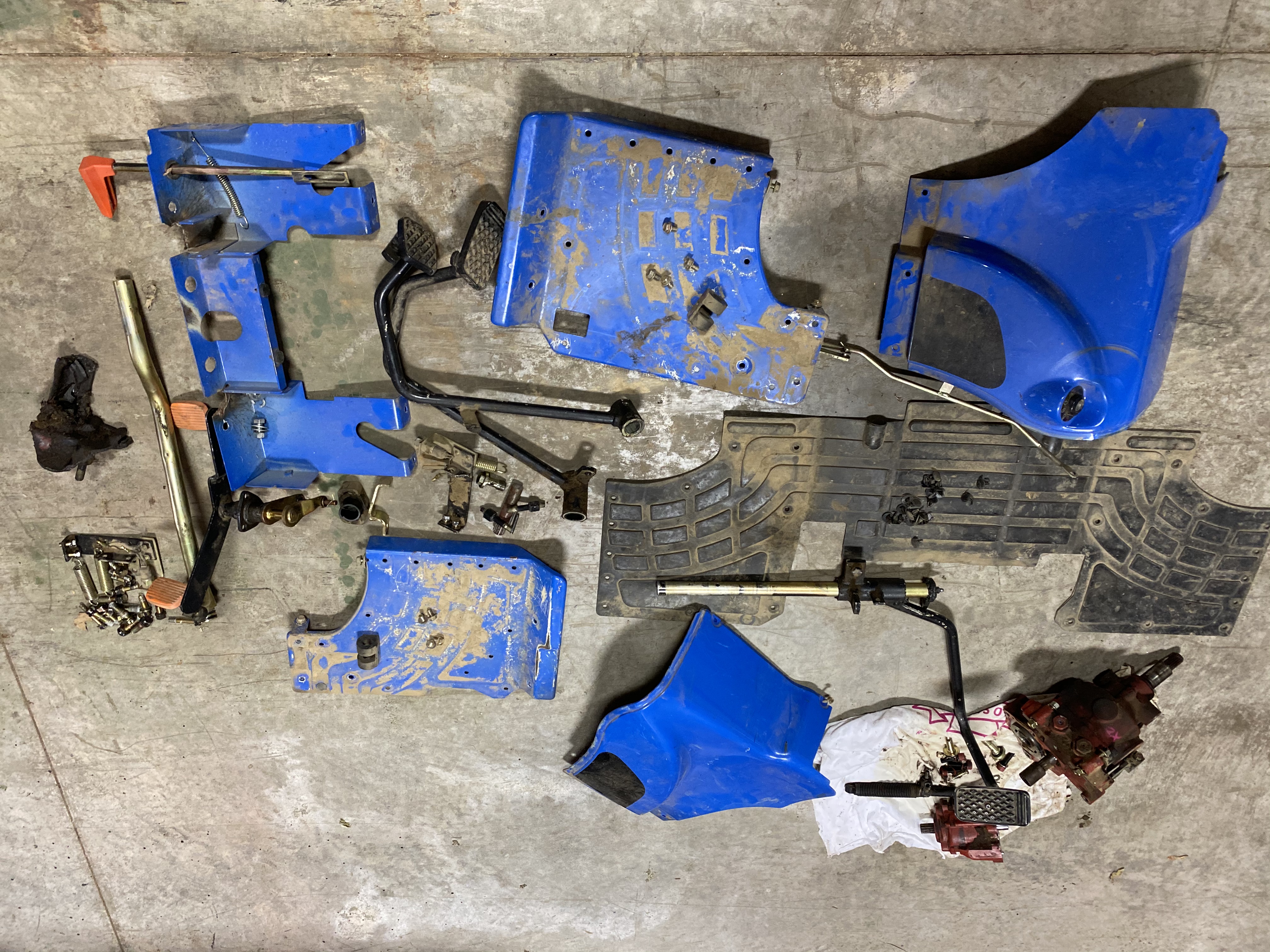

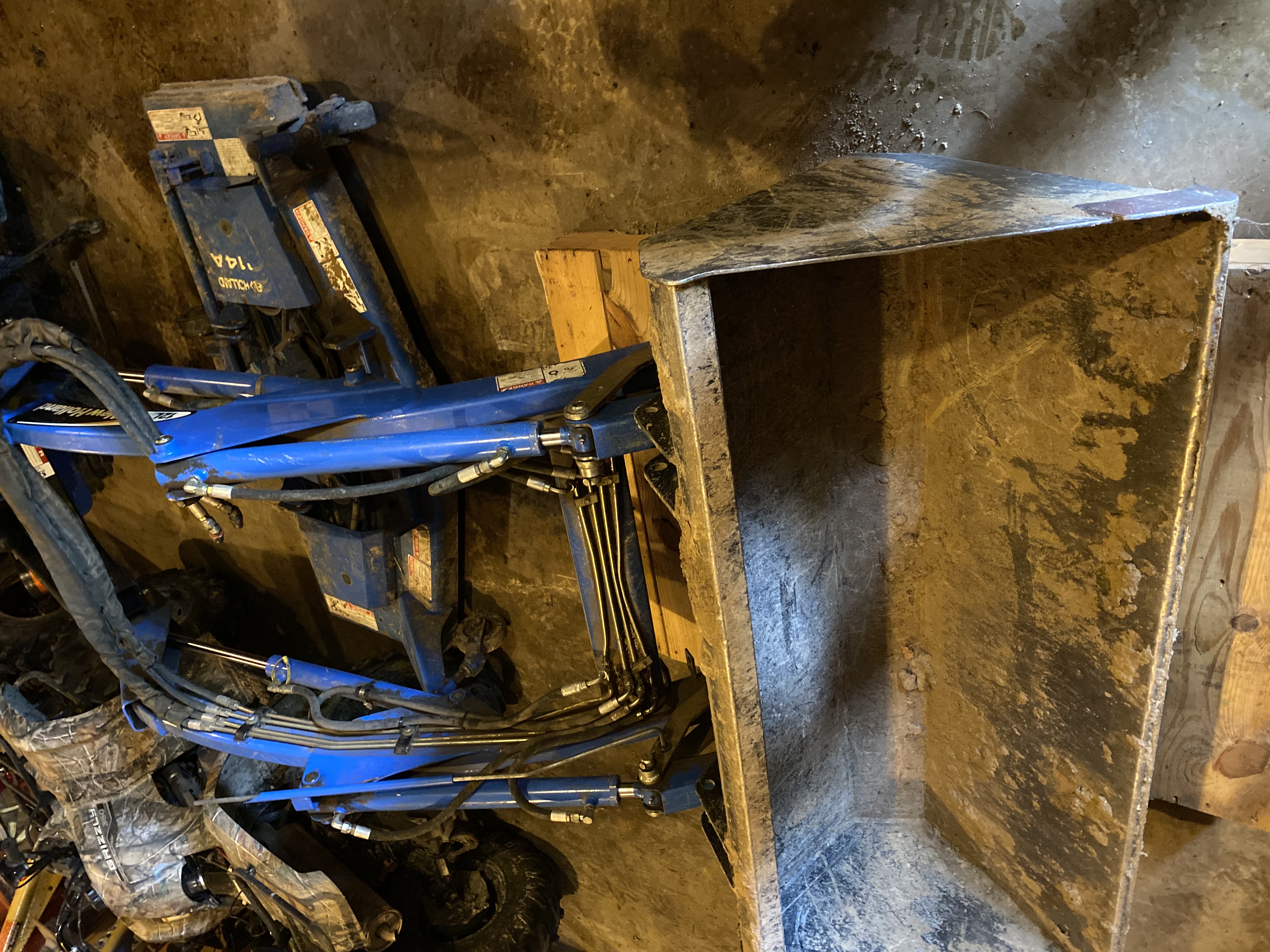

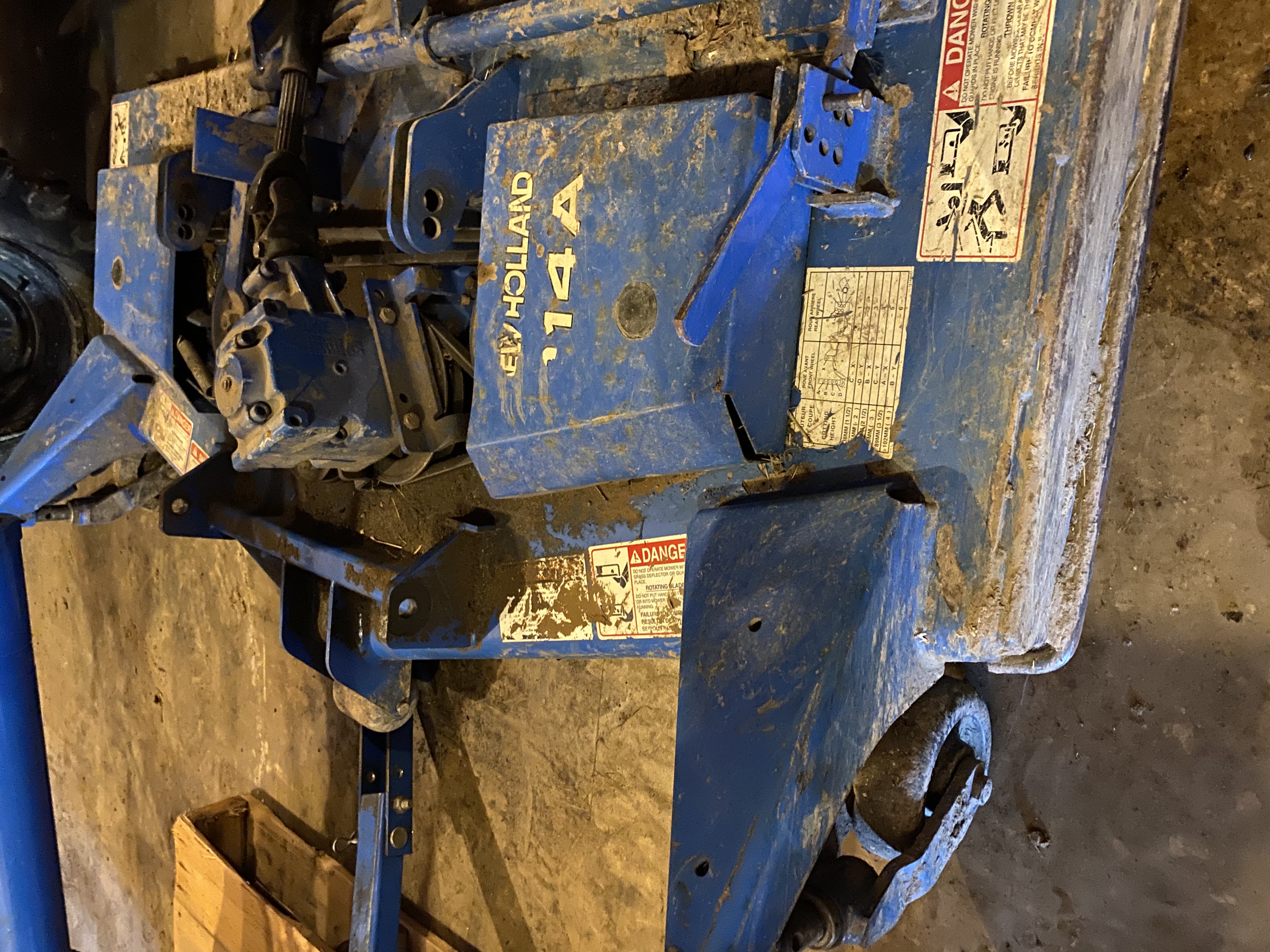

2004 New Holland TC24DA HST broke in half. Had 914A 60 MMM And 12LA FEL. 870 hours and she痴 all done! If anyone痴 looking for any parts or one of the attachments, let me know 😩😩😩

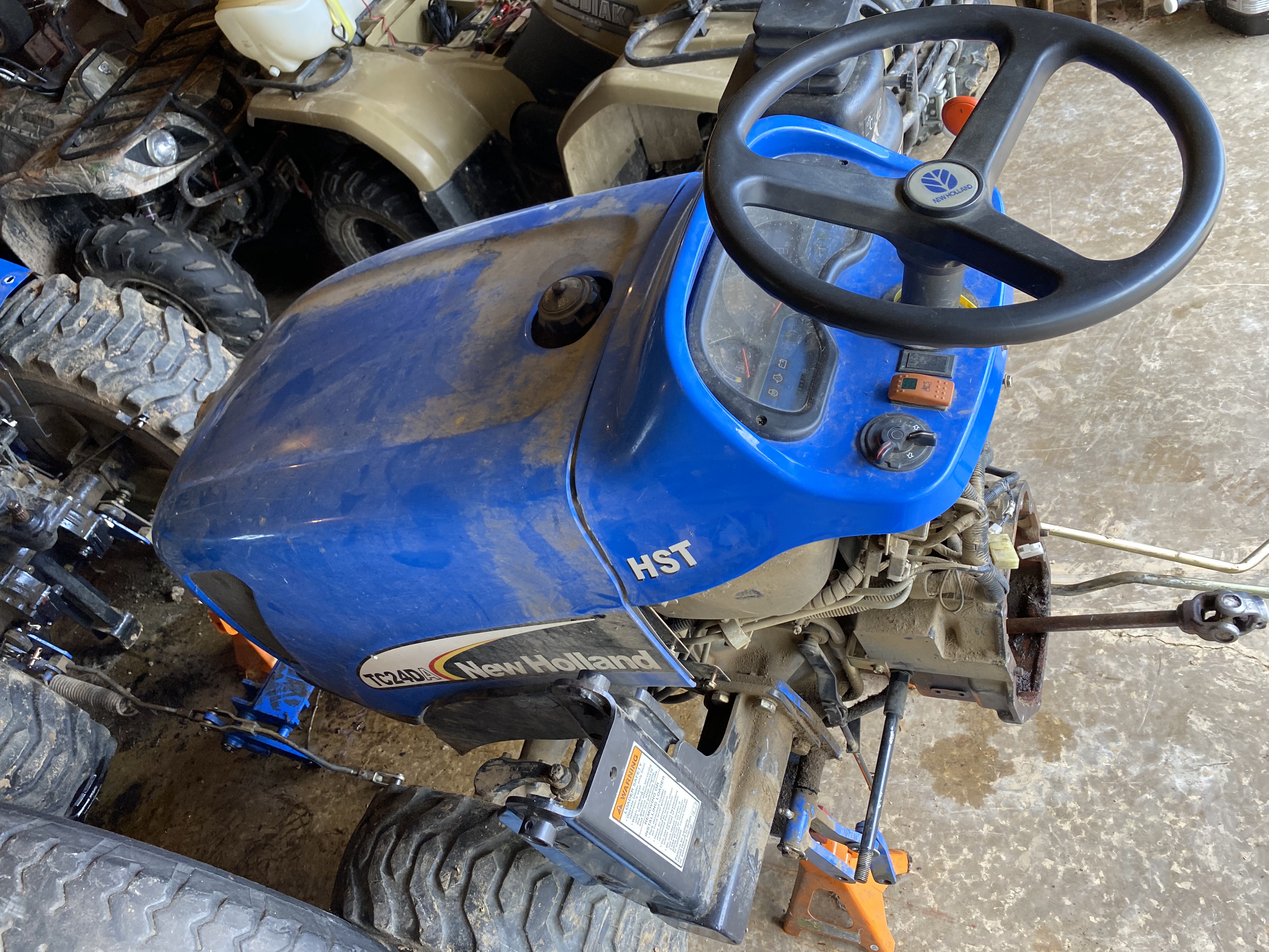

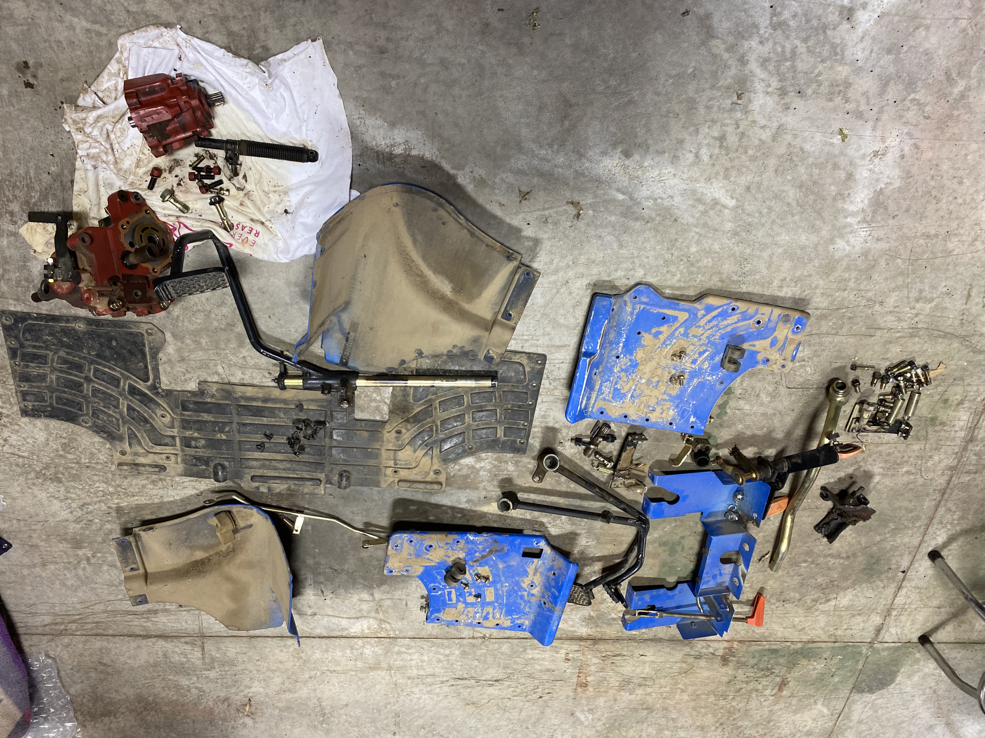

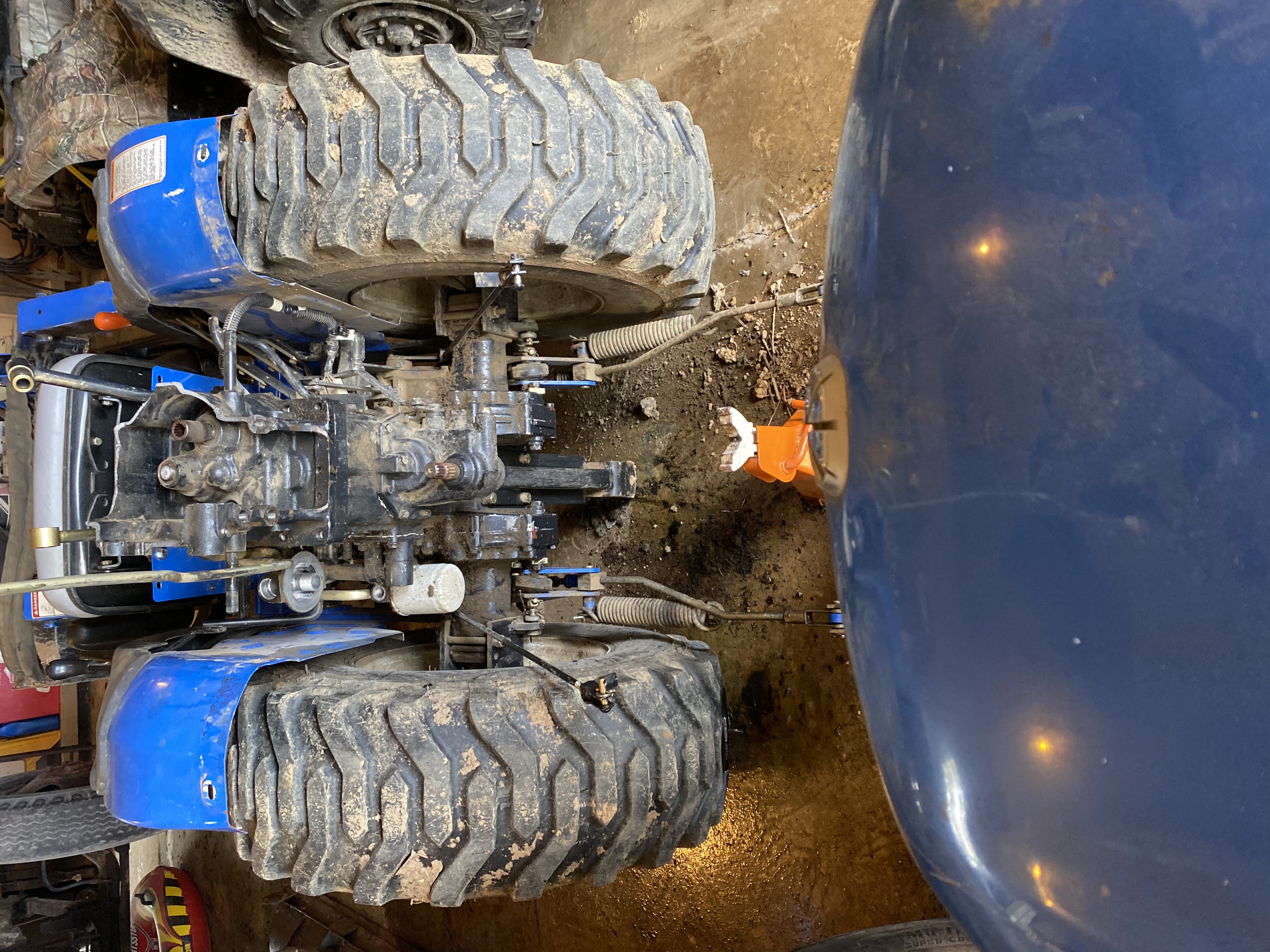

Ok, so after two years of this bad boy sitting in the garage, decided to order a new casting and get the two pieces back together. A couple weekends later, she’s back as she should be. Well, mostly. I’ve got it entirely back together, no leftover parts 😁. Charged the battery and added hydraulic/transmission fluid. She started right up. Ok, check the three point, good there. Turn the steering wheel back and forth, comes back to life as expected. Check the rear and mid mount PTOs, yep all working like they should except the rear continues to spin at a very slow speed when I push the clutch in. Ok so maybe it needs a little adjusting. Go to check the hystat to move forward and nothing. Same in reverse. Tried swapping the brake pedal safety switch wiring on both sides. Tried every combination, still no luck. No fluid leaks anywhere. This tractor has the valve for FEL, end though I don’t have it mounted, it lugs the engine when I move the joystick, but I think the hydraulic pump is mounted on the side of the engine. Unfortunately, it just doesn't seem to want to do anything when I push the pedal. And no, I didn't just forget to hook the linkage up to the pedal or the pump! So...I'm not exactly sure what to try next? Literally, everything on the tractor works as it should except the forward/reverse drive. Quite frustrating...
