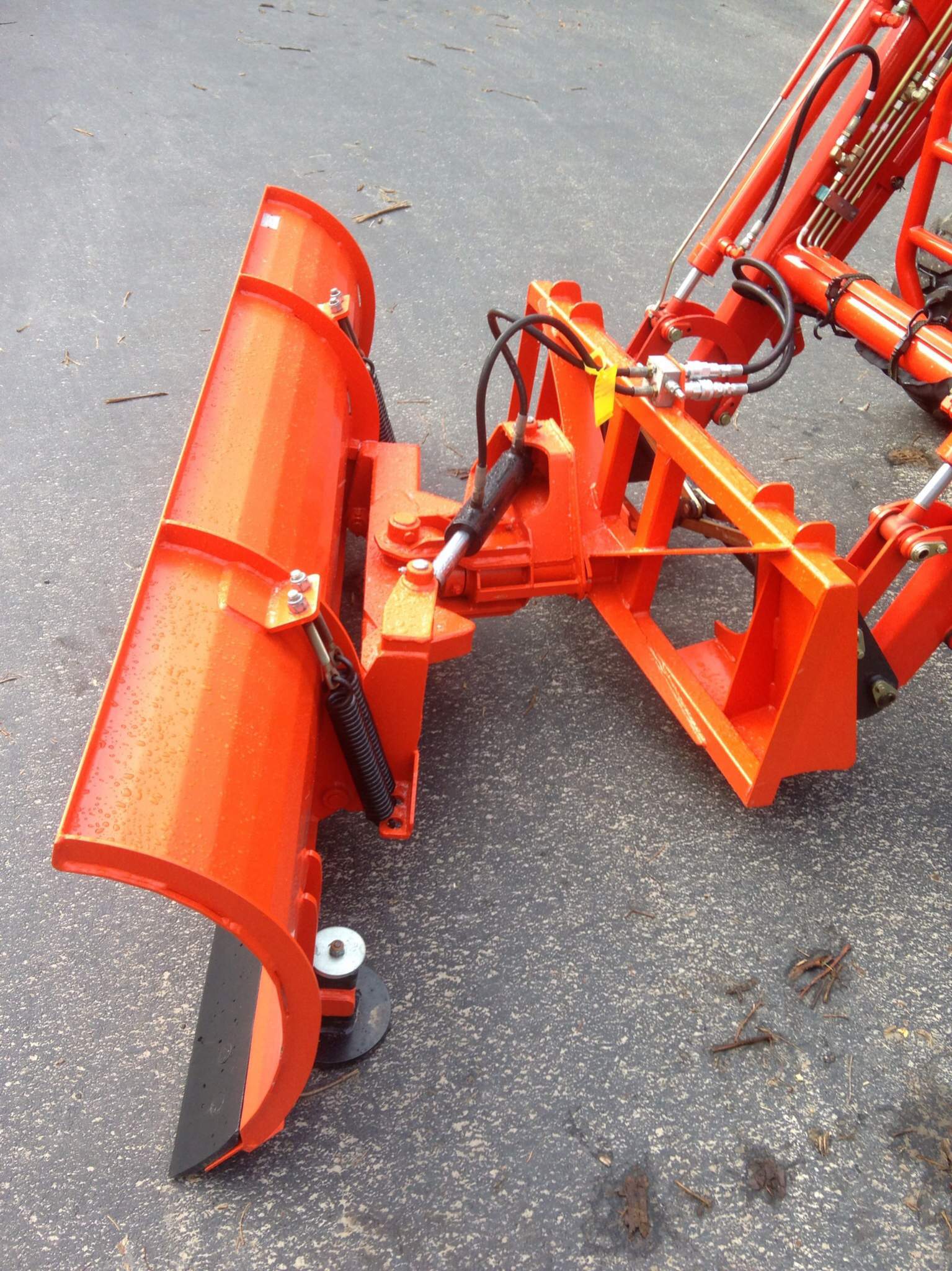

The 2000 is a much more substantial blade and well worth the extra cost, the price he quoted you for the 2000 is really good. I think I paid $400 more. Relief valve can save the day and the blade has lateral float, a feature IMHO is paramount for a snow blade. I sold my 2000 and bought a 3000 when I bought my bigger tractor. That is a great blade. Here is a picture on my Kioti.

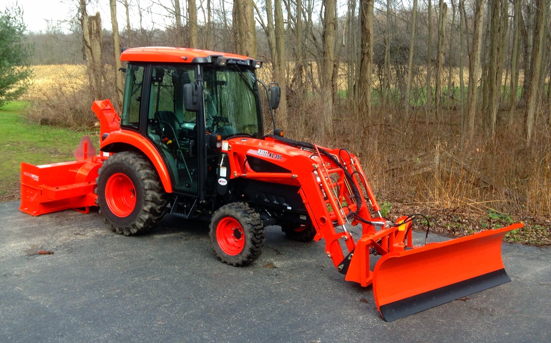

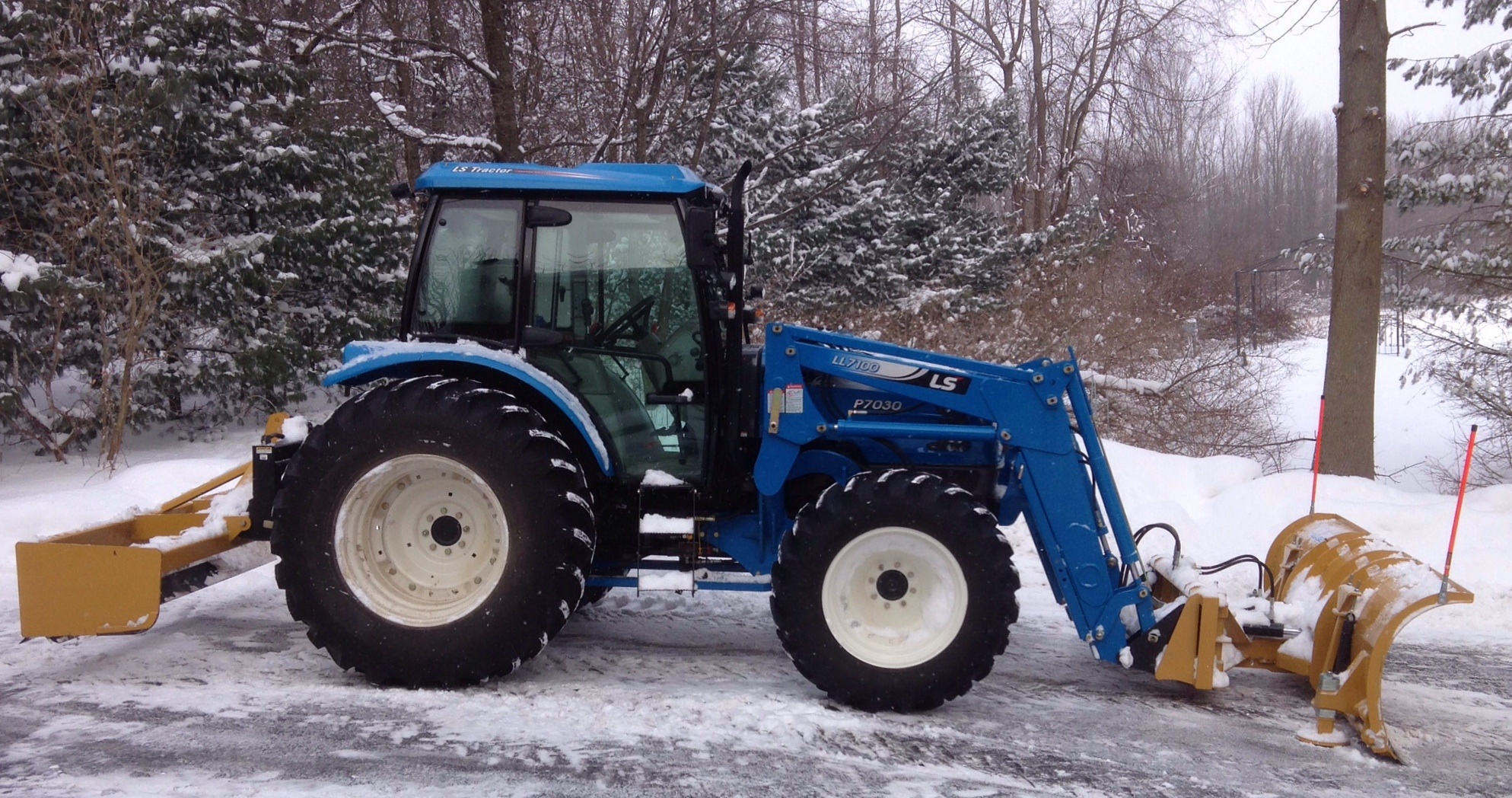

Whew, that's a relief! Get the 2000, you will love it. I had the DK35 cab, HLA plow and blower. Here's what it looked like.
This is what I use now:

Last bit of advice. You will use the plow much more often than the blower. It's faster and when the piles get big you can easily push them back by just raising your FEL. Blowing snow with an open station tractor is a royal PITA! The snow ALWAYS goes down your neck.
I would seriously consider the 2000 plow and a cab and forego the blower. I bet the difference in a payment wouldn't be that great and you would be much happier, I guarantee it!
With a cab, you look forward to the snow. Big storm? Yippee! I can go out twice! I have a driveway that is over 1/4 mile long but with heat and stereo it's almost fun. Not so much with a blower and open station.
Good luck!
