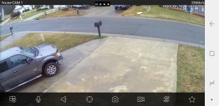

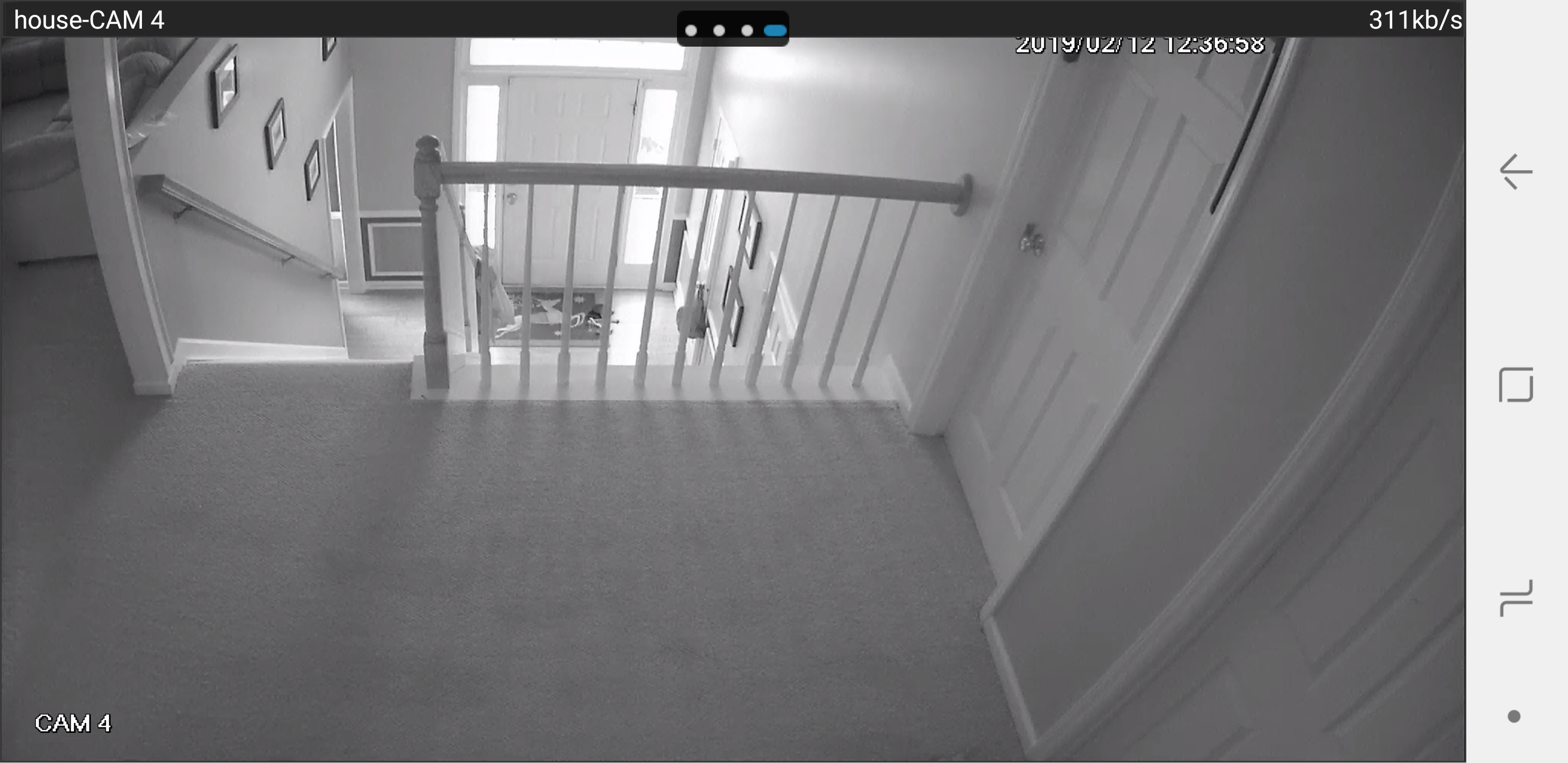

These are off my phone app, but typical for what to expect for 1080p camera. Note the interior one, it's in night mode with no interior house lighting & overcast day outside - without color night vision, you'll be B&W a lot indoors without a lot of light. But in case you're trying to decide on image quality needed a basic system (not junk, not top of the line) does this on BNC cables.

2.0 MP cameras, 3.6mm lens - a little narrower field of view than a 2.8mm lens.

It seems nice....until something happens. Getting a useable ID, someone has to be pretty close to the camera. A car on the street in 1st pic, will get color, make, model pretty well in daytime - possibly fair description of driver depending on sun angle. Probably not a good plate ID. At night....not a useful picture really. My camera placement sucks (that one is to watch our cars in driveway, but a different one covers street), but you get the idea.
Pitfall of a novice and DIY install...again if doing over, I'd put a lot more thought into camera placement, aiming, etc.
But that's what mine is - 4 camera. More would be nice I guess, but 4 is sufficient. I would like 2 higher resolution cameras, narrower field of vision, color night vision, mounted lower to really cover front & back entry very well. what I have would be fine everywhere else. For an inexpensive "everything you need is in the box" system, it's good for what it is, install was easy to figure out, and everything - including phone app for remote viewing - "just worked" out of the box. Overall I like it, but some things I'll do different/better next time.
