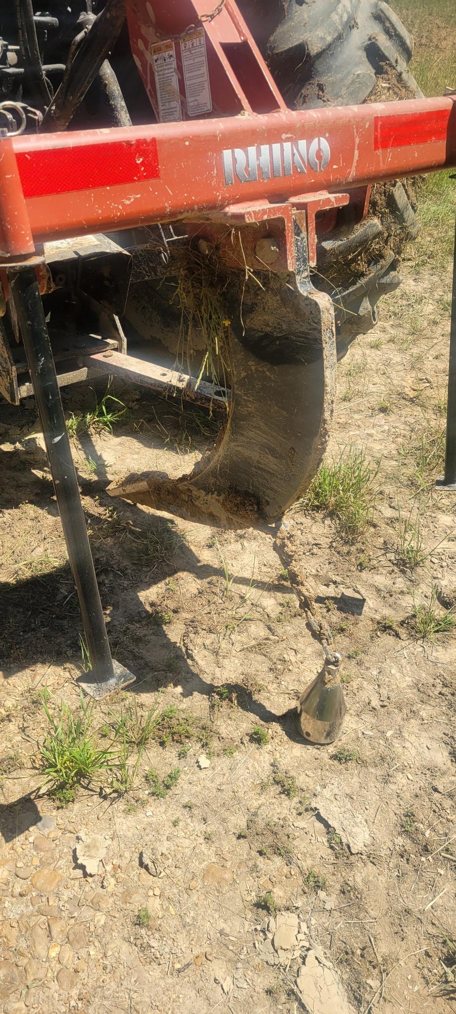

View attachment 804458The ground force is extreme in MI clay. See the picture below.
One of the reasons why I went overkill on mine. I saw a similar unit for sale locally, asking €300 (crazy price IMO), but it's just built to lightly unless they meant it should only be used in sand or something.
   / Homemade 2 shank subsoiler #42
That is, or let's say Was, a middlebuster or potatoe plow; not a subsoiler; and not really intended as a primary tillage impliment.

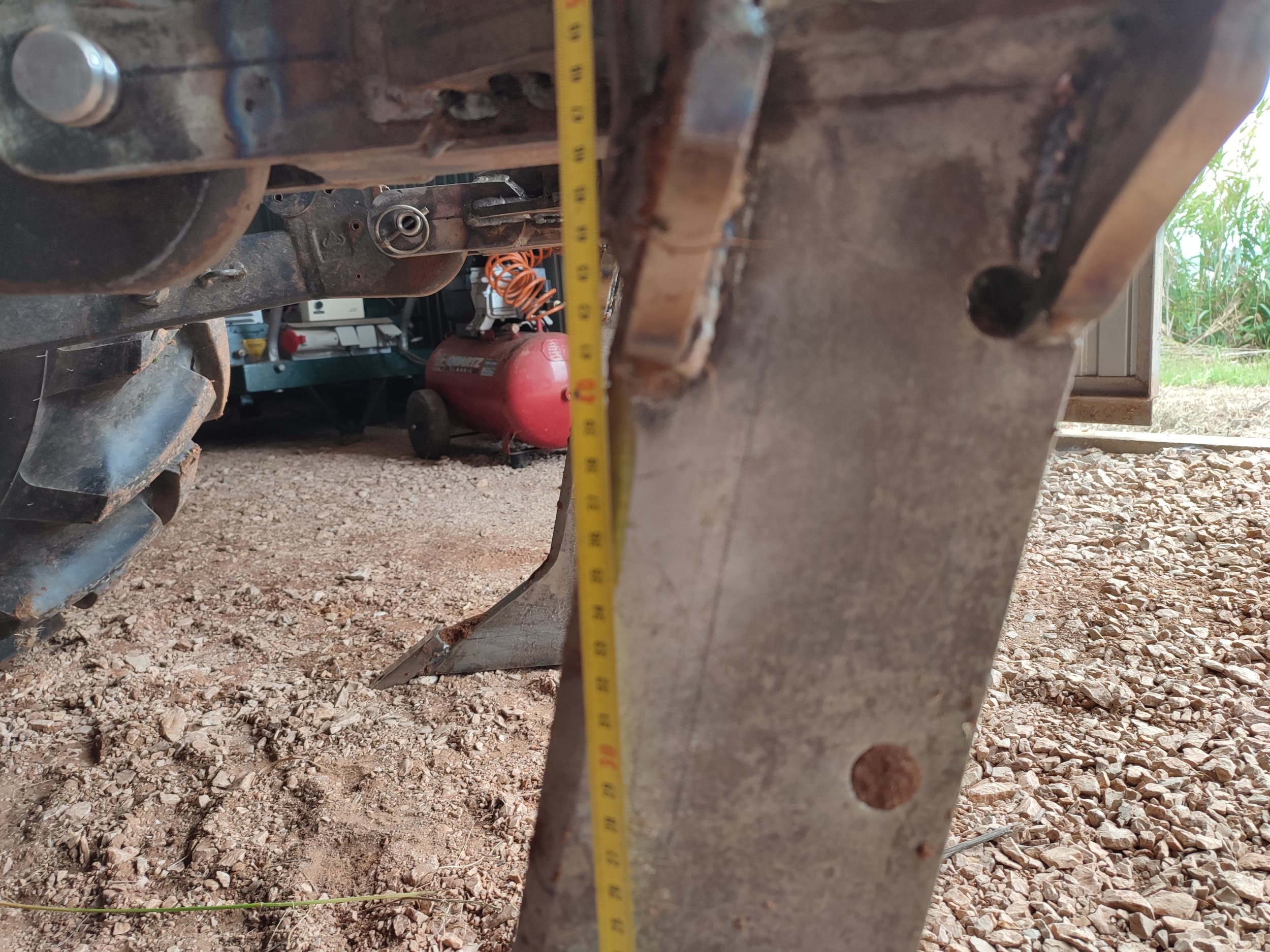

This more or less what I'm trying to achieve.
In this case, it's a Landini 2-55 with 50 HP, same weight and size as mine, pulling a 5 shank ripper about 11" to 13" deep.
Thats allmost the same as the 9 shank Jako cultivator we borrowed from the neighbour. It took all 55 hp of our Zetor 5245 to bury it to the frame. Off course it weighs 3 times as much as this Landini which aids traction...
Given the tape measure he holds beside it, its barely putting the chisels under, so 20 to 24cm working depth (8 to 10")

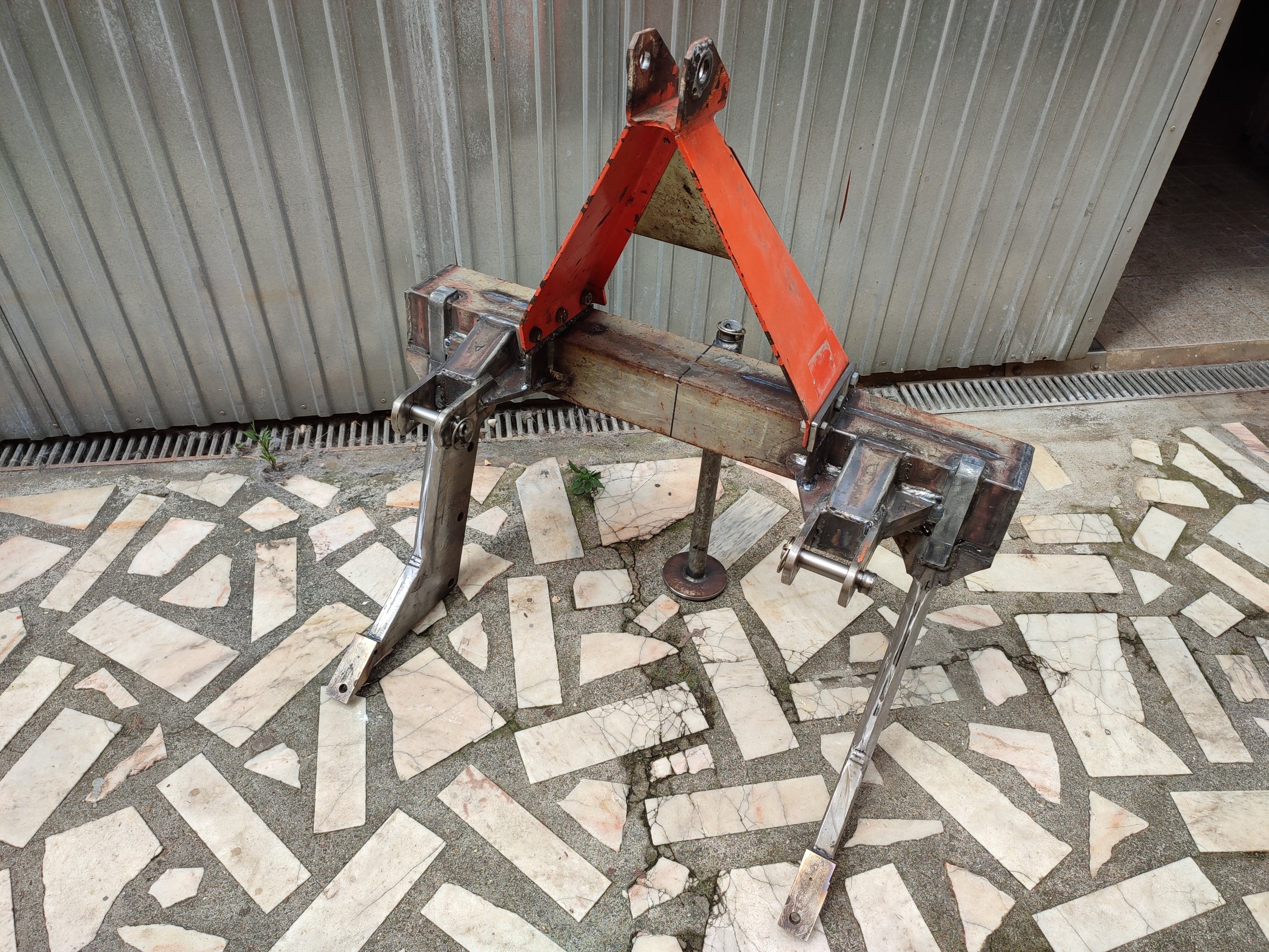

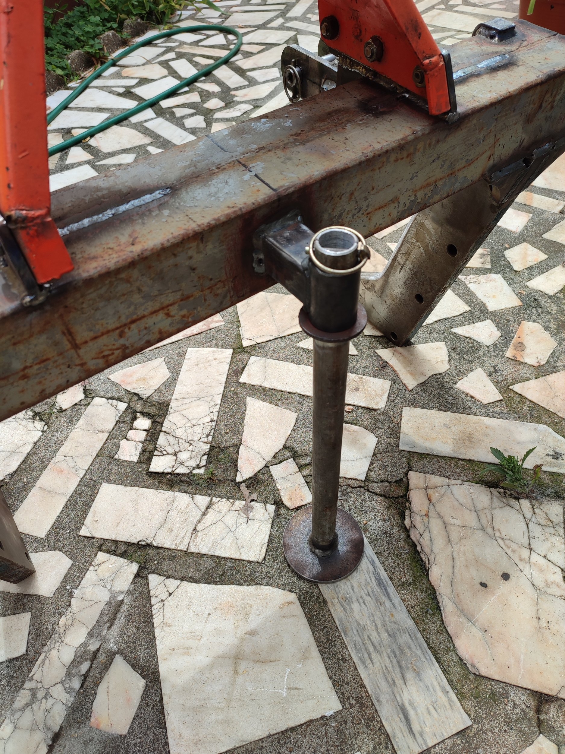

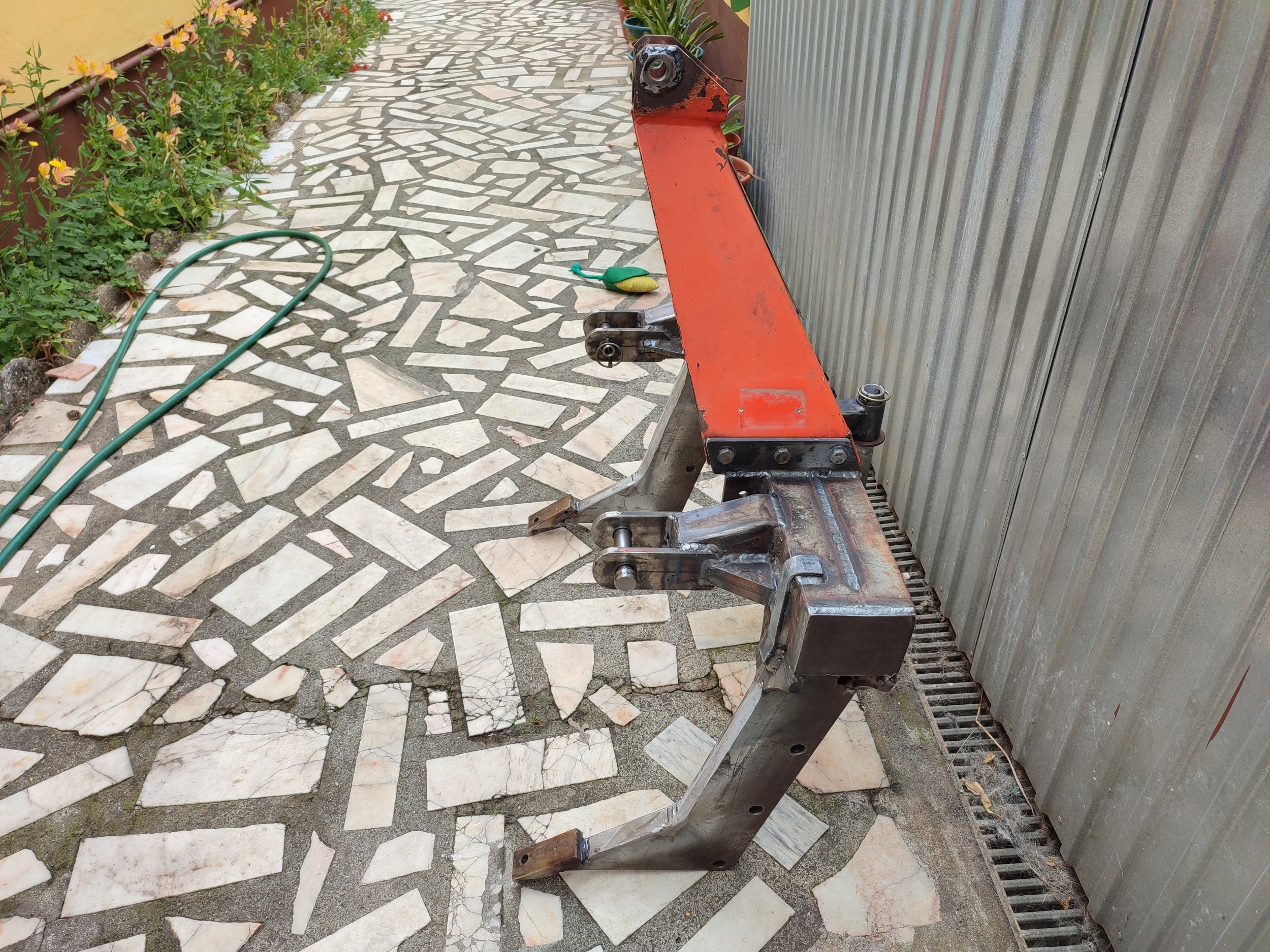

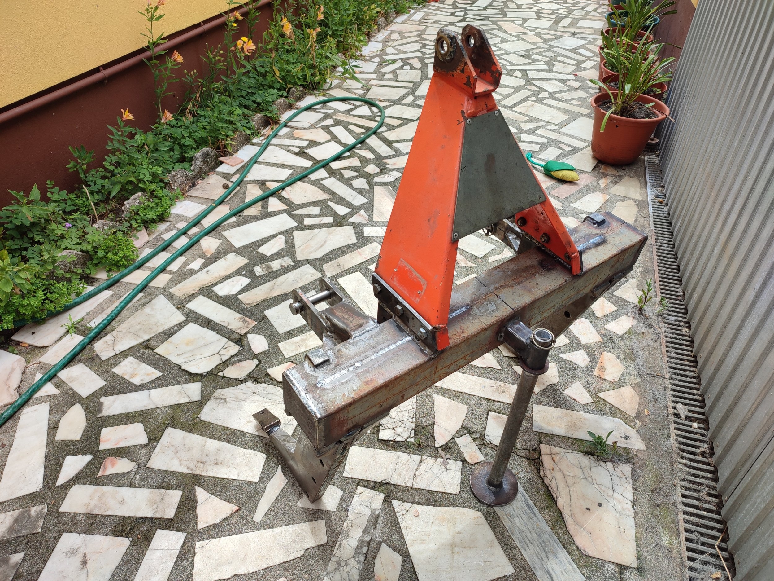

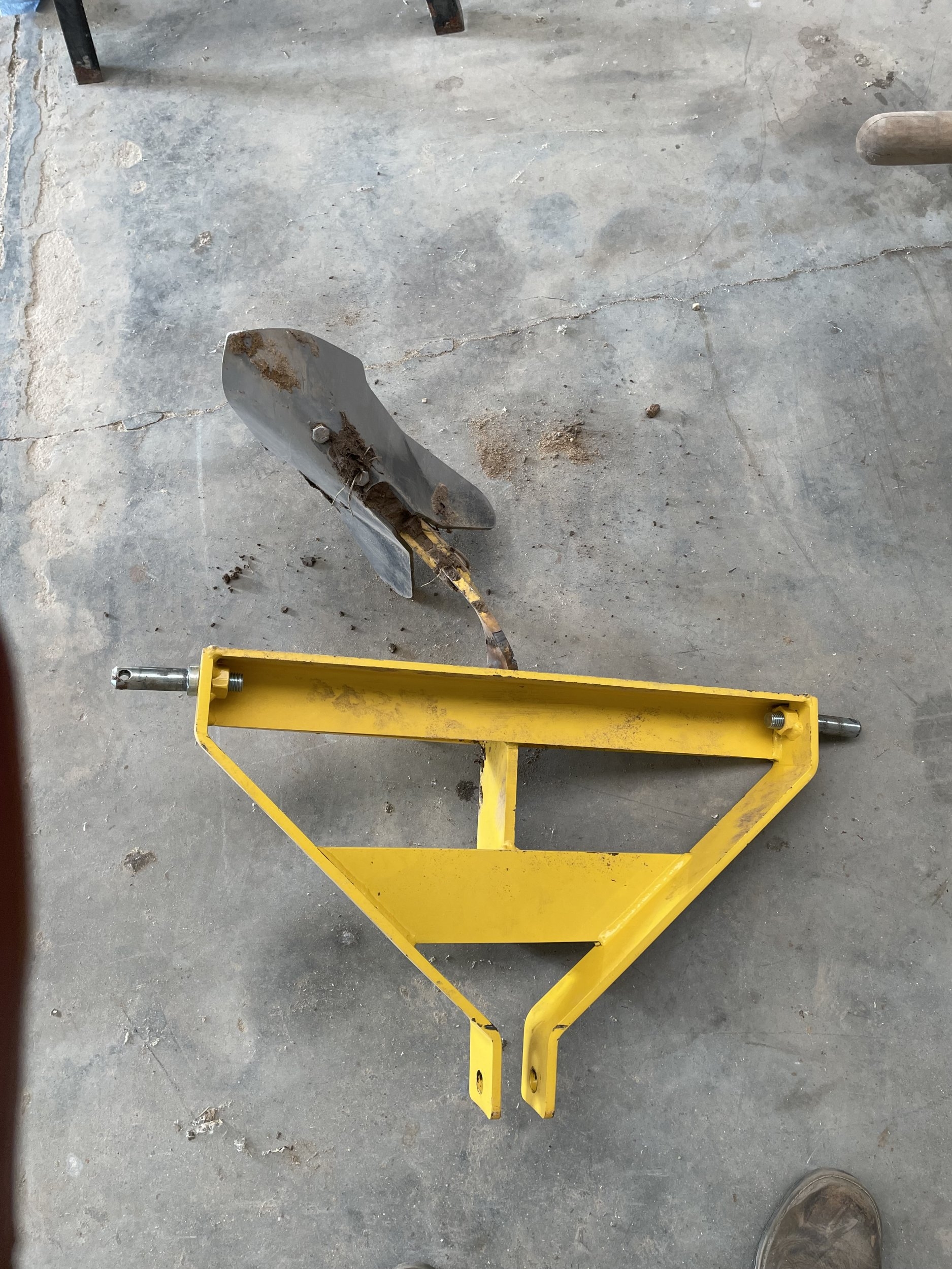

And it's done! Still subject to some minor changes after some testing but it's done. Specially the corner of the shanks. That will most likely come out.
Any bets on how long it will take for the support stand to turn into the 3rd shank? 😅
   / Homemade 2 shank subsoiler #45
Have you used it already ?
It pulls easiest if you make the 3rd leg staggered, which makes it easier to compress the soil sideways inbetween the shanks.
We used to borrow a grassland subsoiler with a disk coulter in front, and a foot wide steel roller behind each leg. It was a two leg machine and we used to overlap 50% to achieve staggered tines: The coulter and roller of the center leg were missing so the owner. disassembled the center (3rd) tine.
My guesstimate is that your tractor, on radials, at slightly less than half the weight of ours, will pull 3 legs just fine where ours pulled 9 on light soil. The rear row of tines have half the resistance of the front row so effectively we were pulling a 7 tine (5 in the front row breaking up full field, 4 in the rear row running in mostly broken up soil because of the too narrow tine spacing to bust the soil to the same 10 to 12" as the moldboard plough)

Haven't tested it. Tomorrow if the weather allows. I was joking about the 3rd shank as I'll most likely forget to take the stand off.
My tractor without the loader on, is around 1650 KGs, give or take 50 KGs. I don't have radials though. Definitely something I would go with if I were to buy a tractor today.

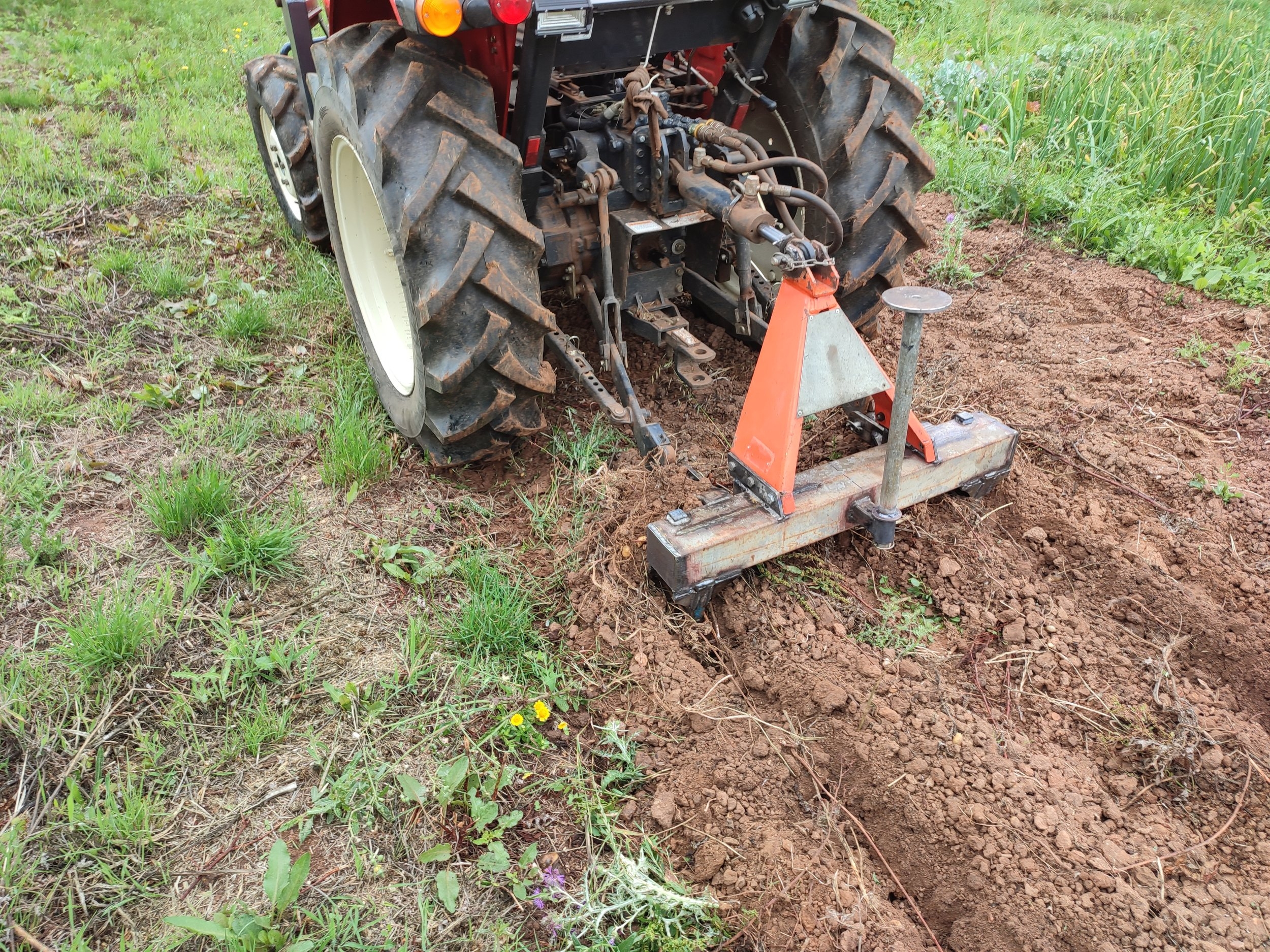

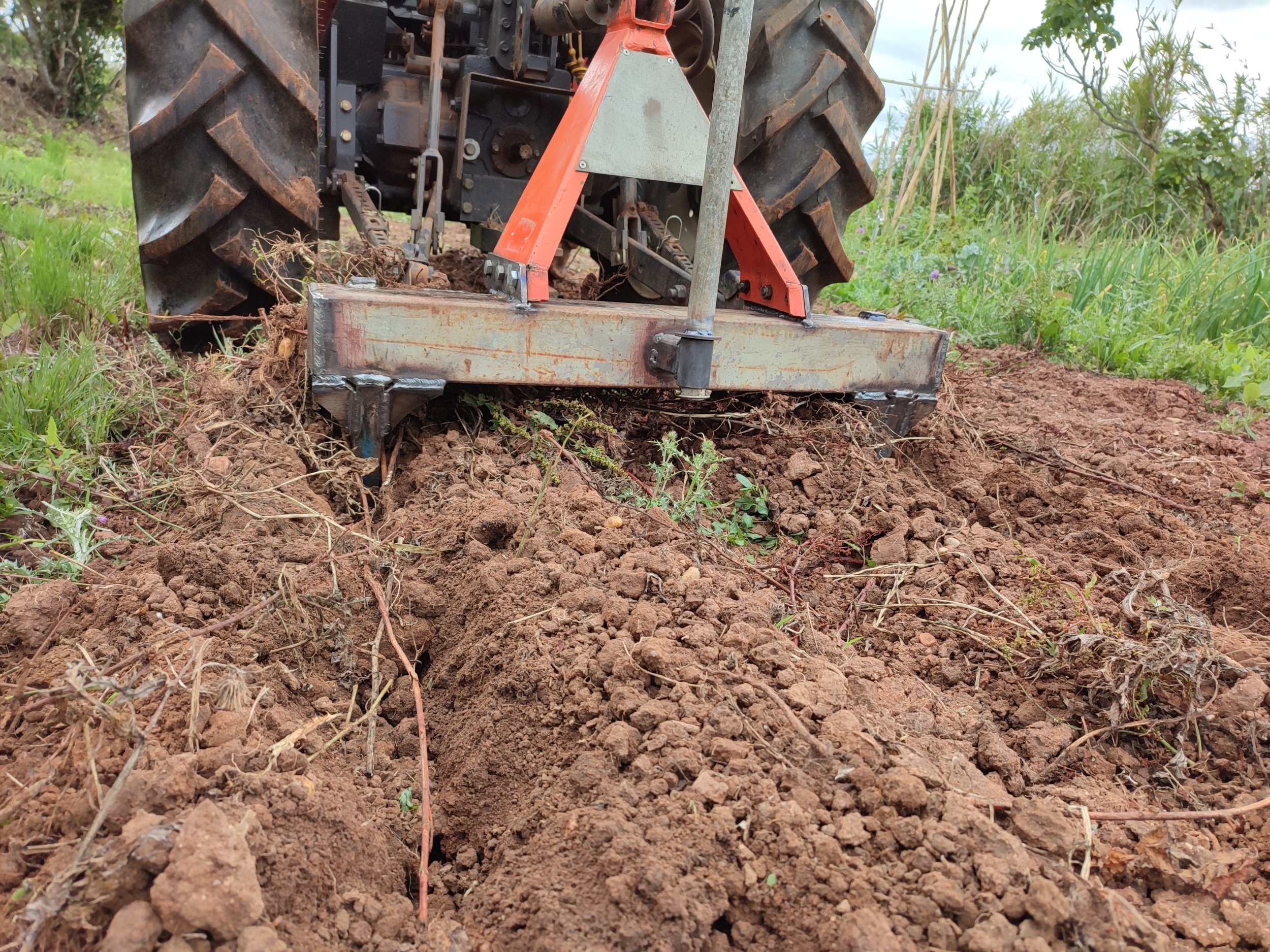

Say what? :)
First pass ever. 40cm deep up to the gussets.
Tractor had no issues other than some hard spots here and there that required me lift the 3 pt an inch or so.
More to follow.
