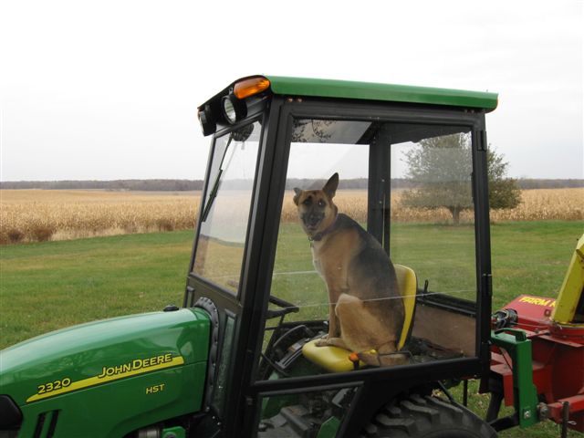

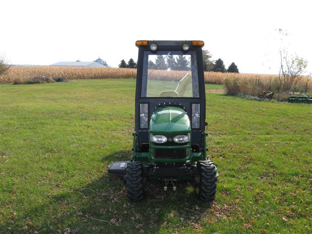

Well, Other than a few odds and ends to cover up gaps along fenders and things to block the wind, the cab's just about done. The snowblower chute rotator is redone to be electric and works well.
The cab is louder than without, which I expected. I'll probably use earplugs/muffs whenever I need to run wide-open with it. Not all bad, I can use the earmuffs with the radio built in, no need to install one in the cab that way. The door latch now holds, had to do some "tweaking" on the striker plate on the cab frame so it had some bite to it.

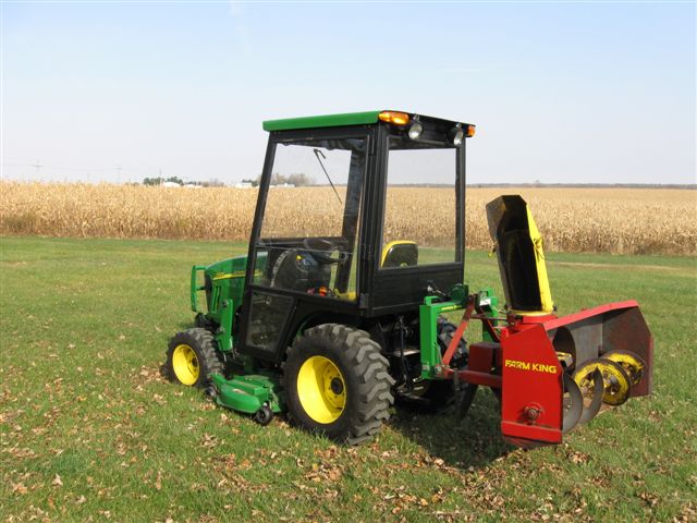

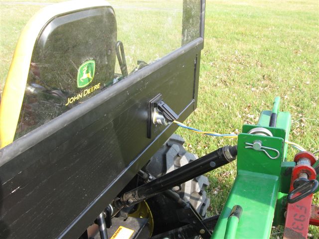

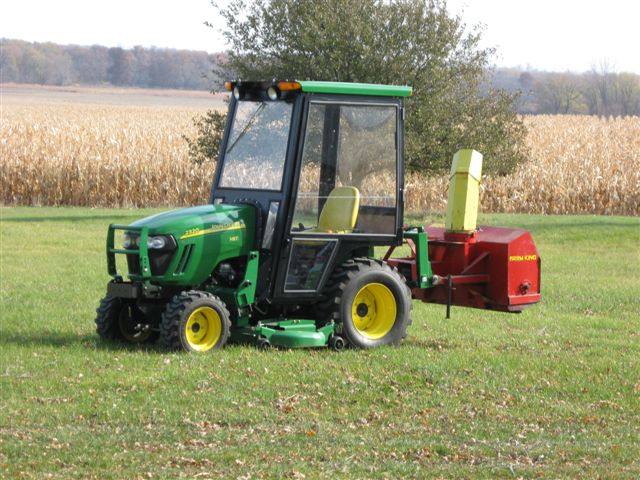

A couple more pics:

You have done a very professional job that looks great. I cant remember if you spoke about it before but are you going to add some kind of heater so the windows dont fog up while blowing snow? Also did you think about adding a rear window wiper? I use my rear wiper more than the front when blowing snow. Also glad quality control passed the final product:D
   / Homemade Cab for Deere 2320 CUT #119
Nice job , nice cab Only ? I have is do the doors flex when going over uneven ground ? It seems like a lot of area in the doors and plexy glass being flexable. V
#120
I haven't really noticed the flexing in the plexiglass when using it. I know it does flex, but it's at least not distracting. The weekend I got the RH "glass" in, we had a day with nasty winds all day. I had to move the tractor to do something else in the shop and was a little nervous about that much wind load on the big window. But, it didn't seem to bother it much at all. I think the "bend" in the cab helps some, that split in the windows siliconed back together gives it a little more stiffness than 1 completely flat piece.
The door itself is a bit on the flexy side though. The low mounted latch didn't help that much, but that was the easiest place to fit it in as things developed. If you hit a big hole or something, you can see the top of the door frame flex away from the cab frame a bit. Nothing rattles because of the weatherstripping, so that's good. A latch closer to halfway up would've helped that problem a lot...
