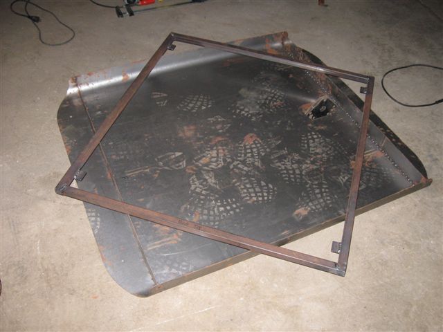

Unfortunately, today wasn't one of those days. Yesterday afternoon I got a little time out in the shop. I finished welding up the LH fender piece for the frame, drilled all the attaching holes and bolted it in. I then turned to the roof again. I cut 4 pieces of 1x1" square tubing, pretty lightweight stuff I had around. I clamped them to the top of the frame, lined up flush along the sides and set in by the thickness of the sheetmetal on the front and back. I used the frame as the jig since the sides and front are sloped. I tacked the tubes together and welded them up solid before pulling them loose from the clamps. The idea is that this would become the subframe that would attach the roof to the main framework, with the 1" perimeter providing a nice place for a seal of some sort...
Well, This morning I went out and used the angle grinder with a flap wheel to clean up the ends of the small tube frame and grind down the welds flush where needed. When I set the frame into the roof, it fit perfectly front-to-back. However, I noticed that when I centered up the rear tube in the roof shell, the front wasn't centered at all! :eek:
Turns out, the cab frame itself isn't square, not as square as I'd thought anyway. Using my digital level, I did a little investigating. The front frame appears to be leaning to the right a bit, maybe 0.25-0.4 degrees. Not good. That's throwing the top ot of square by a bunch. My guess is that the platform isn't as level as I'd assumed when I had the front frame resting on it. I don't remember checking level side-to-side when placing the front frame, mostly worked on centering it to the hood (it's still dead-on there) and getting both sides the same distance ahead of the rear frame (still there too)... Darn.
I'm pretty sure I can shim the front cab mount with washers/etc to level off the front frame and bring the top much, much closer to square. My main fear is that I'll have to rework the RH fender bar some. Near as I can tell, the front right may need 1/4" of shim. That may require trimming 1/4" off of the height of that fender bar. Would be easier if there wasn't that plate welded in the bottom end with the weld nut that anchors things... Not impossible, but a setback nonetheless. :mad:
Tomorrow after work I'll loosen things up and start shimming and see how things look. That should give me a better idea how much extra work I've made for myself...

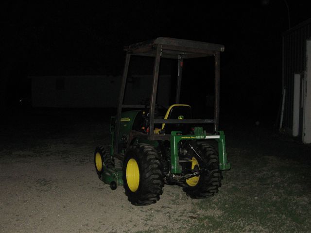

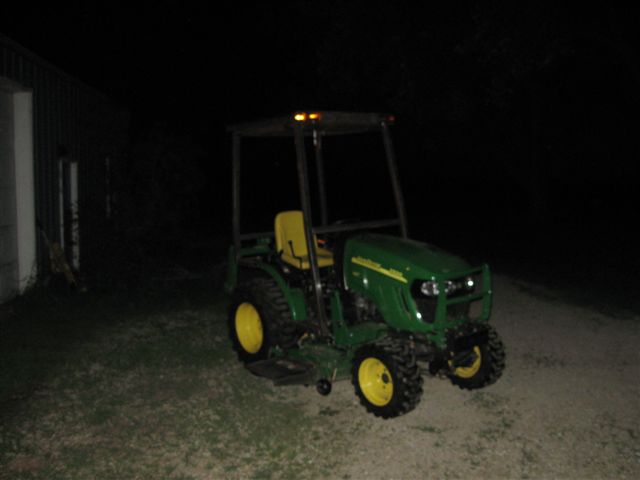

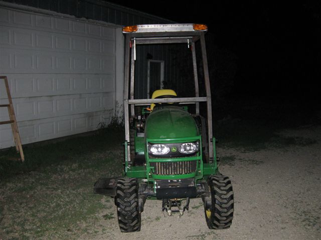

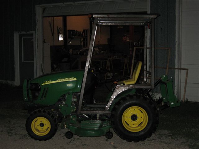

Got back on the cab project tonight. Started out by loosening up the 2 fender bars and the RH front mount bolt. Using the digital level, I added washers and shims to the RH mount until the front cross bars measured the same angle as the rear did. Took right at 3/8" total. I found 3 washers that stacked up to about that and bolted the RH corner back down with the washers in place. A quick check with the tape measure revealed that the top of the frame was now square.
Using the angle grinder I sliced through some of the corner welds on the roof frame to allow it to flex back to square. Some persuading, welding, and a session of me practically bending it over my knee, and the roof frame matched up to the now square cab.
The frame was then set back on the cab and 4 tabs made of 3/16" x 1" flat iron were welded to the side rails. The tabs recieved a 3/8" hole in each to provide 4 attaching points to bolt the roof to the cab. The roof frame was then tacked into the roof shell.
I just had to see it, so I heaved the roof up onto the cab and clamped it with a couple of wood clamps. I pulled the tractor outside to see how things looked. I only had a couple of the amber flasher attaching holes drilled, so I hung the front ones on to get a feel for how that'll look...
