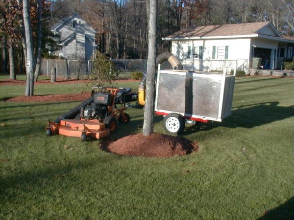

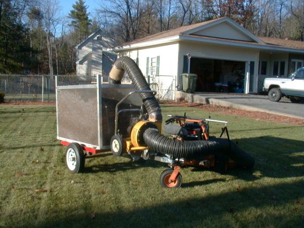

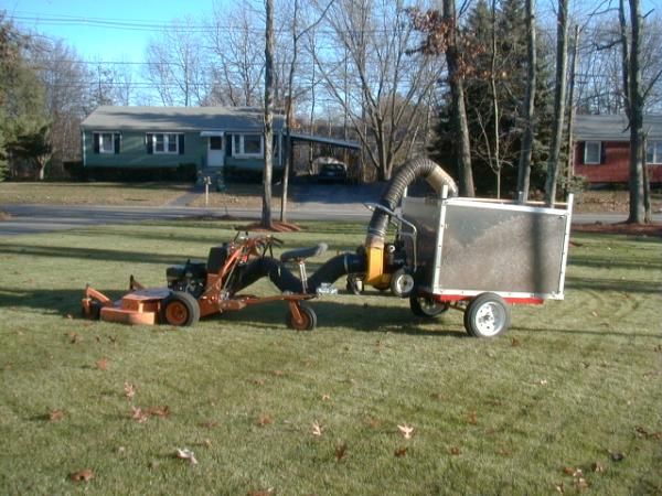

I really like the clear sides on the leaf vacuum.
Don
/ Homemade Leaf Vacuum #42
Very nice looking machine! Hope to see more pictures and a thorough description of the project! I would love to do something similar. My problem is finding the impeller for the vacuum.

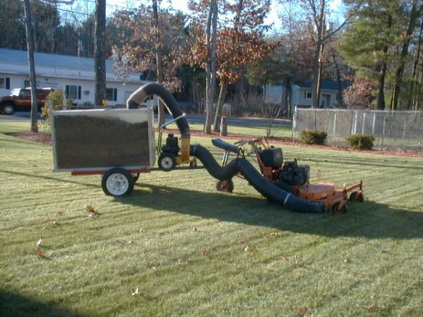

You can only leave so many chopped leaves.
With gator blades its fine to leave some, but 56 hardwood trees on 1 acre and most being oak, It's too much. In the fall I end up with about 20 cubic yards of MULCHED leaves. I figure the Gator blades and the Blowers impeller reduce to about 8 to 1 or better.

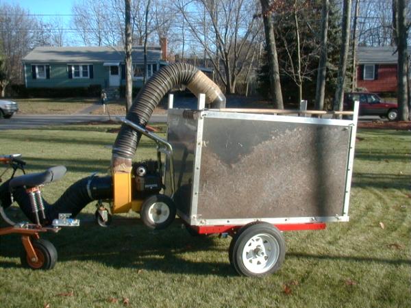

Where do you get the flex hose at?
Yes - where do you get that stuff?
I can lay my mitts on most everything else I need to cobble together my own leaf thrasher 'cepting the hose.

therrien: did you say lexan?? for the price of that stuff around here, we could probably buy a really nice leaf pickerupper....especially 9/16: but it doubt it would look as good or work as good as the one you built: great job.

I got a store brand AgFab 8hp vac/chipper It was discounted I think $1100 I pay normal $1300. I had it now over 8years. But the 6" flex hose is bad. I have look it up on ebay. It around $75 to $101 for the better hose. If anyone have a better ideal where to find it cheaper?
6" X 6' LEAF VAC/GRASS VAC/TRAC VAC VACUUM HOSE PVC - - eBay (item 110355627605 end time Jun-23-09 09:53:12 PDT)
Ya check out something like grizzly and get some dust collector hose.. I'm pretty sure it comes in 6" size. If it can tolerate chunks of wood it should work ok for leafs.

Of course - woodworking dust collector hose. Thanks, guys.
