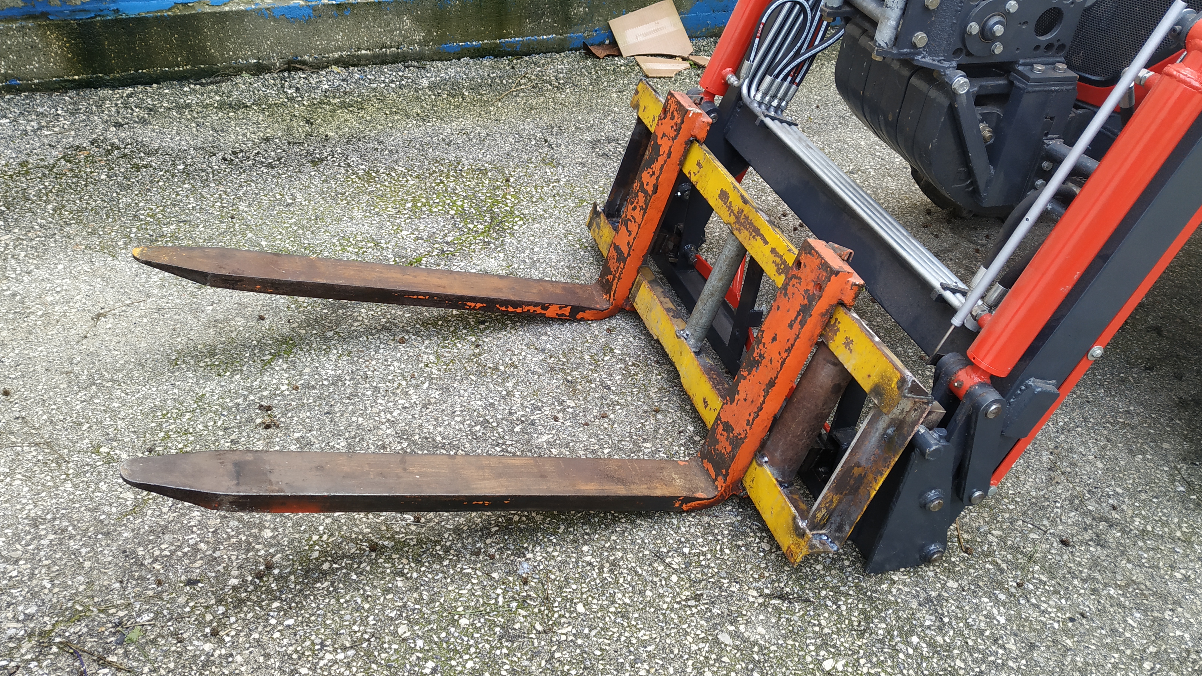

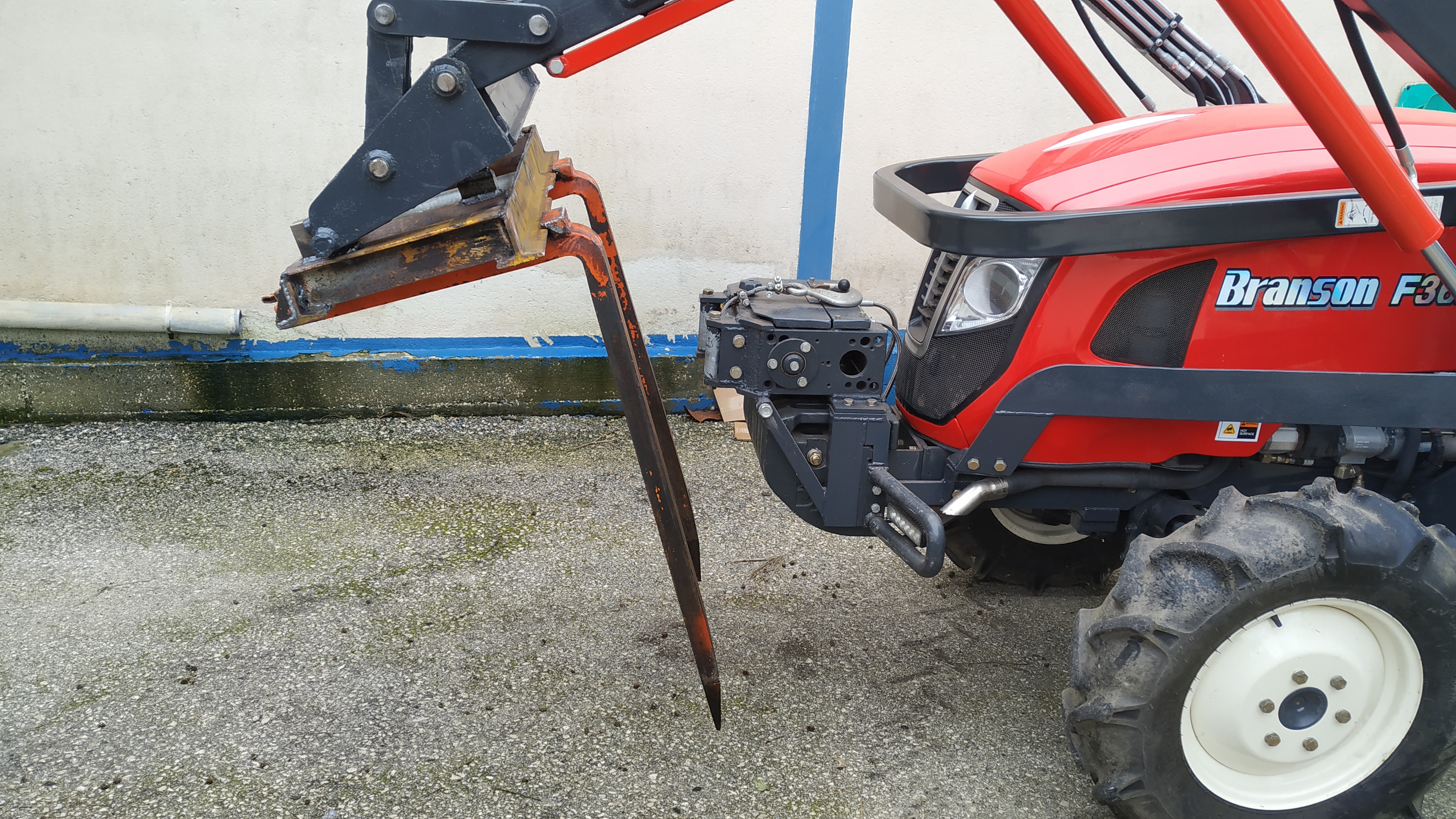

I made a cut out on the bottom rail so I can insert the forks in. I did weld a stop at both sides so the forks wouldn't accidentally slide out of the frame.
Regarding the lip holding the load, I think it will be ok. But if it starts bending, I do have some room to add a piece of flat bar to reinforce the lip.

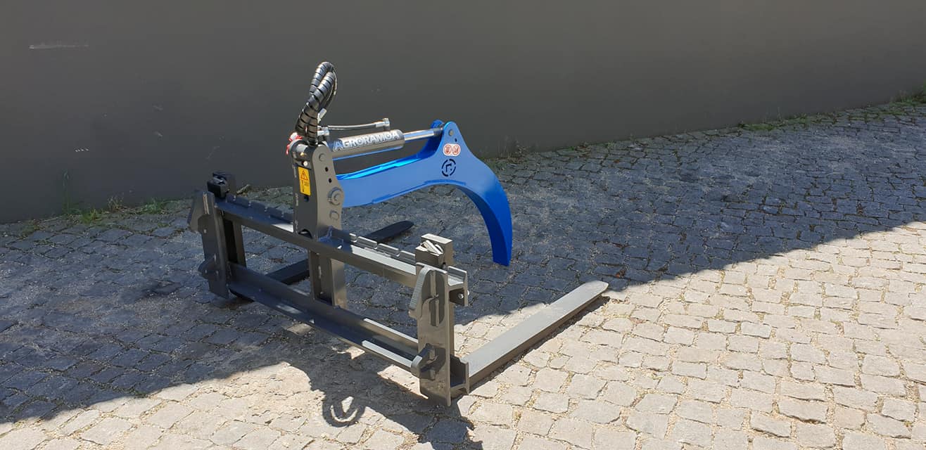

I used to run a similar setup on my previous tractor since I didn't have a quick attach for the bucket on that loader. I didn't really like them because I could see what I was stabbing with the forks.
I don't really do any logging but if I were to do, this is what I would do on this forks I'm fabricating:
60203338_2229690767126559_1900743961597706240_o.jpg66504713_2329974887098146_973200831488720896_o.jpg
This is a common setup here and I do have cylinders available to do that, at the moment I don't really have the use.

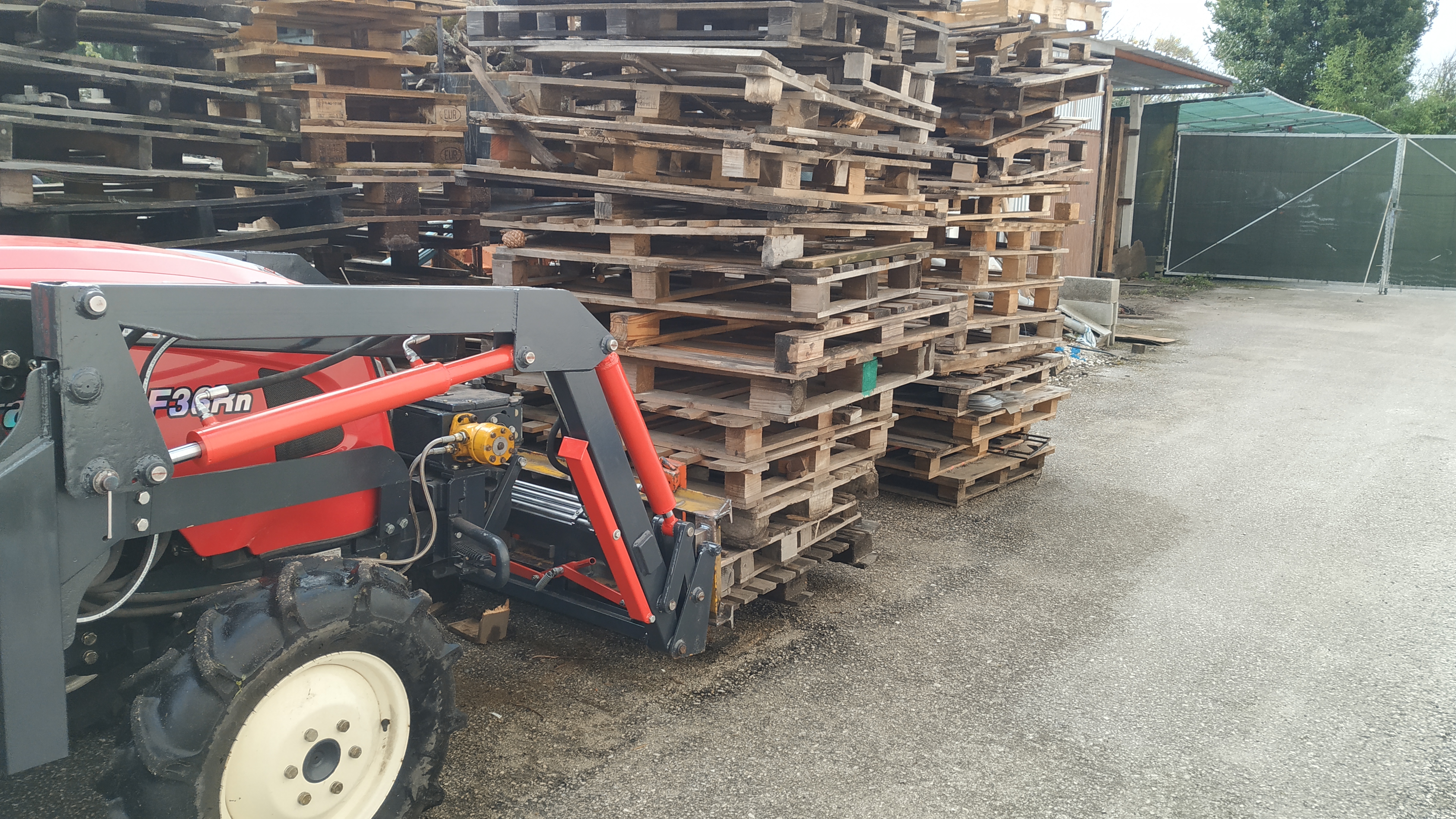

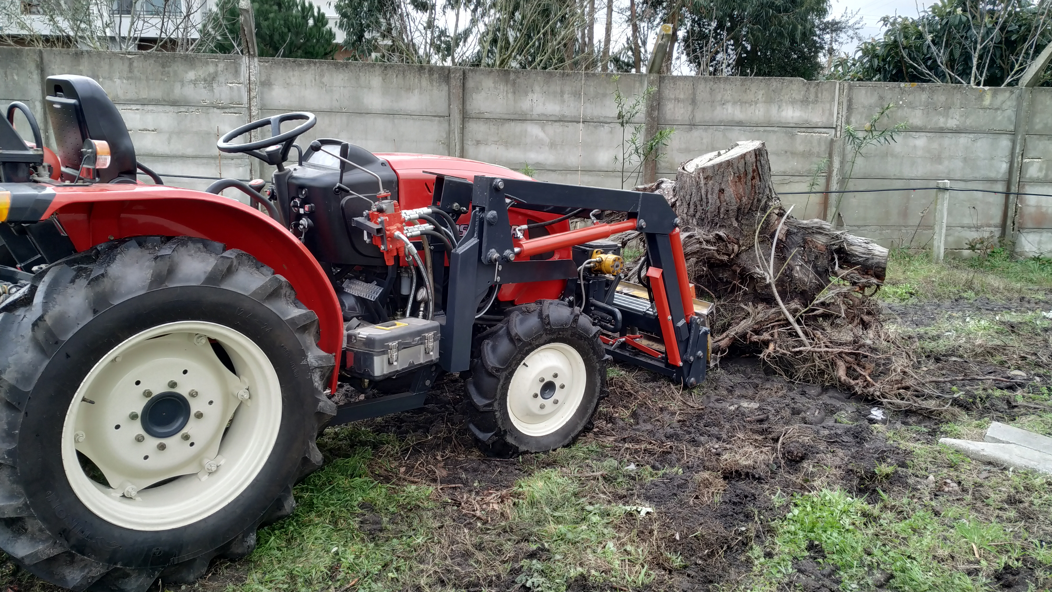

I moved a bunch of piles of wet pallets (mostly broken for firewood), a big and heavy stump and some other stuff with the freshly made set of forks for the tractor. Worked awesome and allowed me to put some actual load on the loader, tractor and forks. A full bucket of dirt just don't put enough load. It's was a nice test and lip didn't budge, so I don't think I will worry much with that.
I only had a 275 lbs carry all box in the back but it was empty. I've never found the tractor to be light on the rear or even trying to lift the rear. These Branson tractors are really heavy!
And of course, I had my assistant always supervising and making sure the forks are in the right place. :)

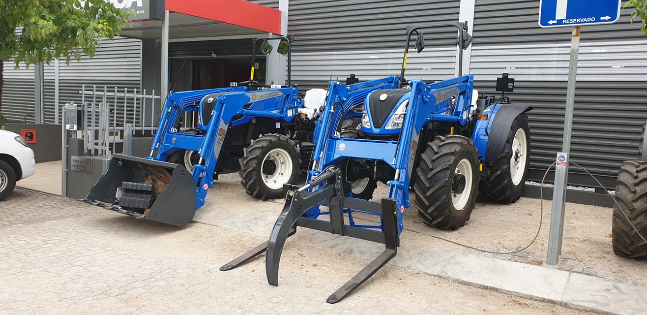

View attachment 633822View attachment 633823
Are those New Holland tractors or?
I see that they are using planetaries on the front axles.
Do you happen to know what models they are.
   / Homemade loader for Branson tractor
#97
Yes they are. Probably a specialty model for Europe.
I'm not fully into NH models but it looks like it is a T4 variant. The left looks like a T4F and the right one is a T4 LP. I don't know the HP though. Both are available from 75 HP to 110HP.

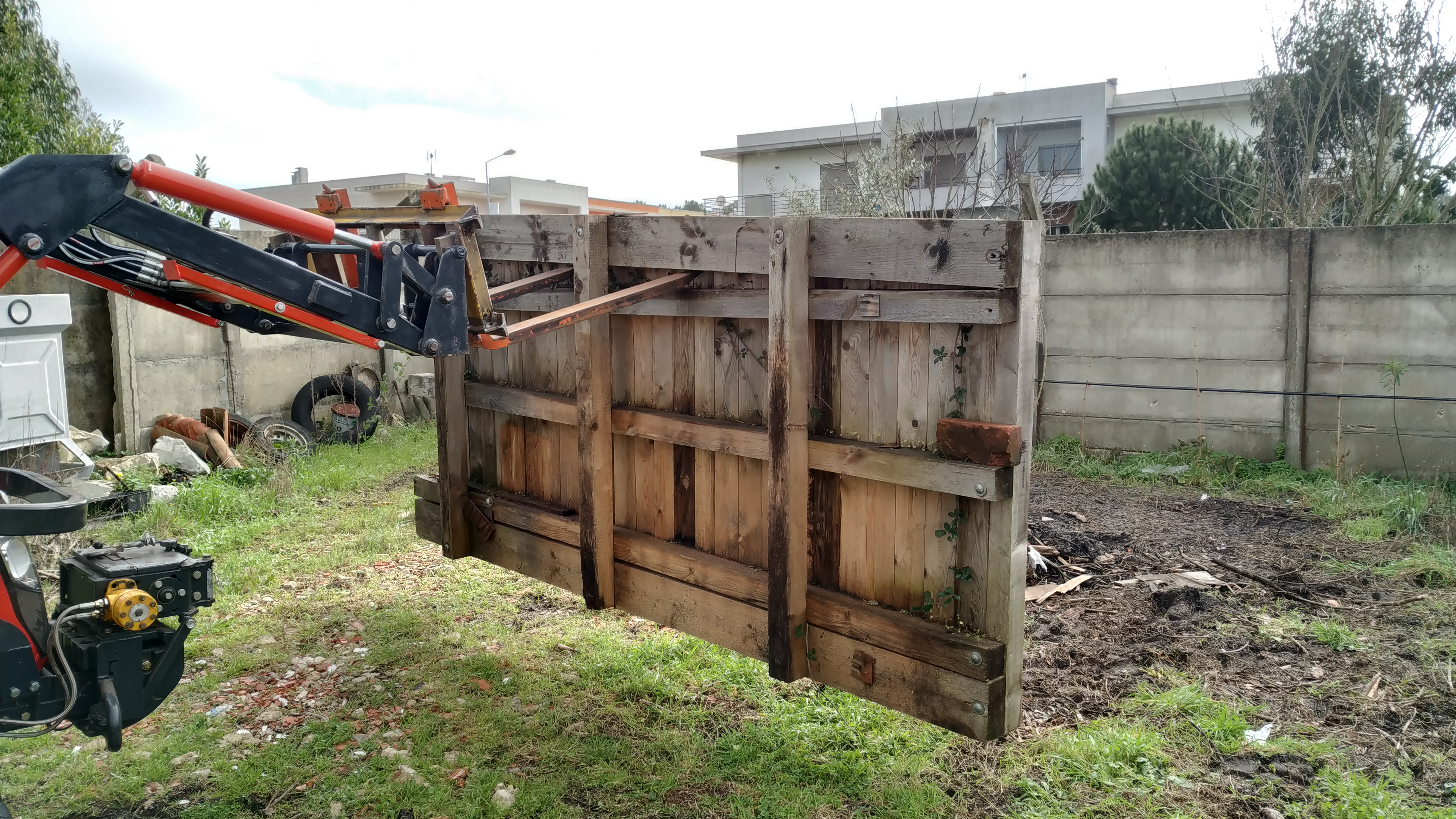

View attachment 633951 View attachment 633953
First picture is a illegal picture, when theres alot of weight on forks the forks must be at least 4' off ground and I dont know the mm measurement for that. On the next picture, that would be a lot better if the pallets fell down all over the place, like it does in my world..................
What's next sand blast and paint?
#100
You're absolutely right! I thought about that when I was posting the picture. I should have lifted the stump more for the picture but I try to lift stuff just enough to get it moving.
As far as the pallets... Let's just say that moving those piles didn't go as smoothly as it should :laughing: It was just one stubborn piles that decided to fall all over the place.
