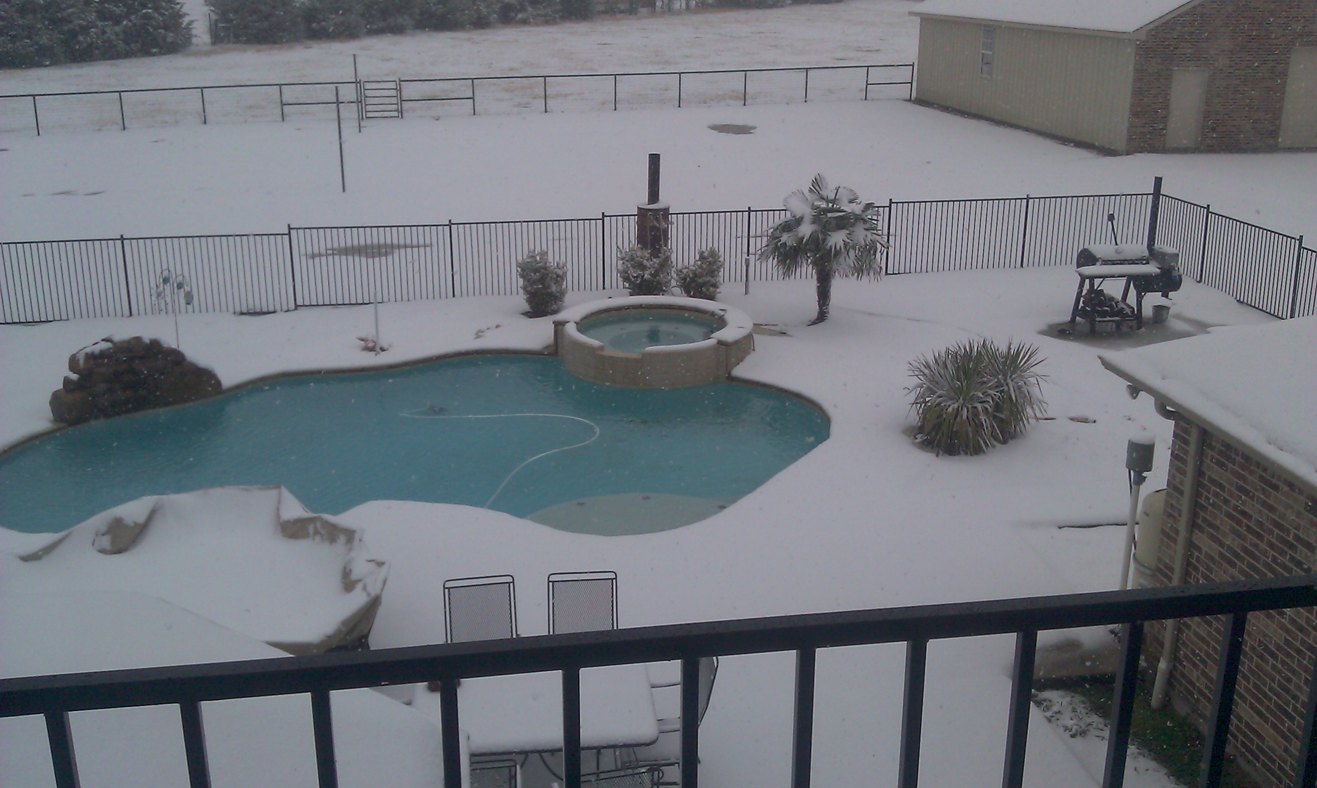

Well i have an electric pool heater, it heats it very well, the water is between 86 and 90 degrees.......but yes it's electric........so the bill is a little higher but then again without it, no swim, too cold of a summer, at least we can swim when we want! But I do want to add the roof top pvc coil pipe with a pump to see if it makes a difference..

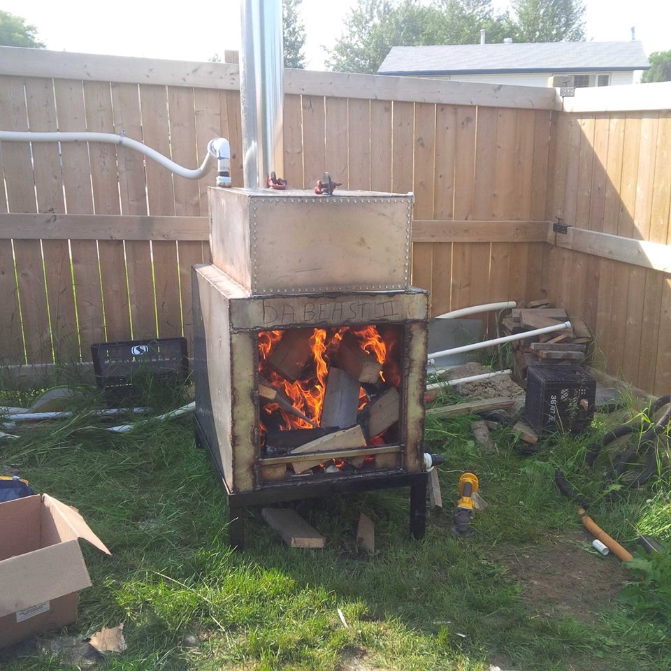

I can't take all the credit for this, my wife saw this design being used for heating a hot tub.
In Alberta our pool is only up for a couple of months. Last year the pool did not warm up at all. The 19000 Liters stayed cold until we drained it.
This coil is made up of 100 feet of 1/2" copper tubing with hose ends attached. Hook it up to the pool with a utility pump, place the coil over a fire, the fire heats up the water in the coil and passes it back to the pool.
The water coming into the pool was about hot enough not to put your hand under it for very long.
It heated the pool in about 8 hours and it is staying warm.
Ivan

So far to warm it up it took about 8 hours of burning wood. I did modify it a little by placing it on a fit pit so it is closer to the flames.
It looses a couple of degrees per day, so every 3-4 days I turn it on.
As a side note, watch the hoses...my older kids were playing in the pool and accidently knocked the hose out of the pool. 3 hours later we found the hose watering the grass...we lost about 6" of water in the pool. We did not have a fire going, just using it to circulate the water (it still pumps in luke warm water just running through the hoses that are out in the sun).

It takes 400,000 BTU to raise the temperature of 5000 gallons of water 10F. In a perfect world, you would be getting all the heat out of the wood burnt(about 8000 BTU per LB). So for a 10F rise over 8 hours, that is about 50,000 BTU/HR or at 100% efficiency 6.25 pounds of wood per hour. this of course is not accounting for the losses in heat thru the pool walls and especially thru evaporation(probably the largest heat loss).
I don't think that heater shown is very efficient. It needs fins on the pipe to increase the surface area. It needs something to trap and slow the heat as it passes the tubes. It could also probably use something inside the pipe to cause turbulence and break up the laminar flow that occurs inside the pipe. This flow acts like water in a wetsuit and insulates the inner cool water in the flow from the heated surface. this slows heat transfer. The corrigated stainless gas pipe might work better for this as it has more surface area and a rough iner surface.. As already mentioned clorinated pool water and copper don't play well together.
