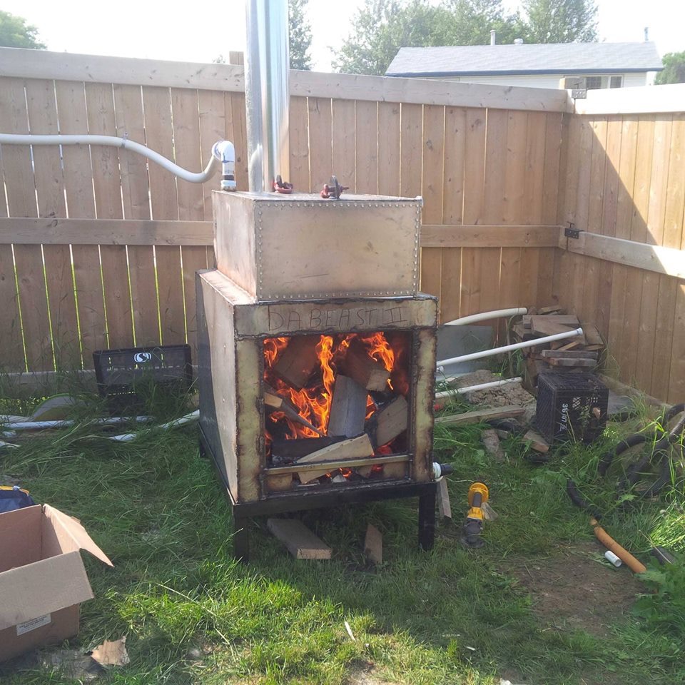

I'm working on a solar pool heater, not quite finished but it is functional at this point. Here is a pic of work in progress:
About 500ft of 1 in poly divided into 4 sections. Fed by the 11/2 inch pool plumbing hooked in after the sand filter. Driven by 48vdc pool pump directly hooked to solar panels via a controller so basically whenever the sun shines it flows. Not looking for a big temp increase, would be happy with just a few degrees above air temp. Our temps range mostly from 60's at night to 70's daytime. Yearly low last year was 58° and high was 83°. Pool is 39k gallons.
Have installed any thermometers yet but hope to be able to measure both in and out temps.

I have one similar to the op's but my coil is in a 3rd of a 55 gallon drum I cut and hinged off of the lower drum and added a stack. I don't use it for the entire pool but will heat up the hot tub just fine.

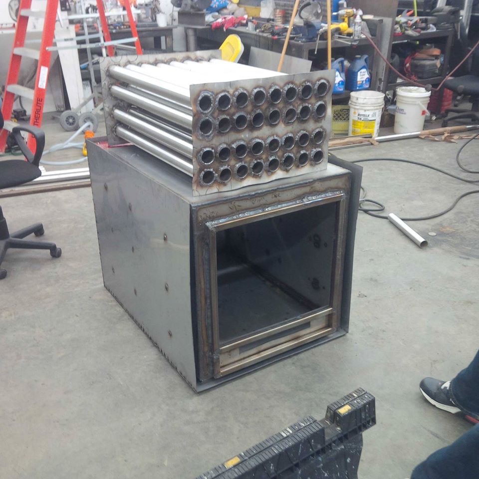

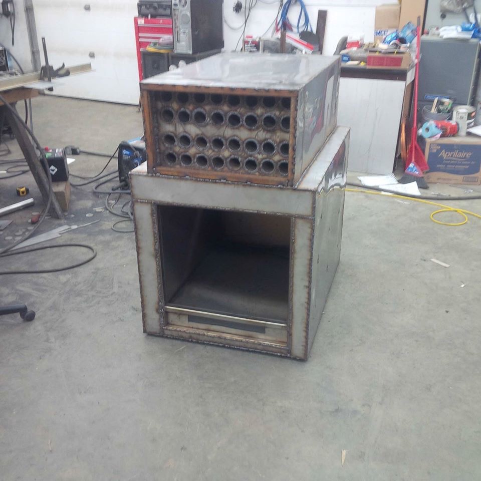

I built a pool heater a few years back, i have a 10000 gallon pool, it heats it from about 15 degrees C to 30 degrees in about 3-4 hours. Its all stainless with a 4 pass heat exchanger for flu gas.
