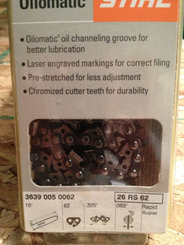

I have both my 24" and 18" bars now and both have the low kickback safety chains. I was wondering if anyone has modified their chains so they pluge cut better. I'm guessing those little guides in front of the cutting teeth are that make it a safety chain. If I'm off in left field and need to just repurchase my chains just say the word but wanted to avoid replacing brand new chains.
Thanks!

Yes guys cut the safety bumper down with a dremel or grinder type tool.

As far as modifying safety chains, assuming for a moment you haven't already used them, I'd suggest exchanging them for different chains, rather than trying to modify them. Plunge cutting is dangerous, which is why safety chains are less effective at it due to increased chance of kickback.
Unless you are a pro with proper training, reduced kickback chain is what you should be using.

I was using Stihl's green low kick back safety chain for several years. I decided it was time to get a few new chains so I stepped up to the yellow chain which is more aggressive. I was surprised at the difference. Cuts like butter... I have a 16" bar saw and 20" bar pro saw.
