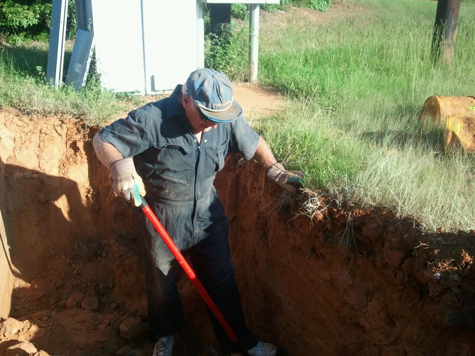

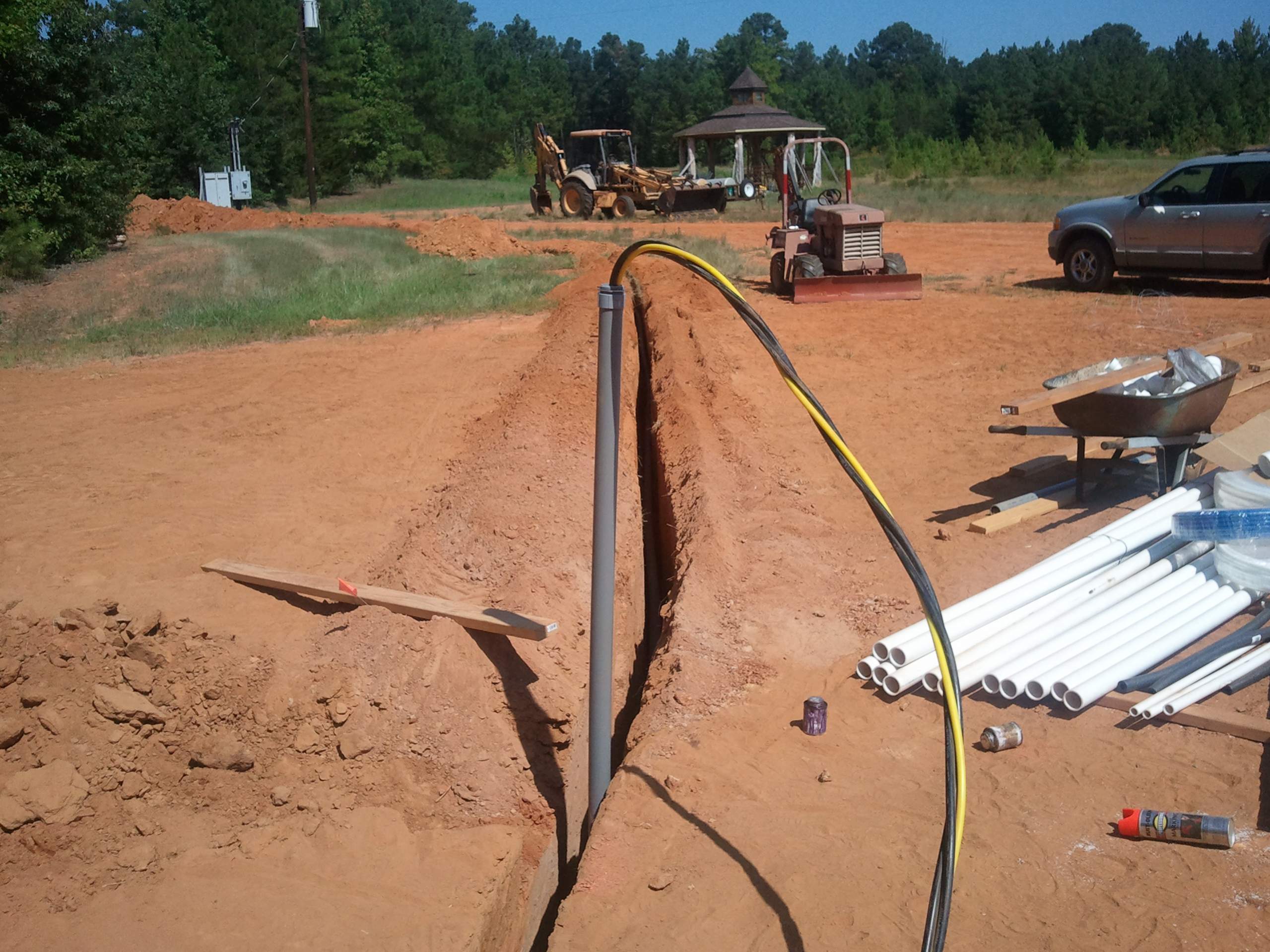

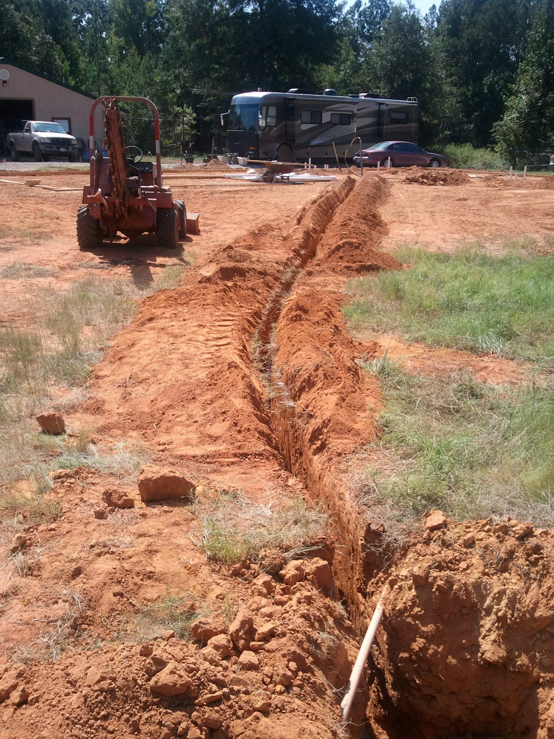

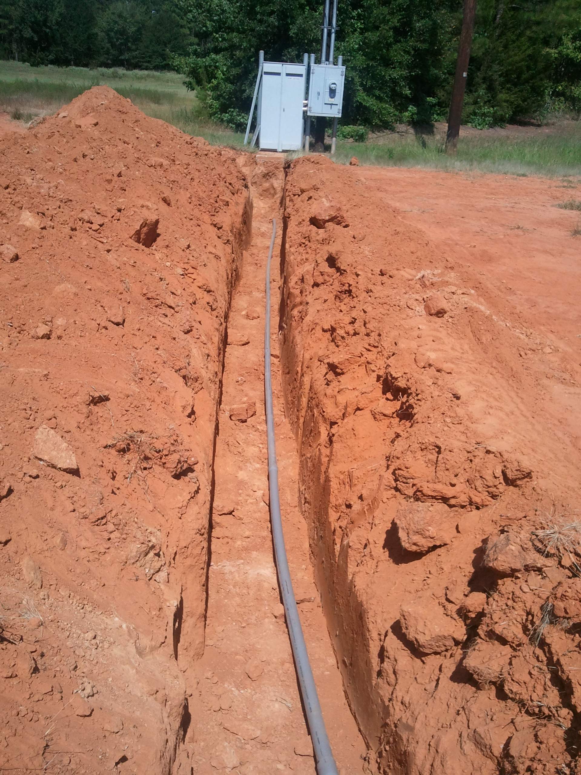

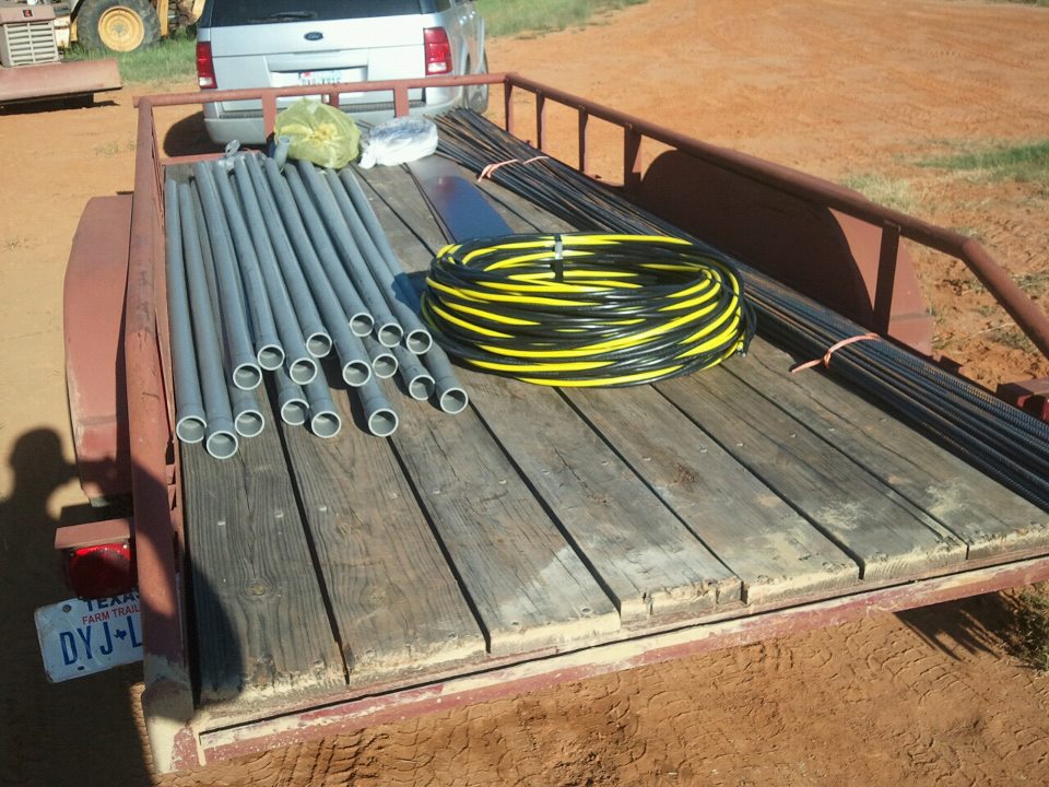

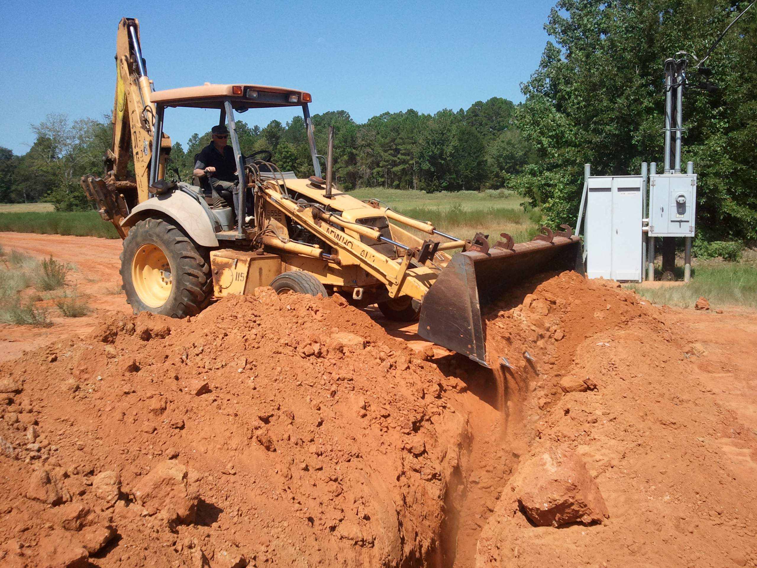

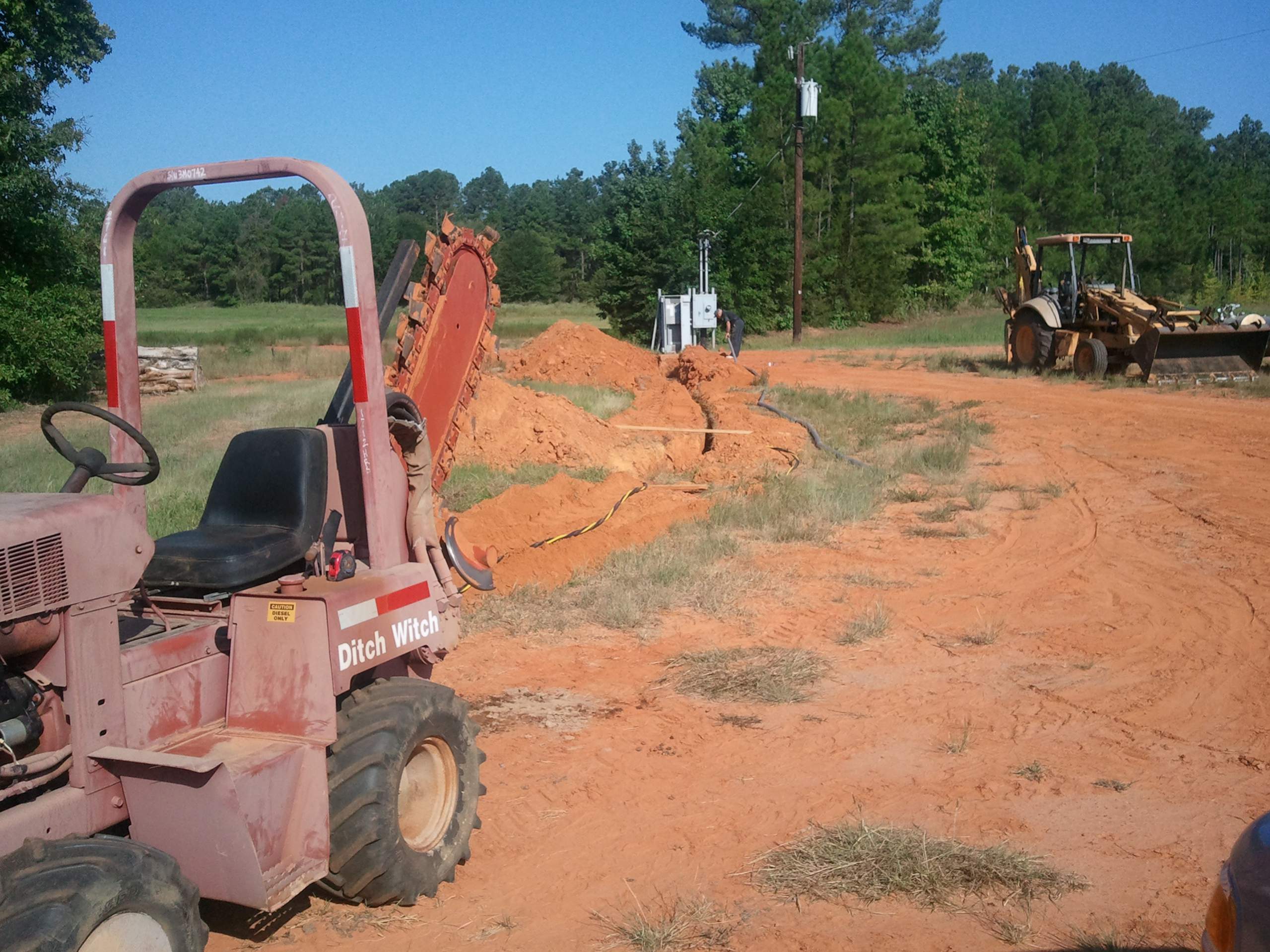

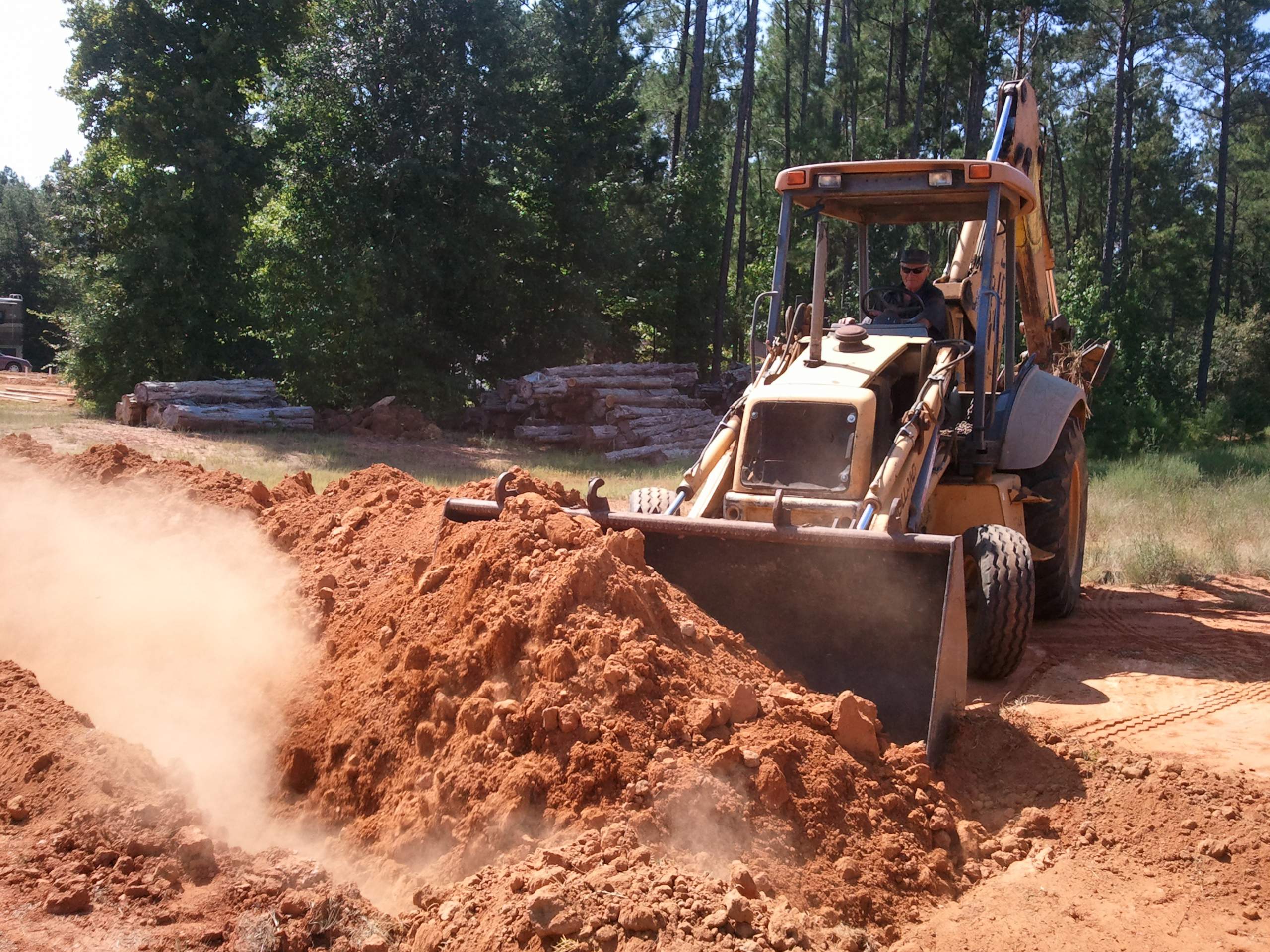

Dad and I have been digging a trench almost 200 feet long from the meter to the place on the garage wall where the panel will go. He bought 210 feet of wire and 200 feet of 3 inch conduit. We are only over by a dozen feet!!!
Most of the trench is two feet down, but where one of the roads is, we went down four feet.
We used both the backhoe, the ditchwitch, shovels and the pic to get it dug. There really isn't one tool that can do it all!!!
Eddie

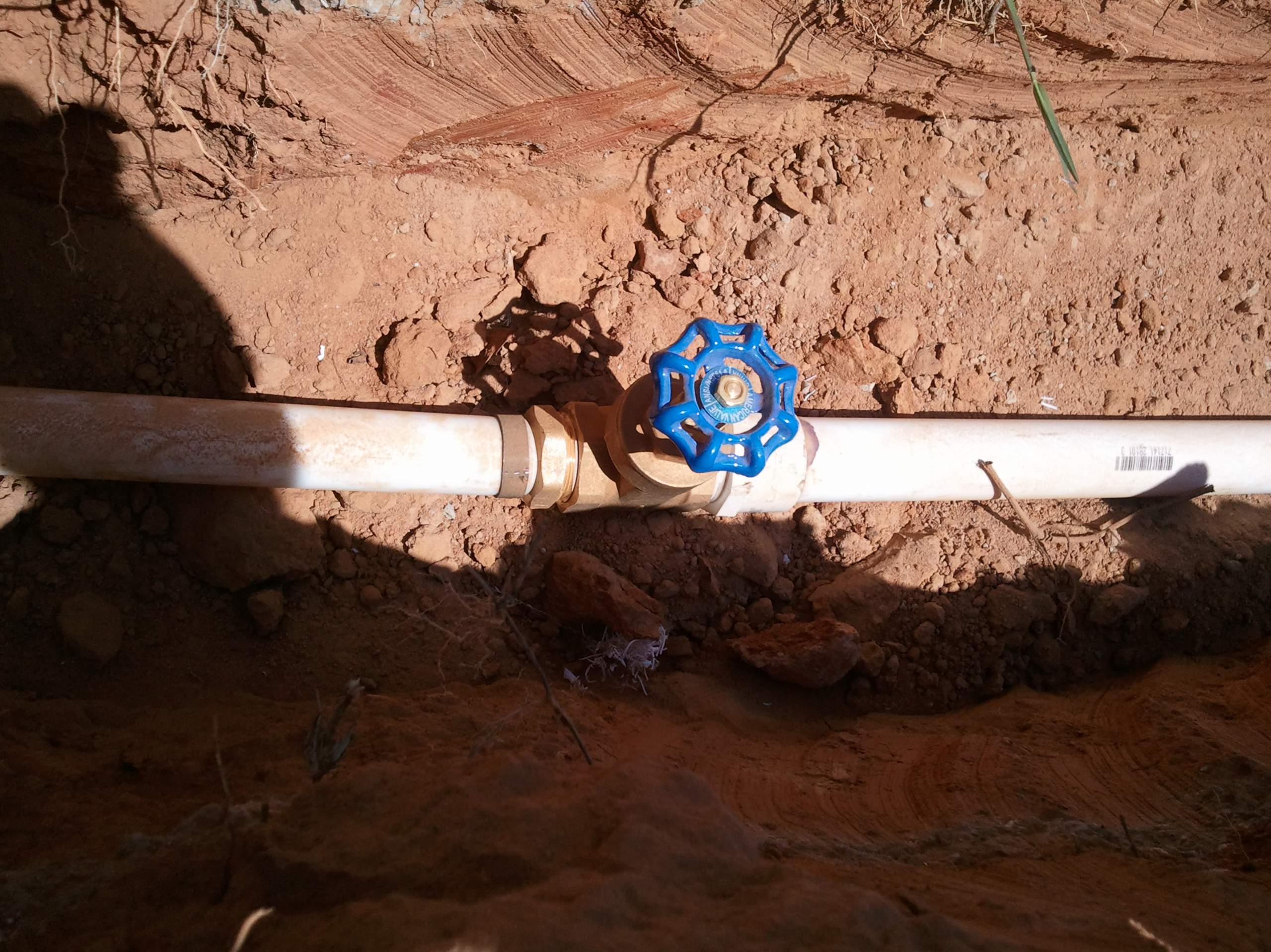

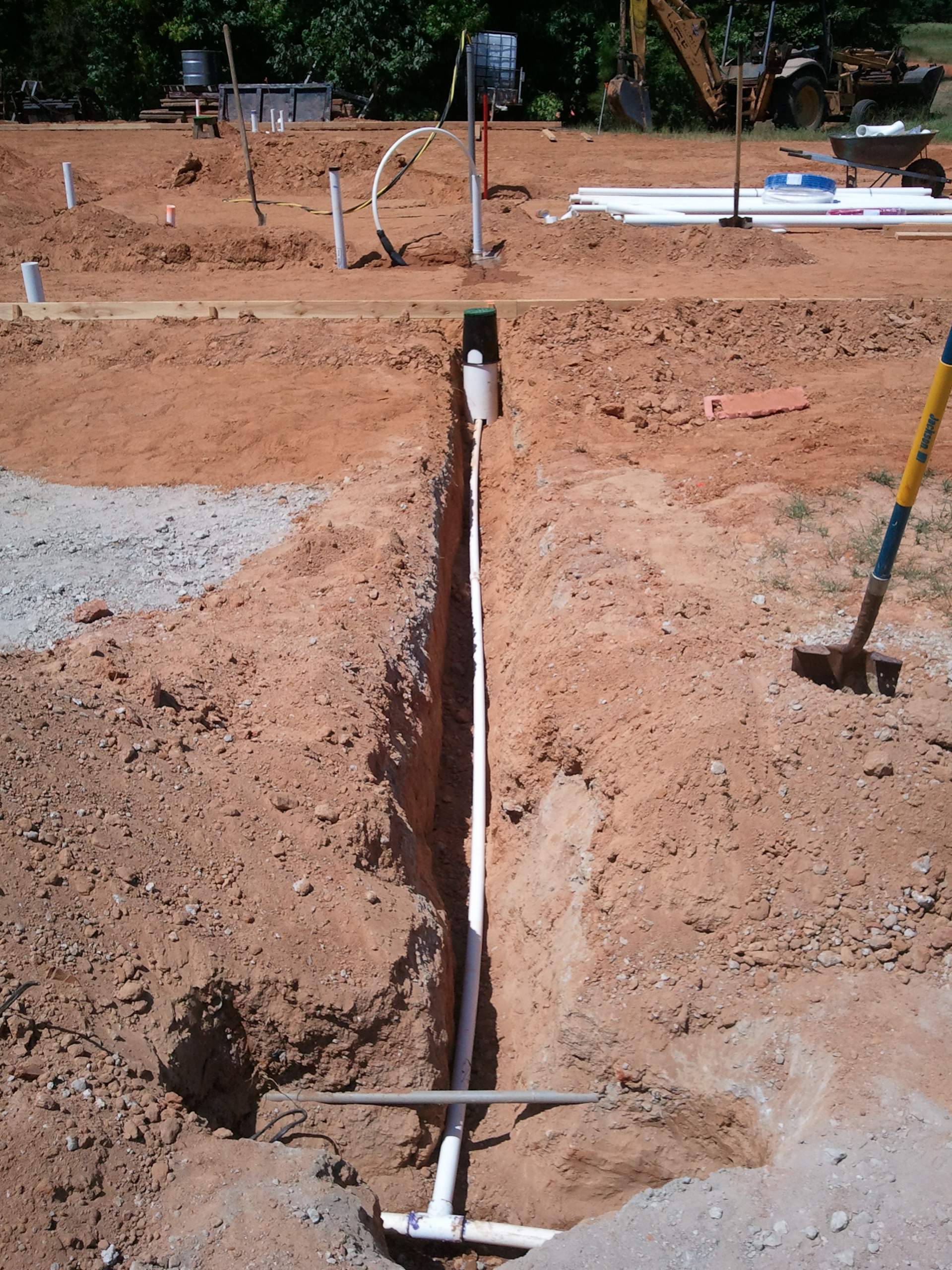

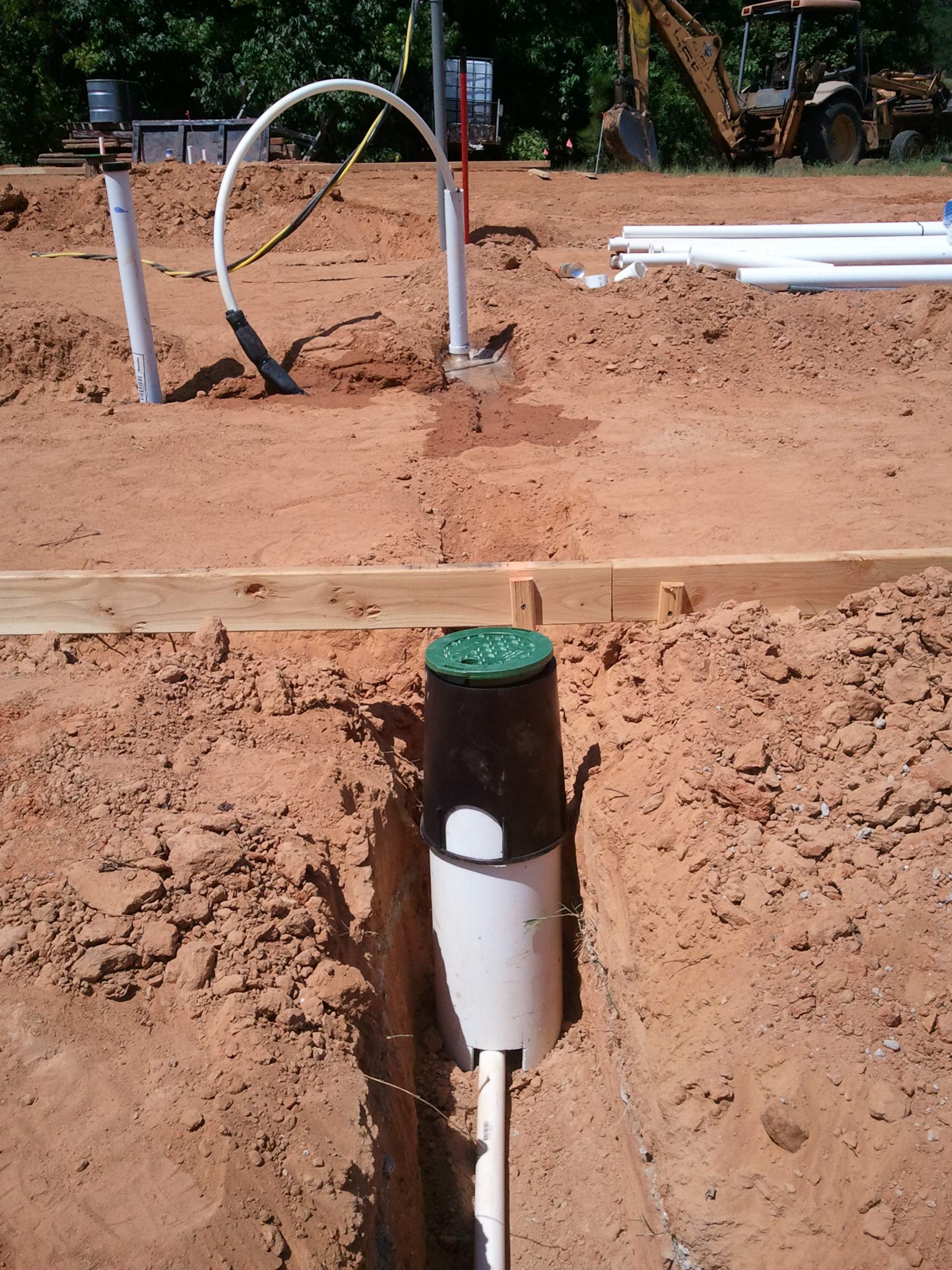

Water will come in from a once in Schedule 40 PVC line. There is a one inch brass gate valve that has PVC at one end and then 1 inch PEX at the other. The PEX runs from the valve to an interior wall, next to the location of the Water Heater.
I like to put a six inch PVC pipe under my water valve boxes so I can get the lid above the finished ground and stilll keep the dirt off of the valvel.
Eddie

Eddie if you ditch the Sch40 MIP x PVC adaptors and
use instead Sch 80 you can sleep much sounder... If it
is gonna get broke it will break there, w/ the Sch 80
it is a whole new world...FWIW.

I didn't want to run Schedule 40 under the slab, so that's why I went with PEX after the valve. I've never seen Schedule 80 in water lines, just grey conduit. Do they make Schedule 80 connections too? My experience with PVC is that the pipe is never the problem, it's always the connections, which is why PEX is so nice. Very few connections to worry about.

Yep, Sch 80 PVC fittings. They make darn near
everything you can buy in sch 40. I only keep Sch 80
MIP x PVC adaptors on the truck, everything else is
sch 40 when I use PVC. Like you say, it is the connections*
people** break and the worst of the bunch is the MIP x PVC
adaptor. Go Sch 80 and they are like twice as thick,
way less apt to break.
*and PVC pipe exposed to UV rays becomes VERY brittle.
**Expansion and Contraction and Ground movement as well breaks it.
Look at how thin the plastic is at the threads!
