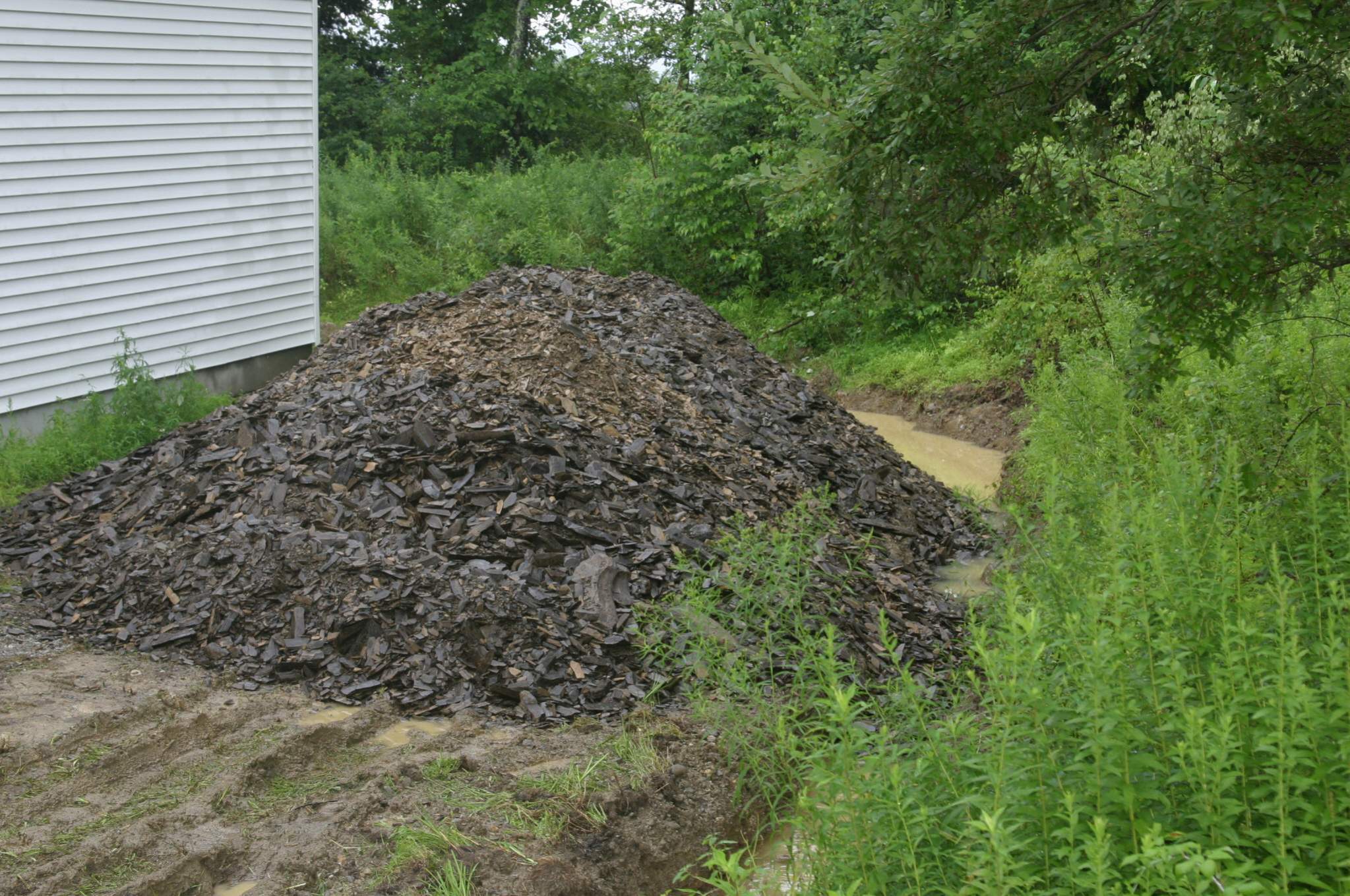

Got Shale?
I didn't get the trench finished (I know, I know, I started from the wrong end..) yesterday's and today's rain filled it up and it's too slick to do anything now. So I'm going to try this approach, push the shale in it and spread it to grade, then re-dig for the pipe at the edge, at some future time. I over-killed the trench size (about 3x3) so it ought to be easy. This stuff has some dirt to it, so I may heed Curly Dave's advice.

bye bye rubber tires:(
I have refused to use that around my barn because of the risk to rubber tires. Ruin one rear tractor tire and "free" becomes "expensive". Ruin a second tire and "expensive" becomes "I am stupid". The guy trying to sell me shale replied to my question of "how is it on tires" with this remark, "I have had to replace one atv tire, one truck tire and one tractor tire but when you see a piece of shale sticking up you just hop off and step it down so it don't cut a tire". For what he was charging for the shale and since I didn't have any steel tracked toys to spread it I choose to pass and not risk my tires.
If you do put this shale anywhere you plan to drive then top it with a good gravel that will protect your tires. If you can spread it without driving on it then that is great but just watch your tires.

I suppose I could rent a track machine. That would probably do a good job of flattening it down and packing it.. but I always have to learn the hard way. :eek:
