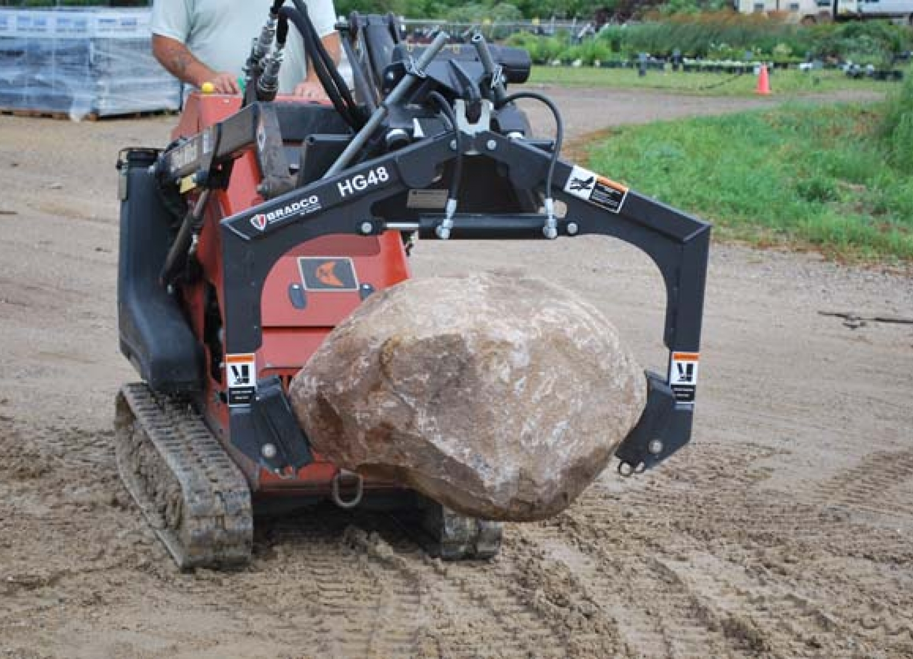

Here is an interesting product but can only lift 1500 lbs https://www.paladinattachments.com/sites/default/files/prod_lit/Bradco_Hardscape_Grapple.pdf
Probably makes building rock walls pretty easy
