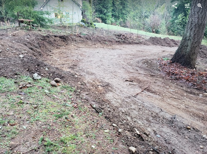

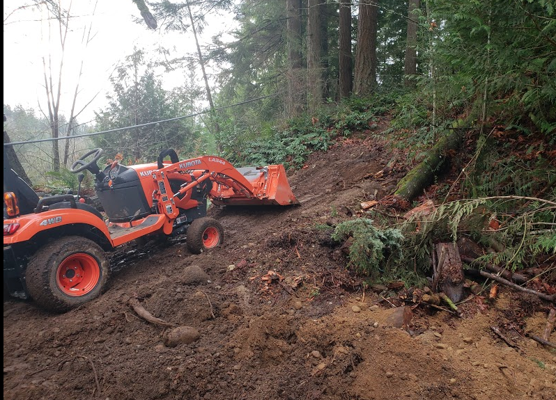

Made it up today! Also moved forward into the flat area on the hill about 100 feet. Now I'm thinking I need my tyruck to be able to drive up there so I'm back to improving the ramp. I ahve loads of good size rocks on this property. I'm packing the sides of the ramp with them, then pouring clay soild on top. It is all getting compacted the first time I drive on it but I'll let it be rained on for the rest of this season before attmepting to drive my truck up there. Then I'm going to build a workshop awith some parking spots and tractor carport too. So exited to be up there!

Nice ramp! Looks like a beautiful day.

It is a good feeling to achieve a goal through persistence... I felt the same way at my brothers place when I told him I would build a trial to the highest point... he was on board but it was very low priority.
Now, when he has company they often take the RTV and head to top... access really is everything!
In time, you will get a better idea of what needs to be bolstered and how you can make little improvements over time... the first trail I did 25 years ago gets improved a little each year... would never recognize it today from it's humble beginning as a deer trail.
Good Going!
PS... pics remind me of Western Washington...
