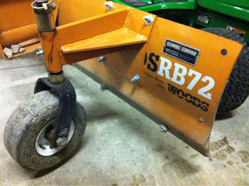

Here's my answer to this problem. I can move the spacers to adjust the height of the blade for big steps and adjust the top link (hydraulically with my rear remote) length to scrape concrete and go right back to gravel. I never have any gravel to move in the spring.

I may do something similar for a FEL snowplow. Do you have a problem with snow clogging the wheels and the wheels not turning?
