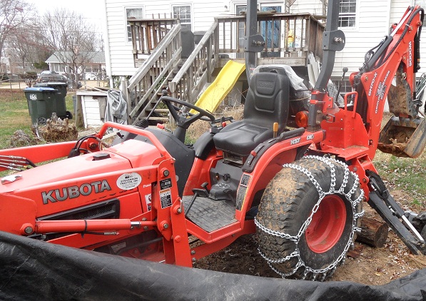

By far the best way to get them on is to lift the tractor with the back-hoe outriggers after you have them draped over the tire!!!! Then remove the hoe and install the blower/back blade
Yup, that's why I bought the Backhoe! It also helps with flats!
I know, I know, I still need to put on tensioners.
/edit - and I got them from tirechains.com as recommended, fairly tight fit, not yet enough link to have to cut off.

The way I read those instructions was to fit the inside as tight as possible (but with no tools), then the outer hook. Then run the machine for bout a 1/4 mile, then re-tighten. Even after settling, I didn't get more then another link on the inside...2-3 on the outside.
Chains were pretty snug before I bungeed. Like the OP's question...how snug is snug enough? Well, guess I'll find out.
As far as the "extra" links, it was either tirechains.com or another site recommended wire tieing....makes sense as the chain company doesn't know how worn a customer's tires may be. Also, of course, another tire manufacturers replacement tire might be have a larger (or smaller) circumference, should a tire require replacement. Makes sense to me...
Anyway, the chains don't flop around when operating at 8-10 MPH and nothing has hit the fenders, so I reckon they're OK.
