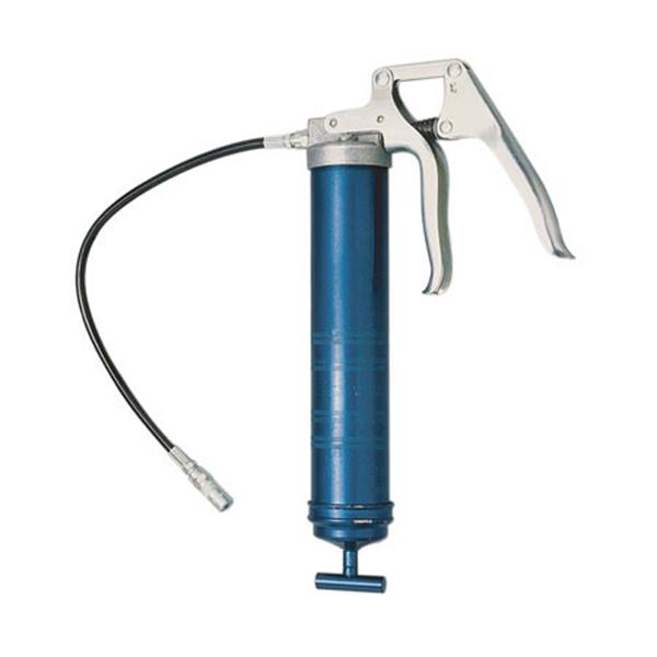

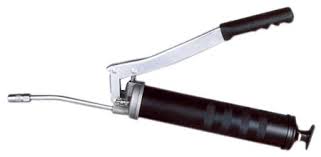

Exactly as RickB said. In fact, I'm not sure I've ever used a grease gun with a solid pipe.
All of the lever guns That I have had have came with a solid pipe.
All of the pistol grips have had a hose,
The reason that I bought the LockNLube coupler is the standard couplers leaked grease, no matter how tight it was adjusted, on hard to grease fittings.
The LockNLube coupler doesn't leak.

Almost every lever type grease gun I have ever sold was sold with a hose as an additional purchase. Every lever type grease gun I ever bought was bought with a hose as a separate purchase, or got a hose from a retired gun. The coupler came off the new pipe immediately and went on the hose. The pipe never was attached to the gun. I have been greasing equipment for over 40 years without spending the kind of money a lock n lube costs to be able to do the job. I'll bet I make it the rest of my life without one, too. I will guarantee there are places I grease the lock n lube won't fit, first to mind are the 3 spindles on my RM990 mower. Hope that everybody that buys them likes them, I don't need one.

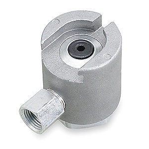

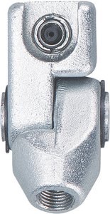

This guy is an alternative to the LockNLube. Works amazingly well. I got it at a local retailer but its available either Amazon or EBay also.
I really like the look of that. Looks more solid than the LnL.
Id buy one, problem is all I can find for sale are on eBay from the US. That means $10USD shipping plus $10 Import charges on a $32USD item. Paying $52USD ($63CAD) for a Canadian grease nipple in Canada seems wrong IMHO.
Now, If I can find one at a local retailer for $30CAD, Ill buy it!. Too bad Napa, Canadian Tire or even better Princess Auto wont get on board for Canadian distribution because it looks like a solid product.
Side note, it looks like LockNLube must be paying bigtime for Google search optimization because even searching for Univerco grease coupler leads to almost 2 whole pages of links for LockNLube.:mad:

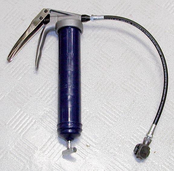

All the lever guns I bought also came with a solid pipe.
I buy 2 rubber hoses and a coupler for each gun when I bought the lever guns and immediately get rid of the metal pipe.
