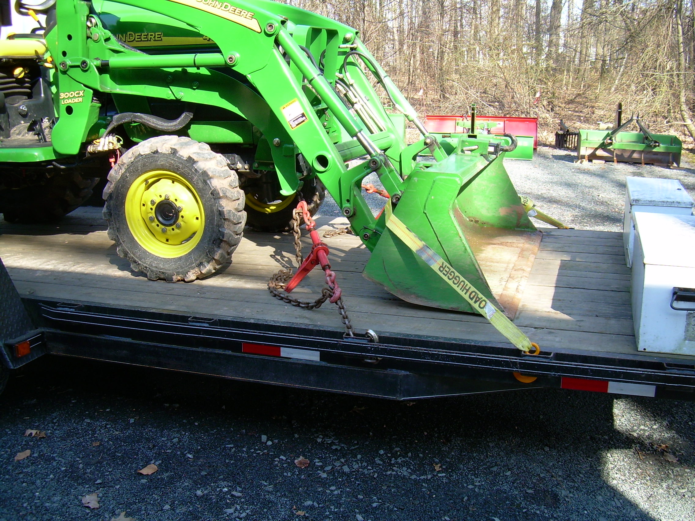

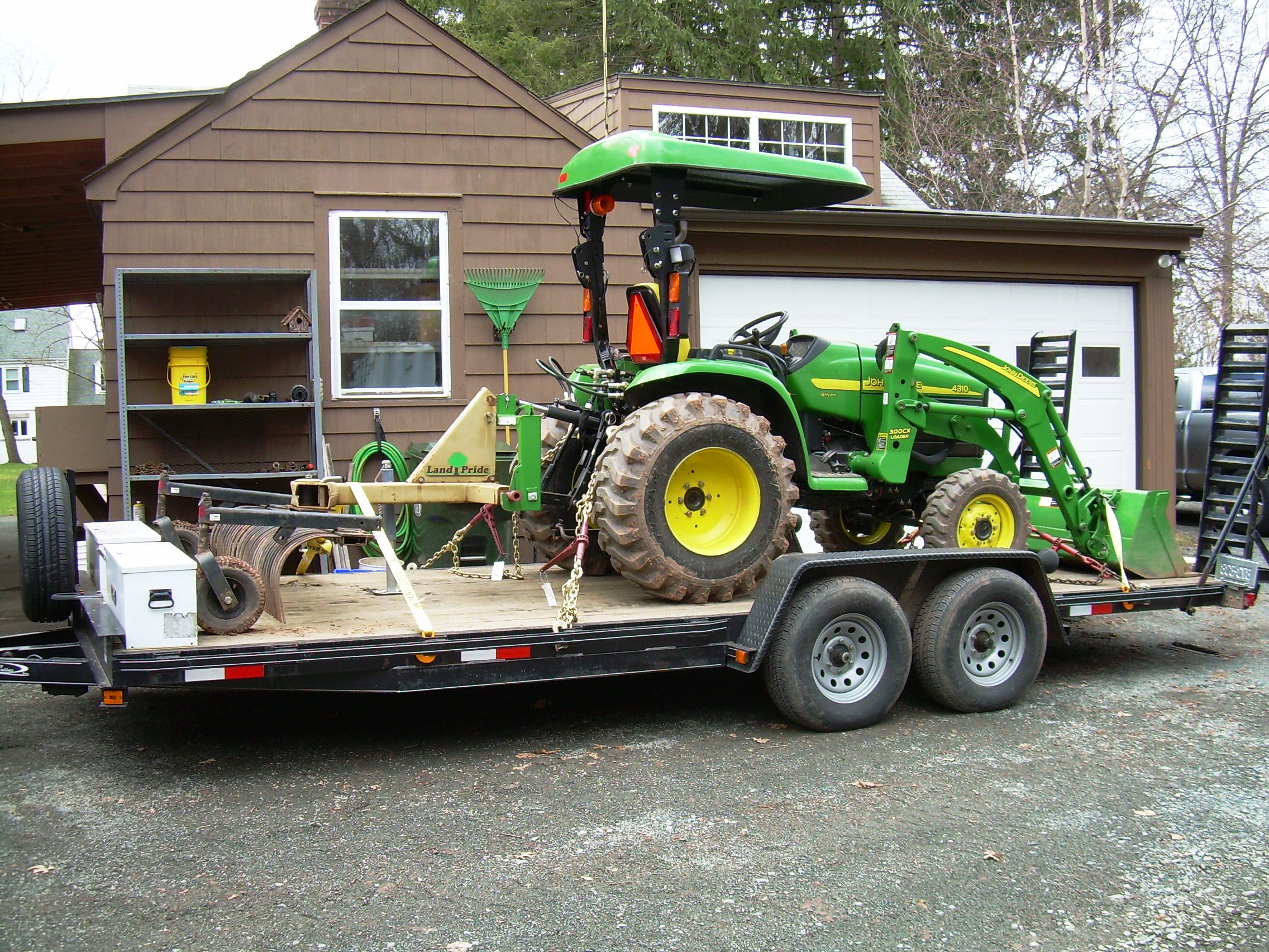

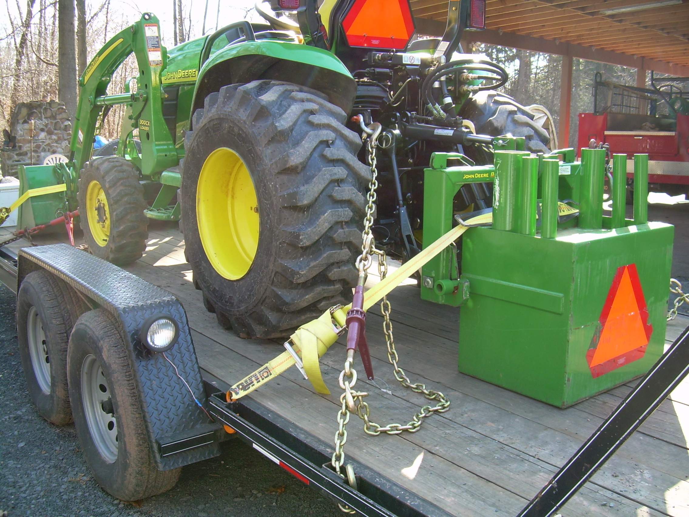

This may be overkill, but it's not hard to do or expensive.
Tie down four corners, 3/8 G70 chain, 4 ratchet binders of the same rating, nylon straps on the loader bucket and whatever is on the 3 pt.
I don't go far but, it makes me feel safer.
Still might be able to find flaws in my set up :)
JB
