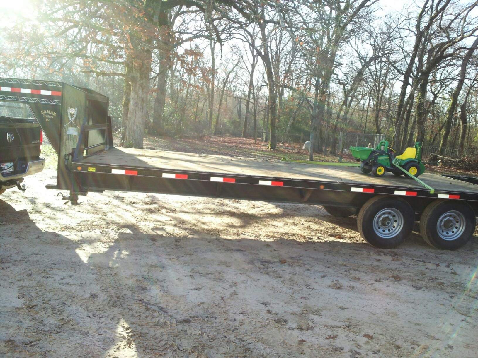

   / How do you tie down tractors when hauling on a trailer? #70
I'm not sure you've got enough trailer there, Foreman.
That's a mighty Big Load. :laughing:
