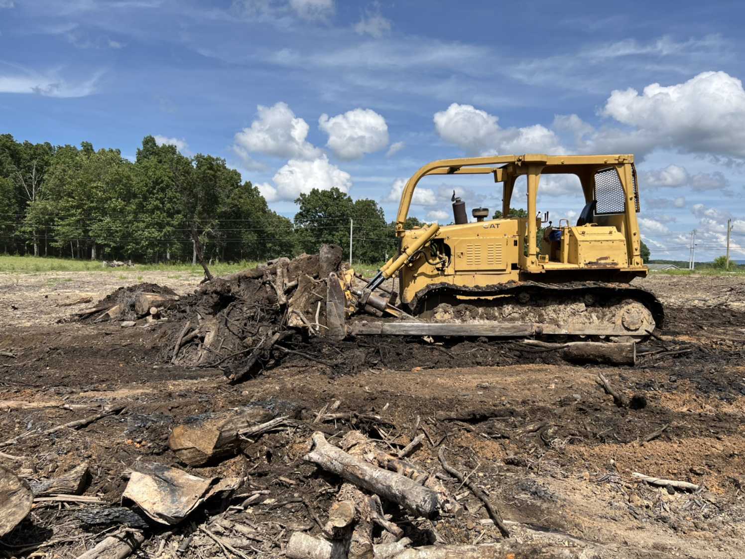

Hmm, I guess I should stop using my dozer to push things since apparently HST trans can’t do work. View attachment 763453
IF you can figure out how to put THAT whiner tranny.....er hystat in a tinkertoy tractor, it only then will be a good comparison.
SR
I guess I should probably swap the 10 liter diesel that weighs as much as the tinker toy tractor while I’m at it.
SR
Agreed, a dozer is a completely different animal and should not have even been brought into this conversation
