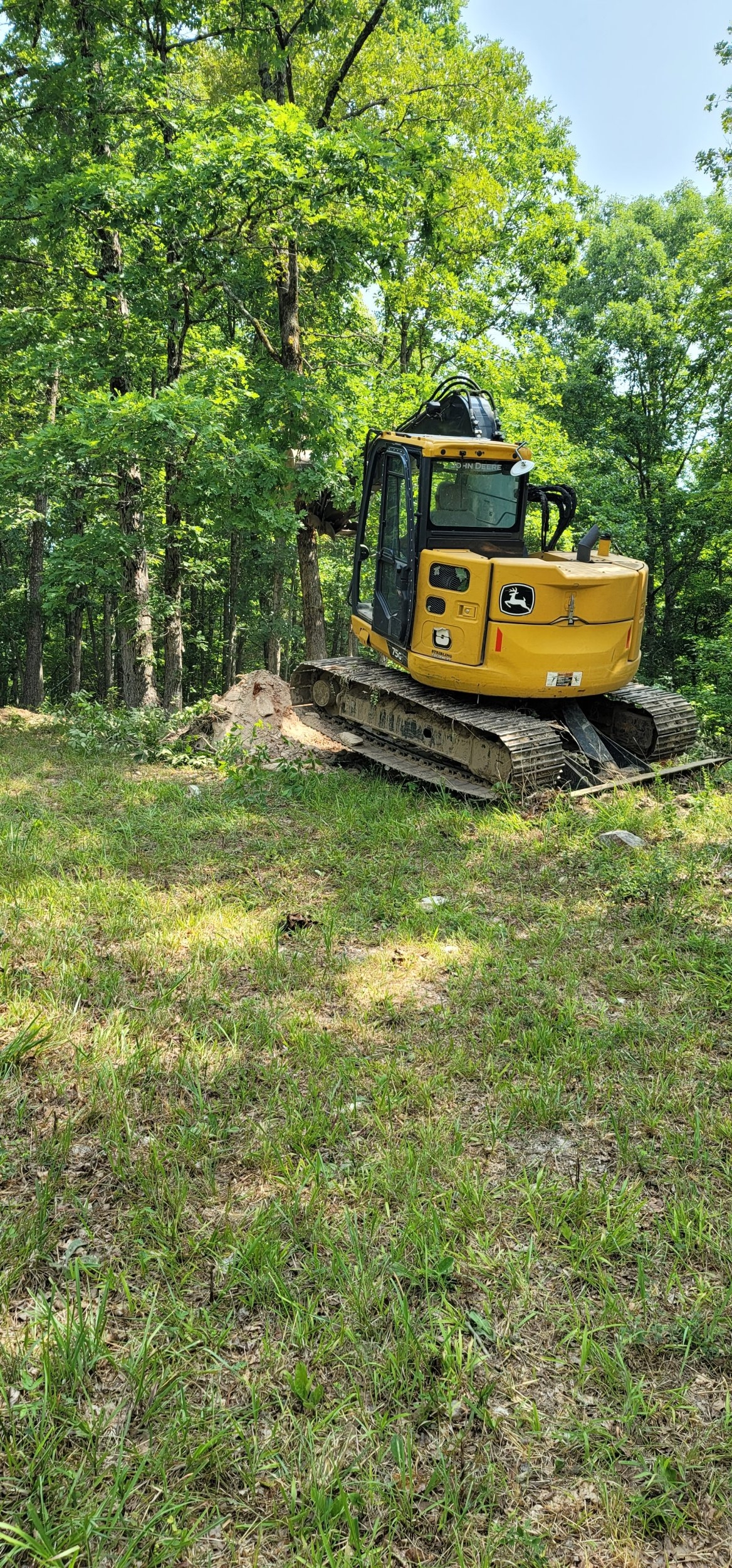

I got a small Kubota X KX033-4 with cab that I use in retirement to make up for being old and not as capable as I used to be. Now 82. But took me a good amount of time playing with it to get it to be second nature. Sure I could lift things, dig out stumps etc but took time. Now it goes fast and easy because it is in the memory bank.
Dug out a few big pine stumps and since I had left 4 ft of the trunk it was able to get leverage to pull it over and break the roots after digging around it.
The thumb is used all the time for lifting trees branches etc. Pushing over trees is surprising easy up to a certain size.
The 36 inch bucket is very useful and can smooth or move dirt fast
I even use it for gardening
not cheap to buy but I can likely sell it for close to what I paid for it if I wanted
