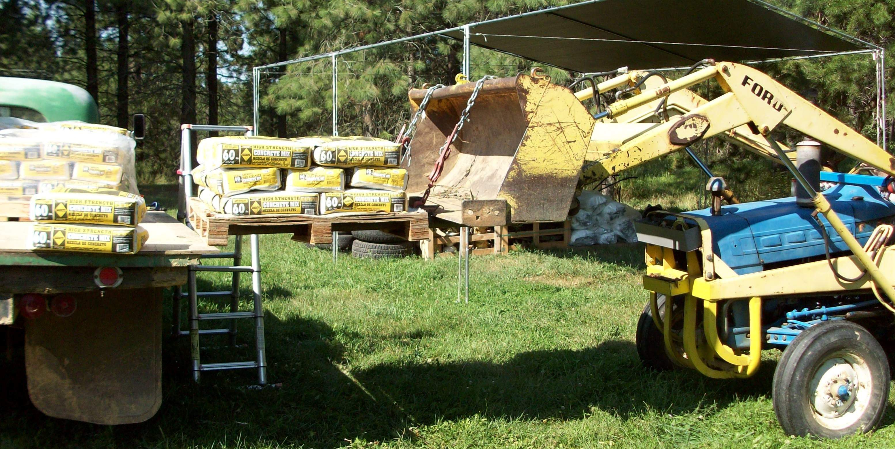

Check, I would be completely surprised if my Massey was that much stronger than a bx25 or bx2670. In my tests I used the hardest testing with forks and weight loads extended out on the pallet instead of tight to the pins. If your dealer us correct . . we're talking 350 lbs different. It just doesn't seem possible. However in all my years considering kubotas . . I never did really test thr fel with any level of weight in it.
The distance away from the pins does make a major difference in what any loader can lift-
My old ford 3000 is rated at 2000 lbs. in the bucket to full height (120") but one time I put a pair of chain on pallet forks on the bucket and tried to unload a full pallet of concrete.
Couldn't lift it off my old International dump bed until I got it down around 1300 lbs.
I also agree with LD1 about the difference in ability to lift dropping as the loader gets closer to full height- (could be wrong) but I think of it as an acute triangle when near full height.
The leverage the hydraulic cylinders can apply is greater at low lift heights due to the geometry,
the distance each inch of lift piston extension has to move the bucket attachment point increases with how close the loader gets to full lift .
It seems to (out weigh) the difference in static weight applied at different heights to the actual hydraulic cylinders.
I can not remember a time when lifting a border-line heavy weight in the bucket, where the loader actually sped up the higher the bucket got. some times the loader will only go so high,- yet at any place from the ground to chest high the loader will lift just fine...
Once again i could be wrong -but that has been my experience with my Ford ,Rhino and New Holland loaders
