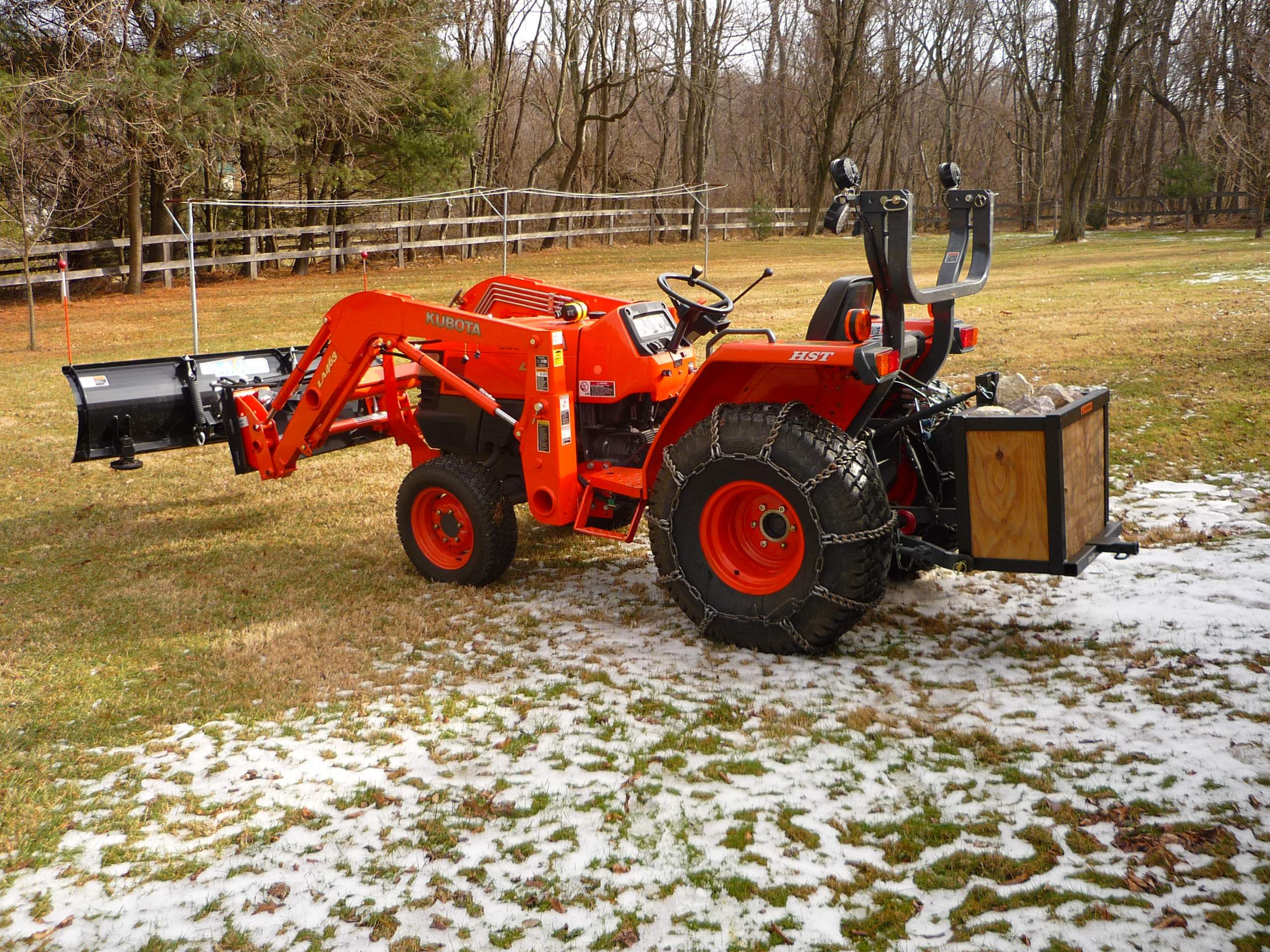

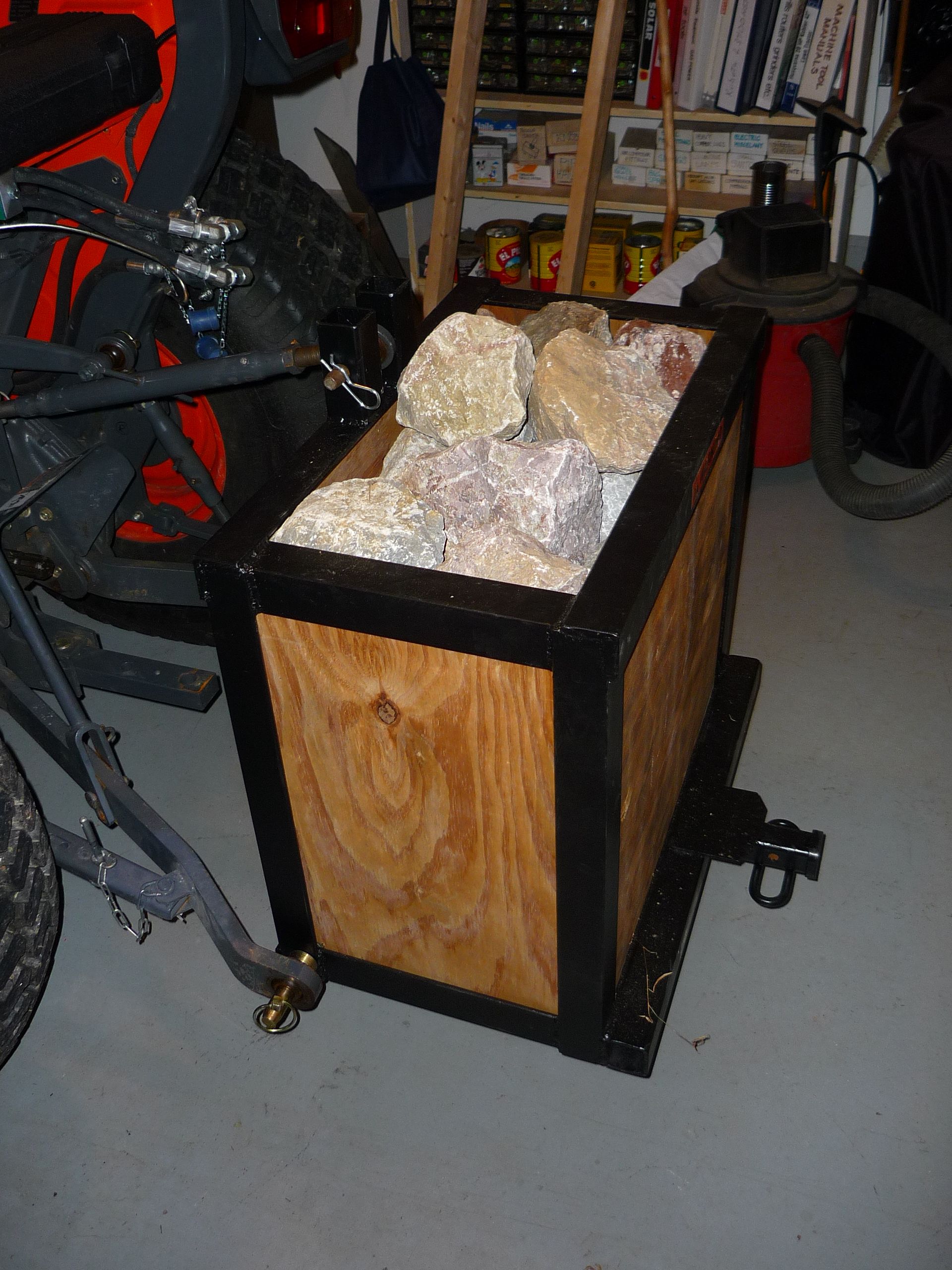

When I had my L3130, I usually had nothing on the 3 pt, but it did have loaded R-4s. I also had the SSQA 723 loader, and although the heaviest think I ever lifted, more or less, was a 600 lb table saw, I never felt the rear end was too light. I pushed a 78" front snow plow with it, as well. When I got the L3400, with unloaded tires, it definitely needed a weight back there for about anything using the loader, so I built a ballast box which I filled up with stone. Maybe weighs 600 lbs? It works. But then, I am not messing around on hills very much. I have a 6' rear blade, but it isn't nearly as heavy.

BTW - I really like Notforhire's ballast implement. V-E-R-Y low CG should help stability on side hills and the receiver hitch makes it even more useful.

Since selling the 3240 and going to my 5055e I don't use the counterweight very often. For that reason I never did any improvements/ changes.
I left it on the 3240 most of the time, because it improved stability moving round bales etc.
The only time I use it now, is if I have a heavy lift, or I intend on doing a lot of digging FEL work.
In the fall I buy pallets of coal, which weigh 2,400#. I can do the lift without the counterweight, but the rear is a little light and I have trouble driving uphill on my gravel drive in 2WD. The counterweight makes all the difference in the world, and I almost never use 4WD if it's on.
It also works well on my friends blue TN75, even though the weight is still painted orange:laughing:
