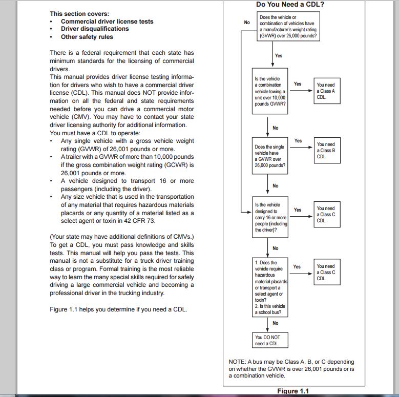

I have done tons of reading at the cites you already posted. I still have yet to read anything that excludes a person from those weight restrictions if you are non-commercial.
The very image you posted below would seem to exclude them, based on what it says in the accompanying sidebar (not the flowchart itself - which presumes one is driving commercially)
The sidebar says it's licensing information for those driving commercially.

Ohio's CDL flow chart looks the same as the one posted earlier.
Does the vehicle or combination of vehicles have a mfg weight rating over 26k? 12.2+24k=36.2k.............Yes
Is the vehicle a combination vehicle towing a unit with a GWVR over 10k.......YES
CDL A required
I see no exemptions for non-commercial use?

The document you yourself have provided says, in it's sidebar, that "There is a federal requirement for that each state has minimum standards for the licensing of commercial drivers."
That seems pretty clear and unambiguous to me.
