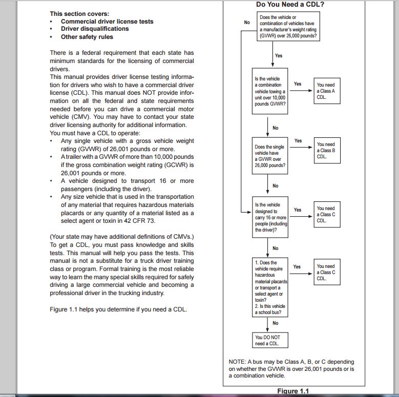

I have read and read more. I am currently looking into getting a CDL because everything tells me I need to. 12.2k GVWR truck, and a 12 ton GN trailer. By my understanding, I need a CDL regardless of my purpose for towing. And a CDL A to boot.
Following flow charts and reading various laws, the only time I see 10,001 mentioned is determining Class A or Class B when truck is over 26k.
If you are driving/towing/hauling using that setup, then yes you do ... assuming that you are doing it for a commercial reason and are engaged in commerce ...

My understanding is that I need a CDL even if NOT doing it for commerce. If I am towing a tractor to my house to a friends, I would still need a CDL.
From everything I have read, A 1-ton truck with a 24k GN trailer is no different than a semi w/53' box. No matter weather commercial or private.

I have done tons of reading at the cites you already posted. I still have yet to read anything that excludes a person from those weight restrictions if you are non-commercial.
If I understand YOU correctly,
1. You are saying that if truck and trailer are registered non-comm, and I am hauling for personal use, I am fine with no CDL.
2. But if registered comm, or hauling commercially, I need the CDL?
3. And if I had a trailer with a GVWR under 13.8k (12.2+13.8=26k) I wouldnt need a CDL regardless?
If only I could be certain.
Ohio's CDL flow chart looks the same as the one posted earlier.
Does the vehicle or combination of vehicles have a mfg weight rating over 26k? 12.2+24k=36.2k.............Yes
Is the vehicle a combination vehicle towing a unit with a GWVR over 10k.......YES
CDL A required
I see no exemptions for non-commercial use?
And there are a TON of other threads on the net all across the US Asking these same questions. A 1-ton with a dual tandem or triple axle GN require a CDL. And the general consensus is YES. And lots of people telling stories of being pulled over towing their old tractor from one farm to the next, or hauling cattle, etc.
