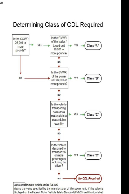

Actually if you read the CDL (commercial which most of us aren't ) chart you'll see first thing anything under 26001 lbs. is none CDL in Virginia
   / How much weight can I legally haul in Virginia without CDL. #18
Cropped image from bcp post,from Va. DMV literature

Where you can get tripped up even if you don't need a CDL is by exceeding the GCWR. On an F-350 the GVWR could be 11,800 with 14,000 tow rating (this is for 4x4 crew cab diesel). But the GCWR for this model is 23,500. If you load the truck to 10000 and tow a trailer rated at 14k loaded to capacity, you'd be under 26,001 lbs but over the GCWR by 500 lbs. Then if for some reason they decide to weigh you, you get a ticket for that but not for any violation of CDL. Also there is always the questions of "what is actually safe?" which depends on a lot of individual circumstance.
   / How much weight can I legally haul in Virginia without CDL. #20
I have never seen a the manufacturer's GCWR enforced. If it was that critical, it would be listed on the door jam next to the axle capacity and tire specs.
