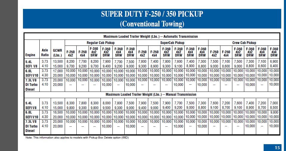

Chris - Look at some older ones. 99tow-ratings.JPG '99 Fords were limited to 20K GCVWR and 10K tow.
