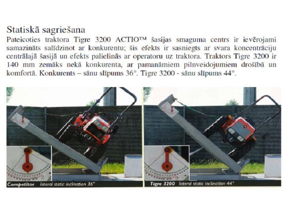

Just thought a picture might help. If the pucker factor gets to much don't do it. Always use a seat belt regardless and if you do go over keep your arms and legs within the tractor area. This would not be a time to flail around.:thumbsup:
