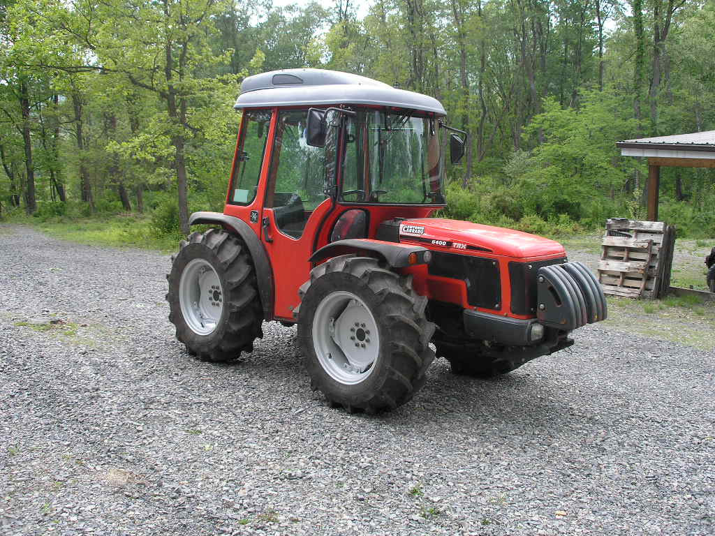

Not the same model as you are looking at but I absolutely love this tractor. Yours might even do steeper slopes than mine although I don't know my limits yet. It is supposed to slide before tipping but I hope I never get the chance to test that theory. I call it my quad on steroids as it will go pretty much anywhere on my hilly property.
The only thing I don't like about it is getting in and out because they strive to make this tractor compact to the point of being ridiculous. Sometimes I think there is an Italian engineer with a warped sense of humor sitting at his desk snickering with thoughts of people doing face plants. If you wear shorts there is a lever carefully placed to go up your pant leg. Long pants? No problem, another special lever for them. The floor boards are designed to wedge your work boot just as your weight is too far forward to recover from :mad: You do get used to it though and it would be much better without a cab.
They are pretty rare here also. I found an inexpensive used one clear across the country and gladly paid the reasonable price of $1000 to get it delivered. Part availability is very good and there is a super nice dealer not too far from me.
