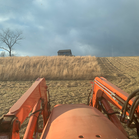

Here’s another steep property I cut. Again, pictures never seem to quite convey how steep. When doing a pass down the hill, it feels like your knees are going through the windshield

That’s a good picture.
Could be used in a horror movie - as you get to the crest of the hill the bad guy appears.
Ominous sky. Tree. House.
The hay looks absolutely perfect. Nice copper color.
MoKelly

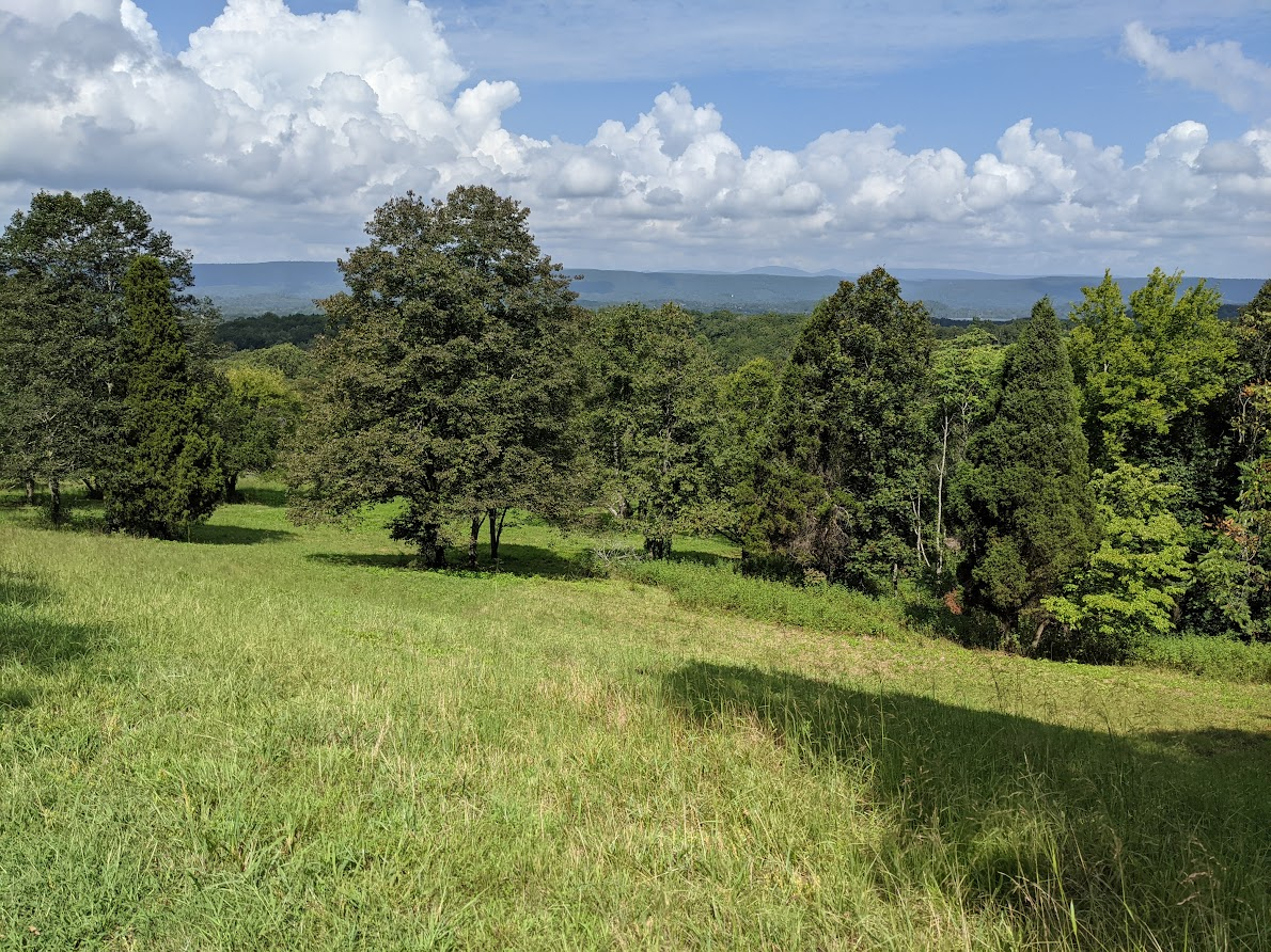

Here is one of my little nightmares. Hard to tell in the picture but this hill is every bit of 30 degrees. A lot of my mowing is in between 15 and 25 degrees. Lot's of pucker factor, jut got my tires filled and stance widened, so we will see how it goes.
Man, that is a beautiful picture with the light and long shadows, grey sky. Much better than most office views, that's for sure.
