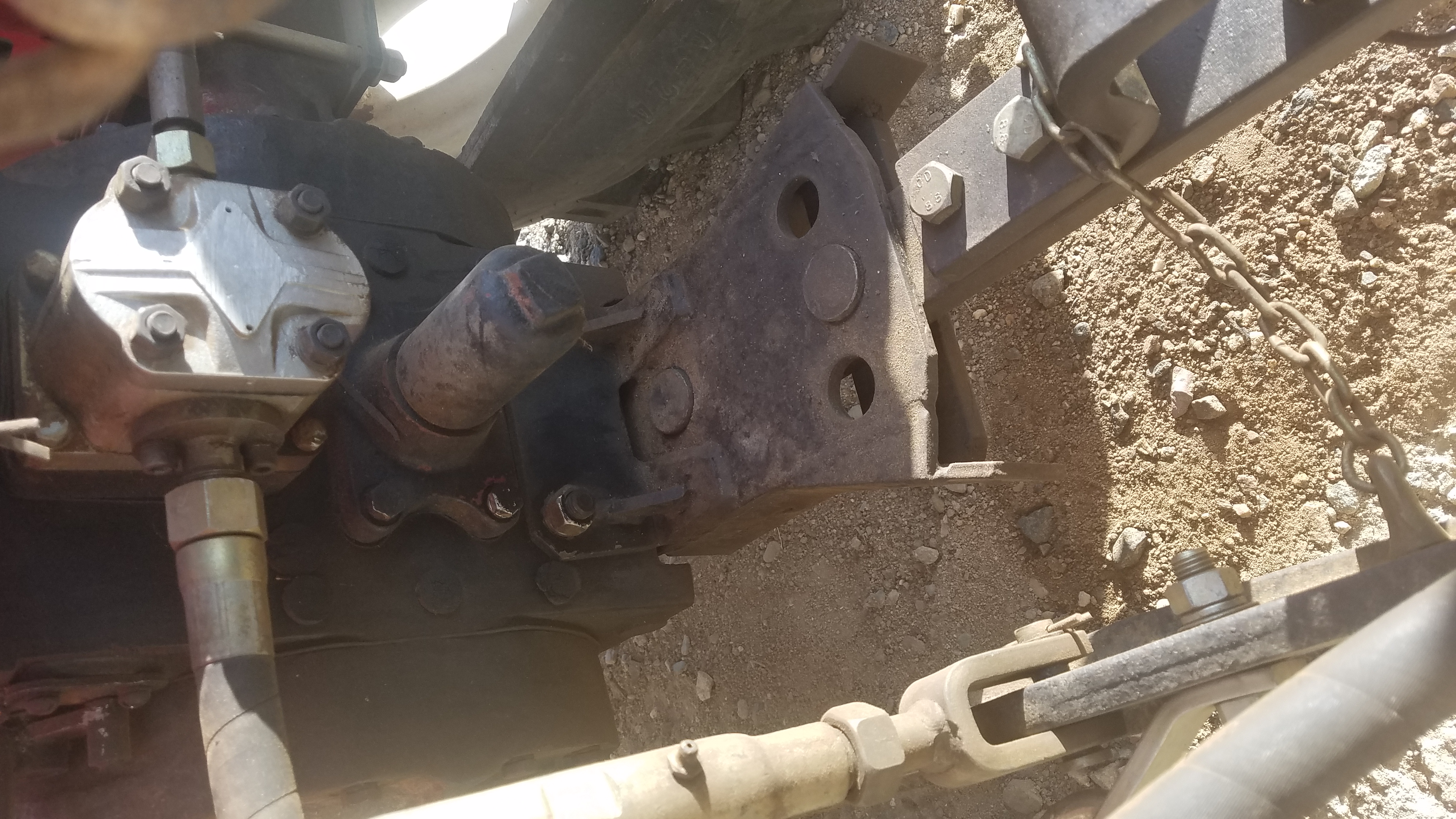

I didn't notice before but the drawbar on the tractor is bolted to the gear box with 6 3/4 inch metric equivalent bolts. (see pic). I am going to weld top and bottom plates with gussets to this drawbar attachement over to the 2x4/1/4 ladder frame as well as use the 3 point hitch pins. This brings the tractor mount much closer to the hoe. With this I am how really comfortable now with welded triangulated mounts from the area around this drawbar to the backhoe frame in place of the top link but I will use the top link anyway in addition to the welded triangulated sub frame braces because I have it. drawbar.jpg

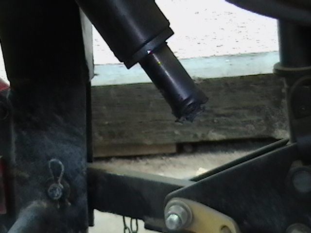

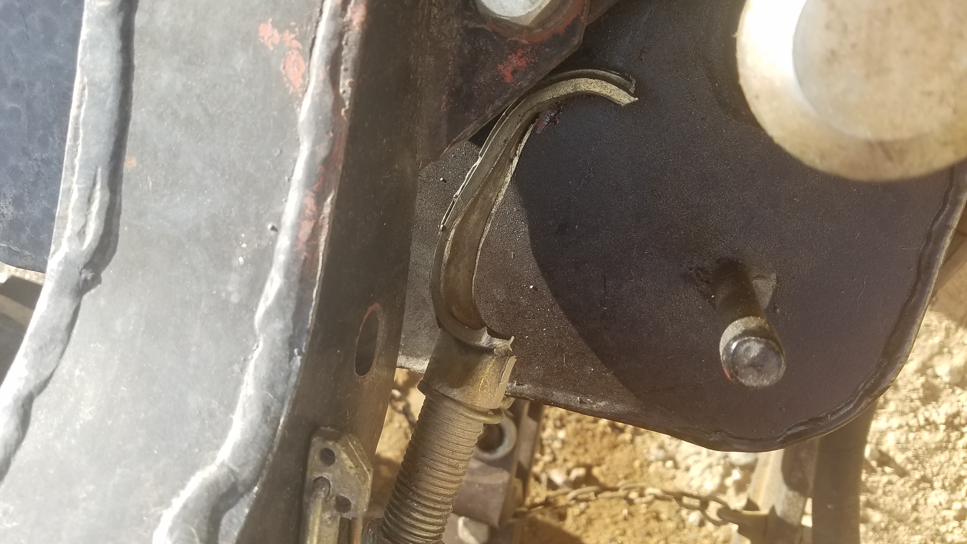

I have also included a pic of my broken top link (to prove I am not lying :) ).toplink.jpg

Just so you don't feel alone, I had a top link fail the same way, American made and hydraulic too. But it was my fault for using too small of a cylinder.

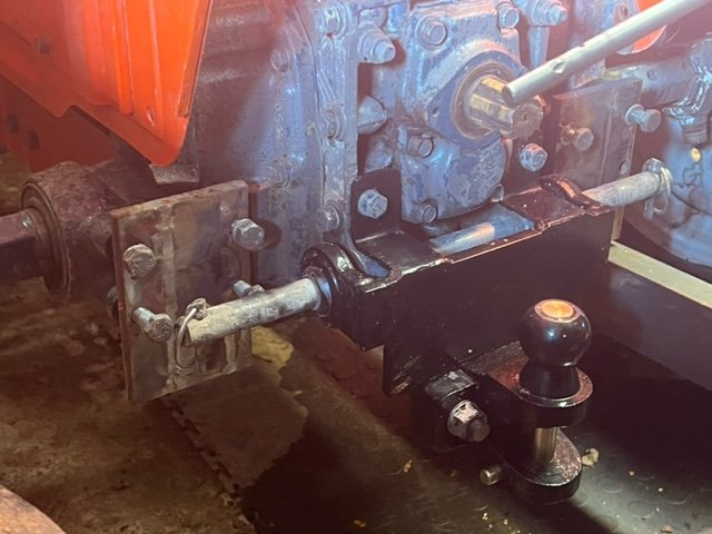

Is anyone able to offer any advice about backhoe frame mounts on my B1400. i have a small italian side shift frame to go on it.
I am considering hanging the rear of the sub frame on the 4 bolts on the rear axle. are these 4 bolts strong enough to take the loads?
The sub frame will then continue forwards and the front will bolt onto the loader arms. I'm hoping to let the loader frame spread the loads about.
Is this feasible?
Many thanks
I do not know the B1400. Are you in the US? How small is the hoe you have?
As for the strength of those plates on the rear axle, it is hard to say. How are the plates mounted to the axle housings? Those are pretty small-looking bolts, but at least the forces would be in shear. Is everything in that area steel?
The Kubota B-series, except for the B20/21/26, are all pretty wimpy in the rear axle department. Kubota did have some small K-series hoes they sold for those early units, with subframes. About 6-ft dig.

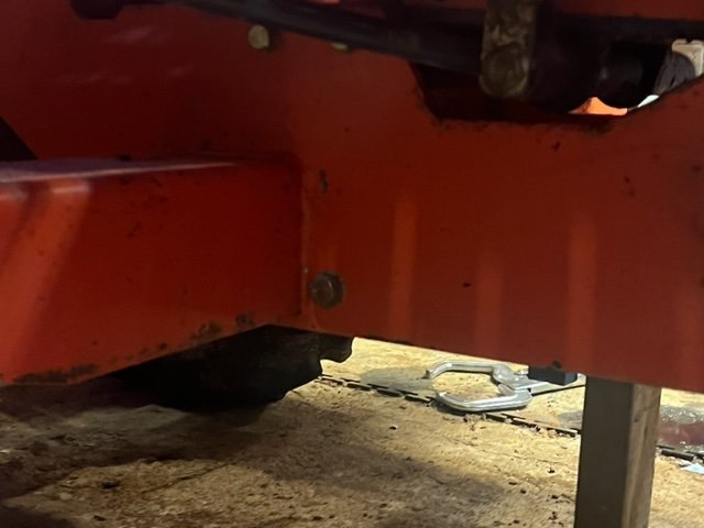

Thanks for taking the time to reply dfkrug. The B1400 is a grey import machine. 19hp. I can only find very limited information on the tractor. I do have a manual which suggests fitting a backhoe can be done (doesn't say how) it also says the max 3 pt lift is 300kg. The backhoe is an old sigma 3 pt machine. it was originally 330kg, but ive stripped quite a bit of weight when I removed the hydraulic tank and some surplus panels that aren't going back on. at a guess its about 250-280 kg now.
The plate is 100mm x 12mm mild steel which is secured to the axle housing with 4x M12 bolts. the bolts are graded 8.8 and are 40mm long of which about 26mm is threaded. As far as I'm aware the axle housings are cast iron.
I do have an option to add more support above and around the front of the axle if required. Ive included a few more pics of my setup so far.
I'm after a very close coupling. How much clearance should I leave between the rear of the ag tyres and the backhoe posts?
Really appreciate your wisdom because I have only recently upgraded my welder and while ive done enough to ensure im producing good welds, I am by no means experienced in this field.
Dan

Are you sure your hoe is only 600#? Any side-view pix of it, with something nearby for scale? That is a pretty small Kubota.
I am for close-coupling the hoe to the tractor, for sure. I see you have the rice paddy tires. You can get away with as little as a finger's-width spacing there, but it will require walking on the rear tire to mount the hoe seat.
