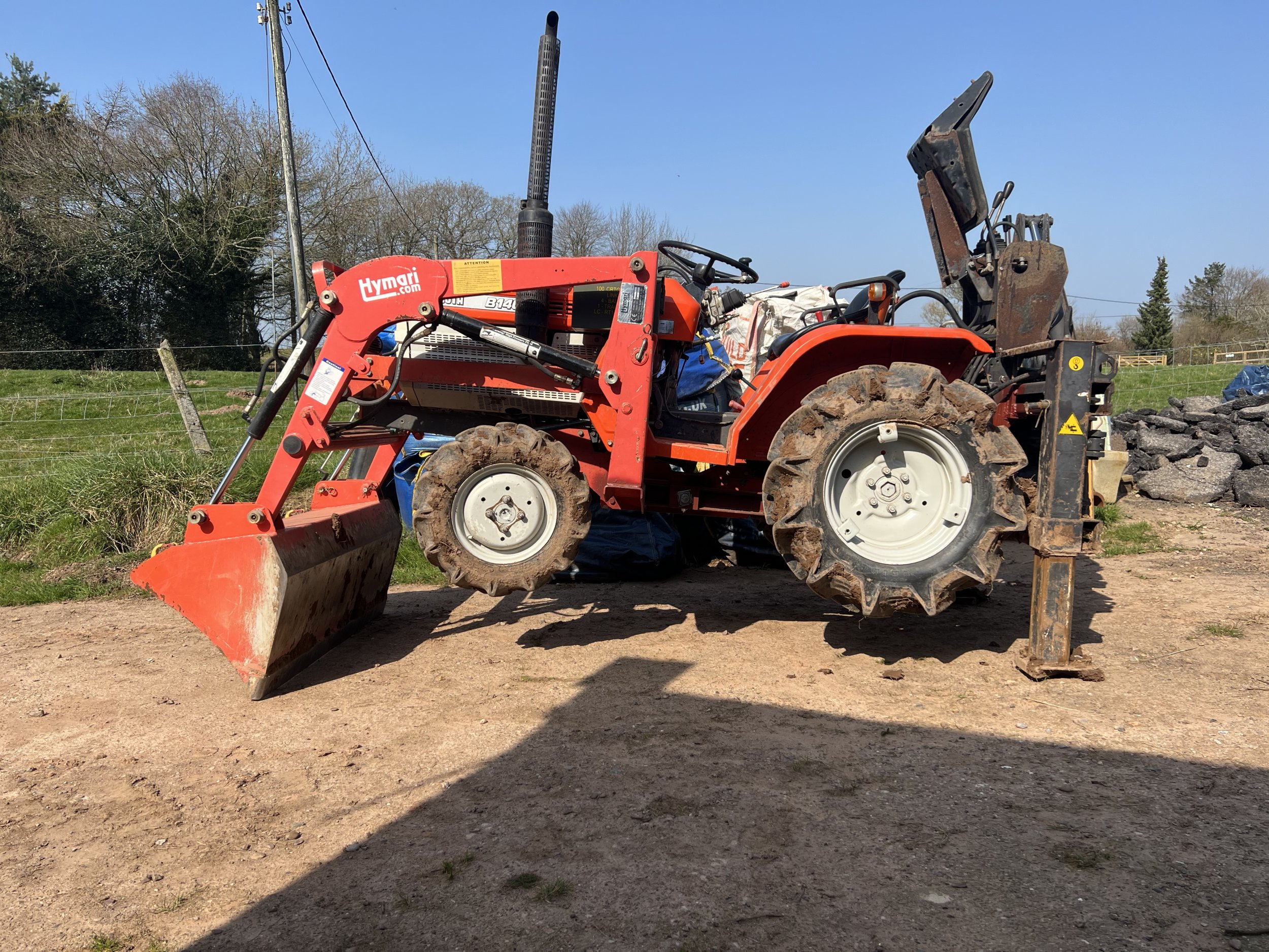

Finally got the frame together. Took a big tree root out. I didn’t baby anything and it stood up nicely.
No flex. Pins work beautifully (I’ll report back if this changes over time)
Actually the tractor drives much better with this close coupled weight at the rear.
Big shout out to dfkrug for your help!
Happy digging folks.

I do not know that hoe. Does it have a toplink connection under the seat? If so, I would connect that to the toplink bracket on the tractor for additional stiffness.
It is a good thing to see how much flex you get while digging. This takes 2 people; one operating the hoe, and the other looking closely at the frame at the rear of the hoe.
Looks good. Killer deal.
No engineered toplink per New Holland design, I can very easily add one though , if needed. Backhoe is 650 lbs per research. Feels solid so far. I am making cleats for the downrigger pads and will do some testing then.

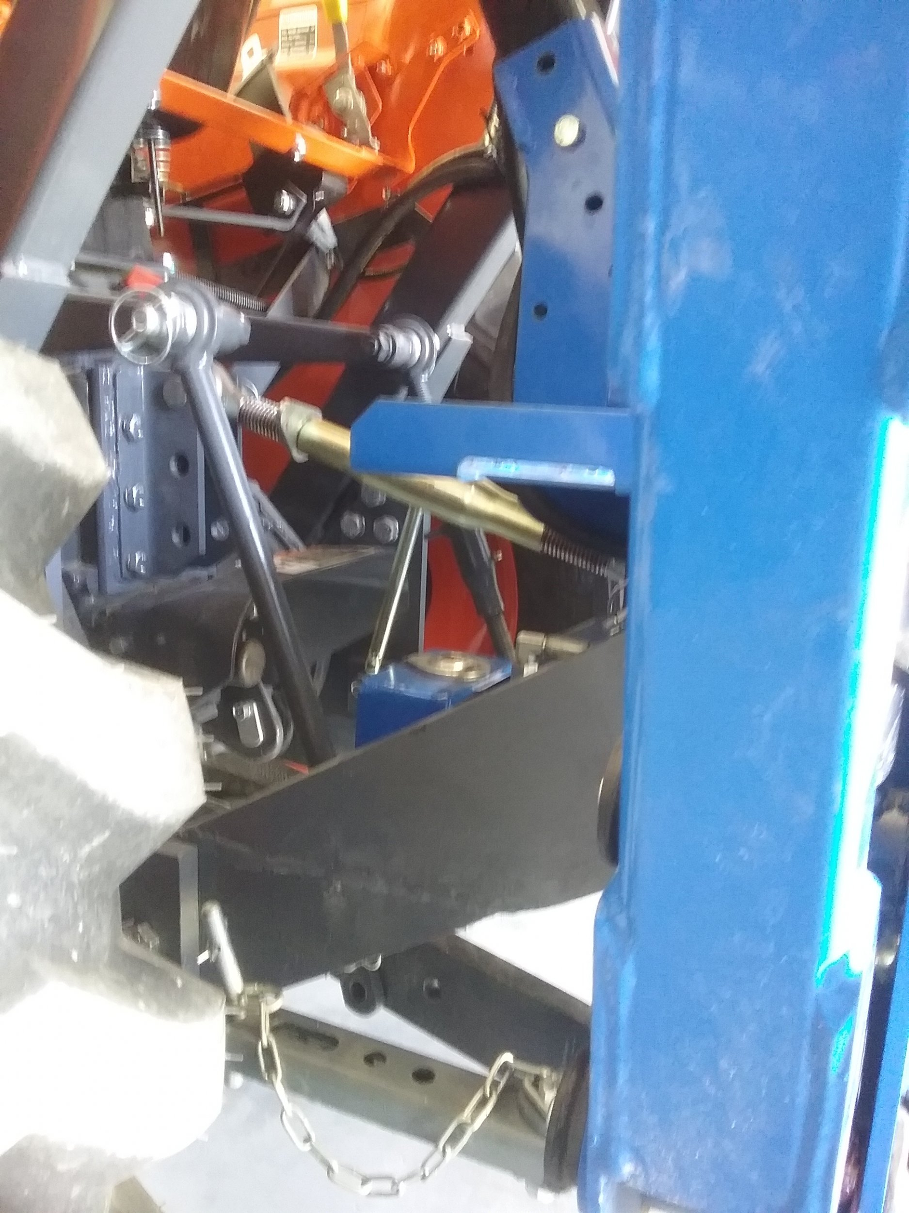

Tested today, a little more flex than i liked. Adding toplink, tractor to hoe.

Tested today, a little more flex than i liked. Adding toplink, tractor to hoe. Please disregard tacks. Will be looking nice soon.😁
Toplink did the trick. About 3/4" flex back is gone now. If not already mentioned, i believe proper bolt connection clearance holes are very important.

The holes in the half-inch plate I used for the subframe on my Kioti CK30 were for 1" fine-thread bolts. I placed them fairly precisely, and as the hours built up, the tiny flexes and wiggles eventually caused the bolt threads to bite into the plate a bit. Now, the bolts do not just slide right in or out.
So, more clearance (bigger holes) may help with that, but they would also allow more movement. I used nylock nuts and sometimes lock washers, too.
Tradeoffs.
