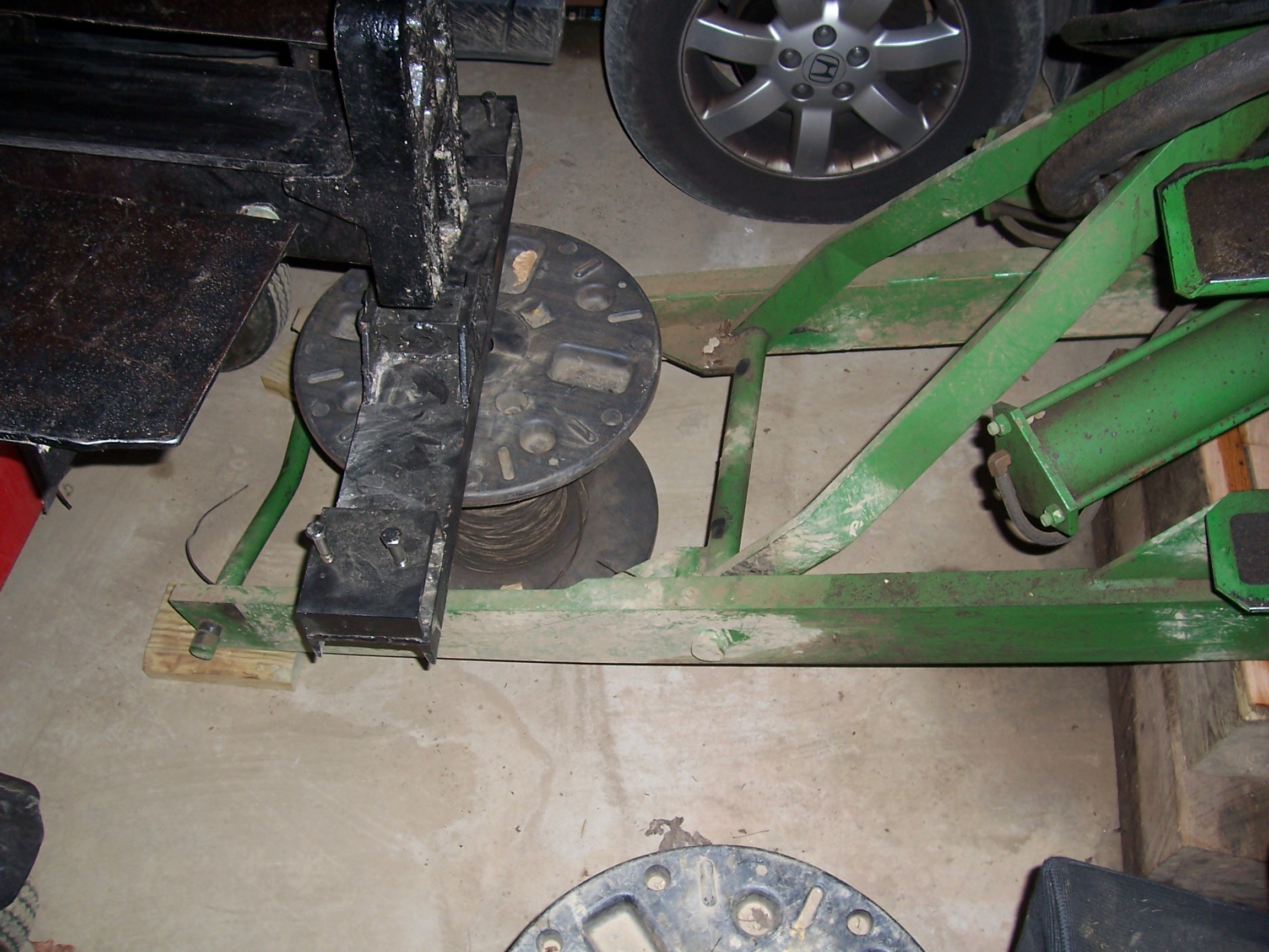

Anyway, here is another JD example...this time a very common 770 with
a brand new JD7 mounted to an undermount ladder-style subframe. An
enhanced toplink with a brace is used. The QA mechanism and cross-
brace (rung) in under the tractor ahead of the axles.
Interesting. My JD1070 with the 8B backhoe does not use a top link connection but otherwise looks quite similar to that JD7. Rear connections are pins on the hoe going into horizontal U openings in plates bolted to the tractor back end, and front has pins that are held captive by rotating plates with spring loaded pins that are quick disconnect. I generally take it off for the summer and put it back on in fall. I've used it hard over the years including installing about 1000' of sewer lines, 36" x 20' and smaller culverts, many hundreds of stumps removed, built a bridge and placed 40 tons of large rocks, trees taken out, etc. I put larger feet on the outriggers because the originals are too small and disappeared in mud and soft soil. No problems with lifting the back end of the tractor and walking it around rather than getting off the hoe seat and driving the tractor for each move. You can see its general frame if you ignore the other crap piled around it in these pics.

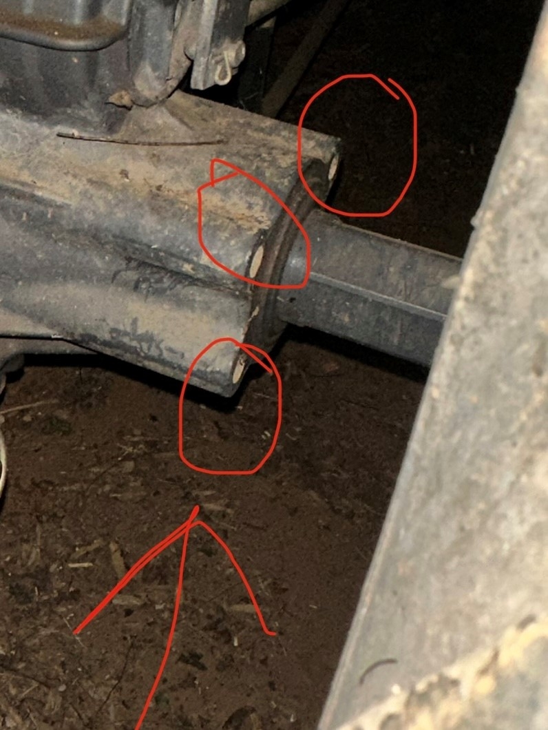

OK - I'm up next :) How about a sub frame for a B2400? The front connection is easy as the FEL is already there with several attachment options. The rear is where I am stuck noodling. I "think" the woods sub frame 1020800 utilizes four tapped holes on the end of the axel housing on each side. See attached pic. I'm assuming this is an acceptable method as I doubt they would have used them otherwise. Also, the ROPS connection looks to be beefy enough to handle a small hoe but it's not very wide so I would need to design something to bolt on to it to widen it up. See attached pic.
I could try to locate the OEM sub frame B4681 but its' really more like a frame enhancer as it does not attach to a hoe itself but rather ends at the axel housing. It is my understanding that the OEM setup back in the day these were made was to use the B4672 backhoe (3 point), B4681 sub frame, and heavy duty top link bracket. One thought I had was to make my own subframe that would mount up to the more current BT603 hoe as I see them a lot for sale used pretty reasonably priced (stop laughing at the size of it). I have only seen 1 B4672 and it was months ago.
Thoughts on this one??? Thanks! Jim

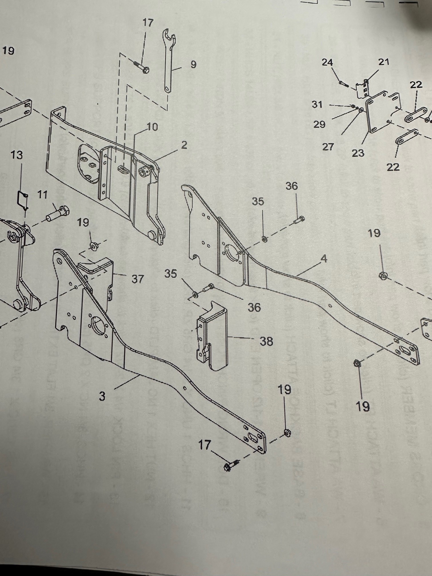

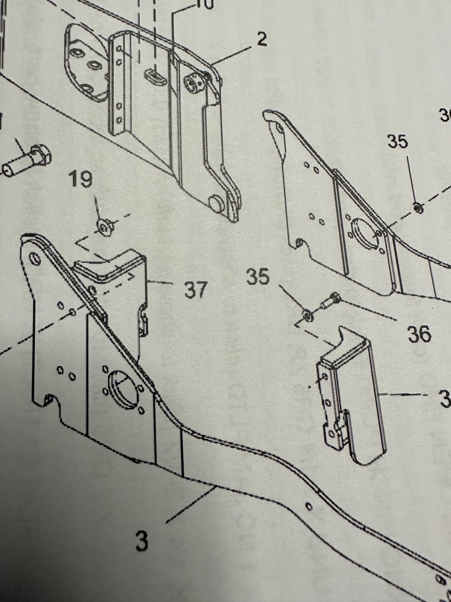

And here is a the diagram for the previously mentioned woods sub frame for the B2400. Not sure what 37 and 38 are as they might be some sort of extra support that bolts to the axel housing as well? I can understand 37s placement as next to the housing that would stick through the hole, and I would assume 38 does the same thing on the other side but it's not clear. None the less it does show that they use those holes on the end of the axel housing.
