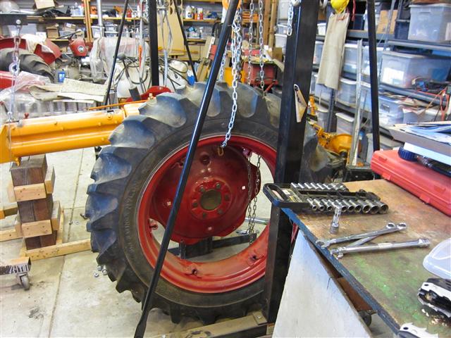

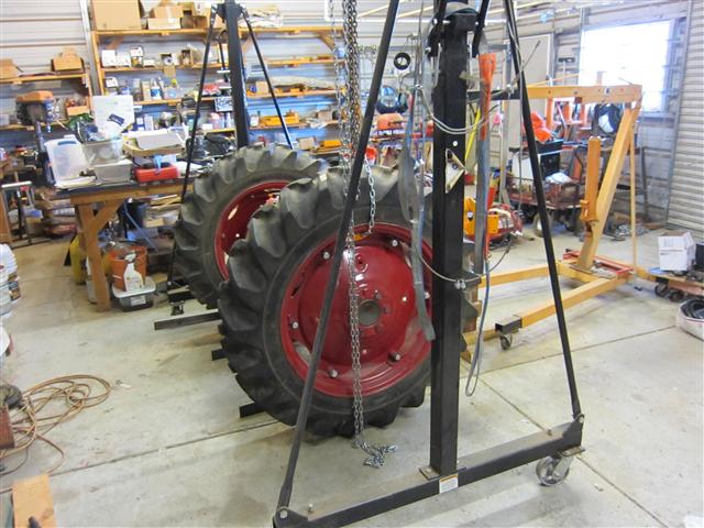

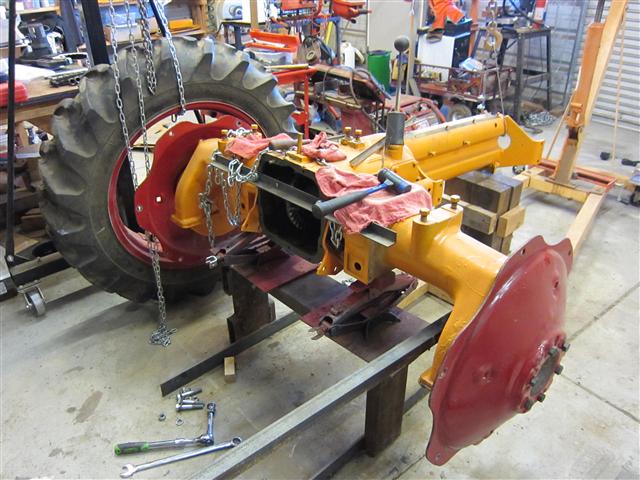

   / How to Jack up A tractor? #26
Those rear tires are really heavy and awkward to handle. Here's how I do it.
The tractor is a 1951 Minneapolis Moline BF that I've been restoring the past few years (I work slow).
The gantry is a $650 unit from Harbor Freight rated at 2000 lb.
Good luck and be careful out there:thumbsup:

   / How to Jack up A tractor? #29
flusher,
That's a nice setup. Thanks for sharing the pics.
Tim
It's all about safety. I work alone. Don't want one of those rears to get away from me and do some grievous harm to my 70-year old body:).
