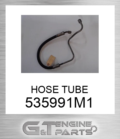

I goofed. That is a gas tractor isn't it? Probably #36 or 37 running down the right side.
#36 - 539507M1
#37 - 535991M1

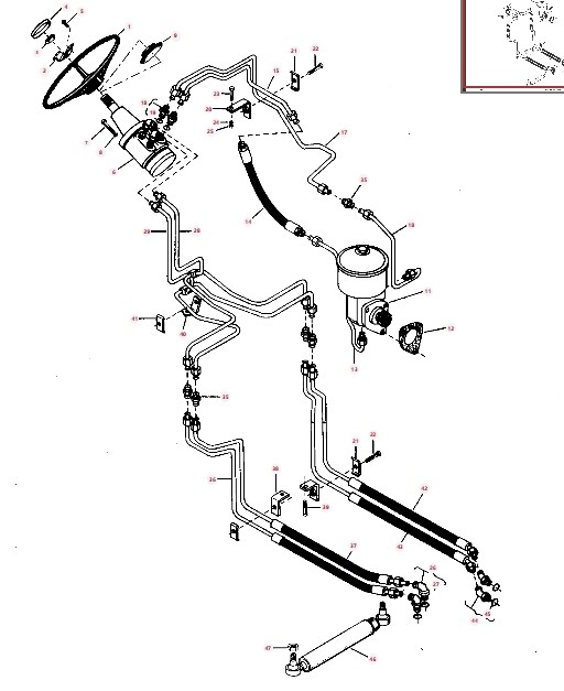

No it's the Perkins diesel. Your first graphic was correct and very helpful -- it is a bigger job than I'd hoped. Looks like I'm finally going to need the crow's foot wrenches.

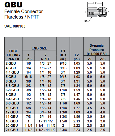

@TractorTech Does that manual happen to list the size of the flange connectors that can be unscrewed in order for me to take that whole straight piece of the line off?
   / How to Remove this Power Steering Hydraulic Hose #14
Not sure what you are asking, but the union is: JIC 9/16-18 thread Male X JIC 9/16-18 thread Male, so the connector is going to be JIC 9/16-18 Female. And yes, it is the same fitting on both ends; female.

Ford likes to do this with steering lines as well. The solution is to cut out the bad section of the hose and replace it. You do not need to take it to a hydraulics shop as it is easy to do and does not normally require removing the entire line.
-First clean the paint off of a section of the line and measure the OD.
-Then order a flareless tube fitting. I like Swagelok and Parker. Below is a snip from the Parker Farulok catalog. End 1 is the tube OD, End 2 is NPT end. I am partial to NPT as the hoses can be purchased at most local farm stores.
-Take the flareless tube fittings and hand tighten them on the hose. Mark the tube were it needs cut.
- Cut the tube using a tubing cutter to assure smooth square ends, deburr the inside.
-Clean all paint off of the cut ends back 2" and make sure they are smooth and not scuffed or damaged on the exterior.
-Put the flareless tube adapters on the hose and tighten them by hand as much as you can, then tighten the nut 3/4 turn.
-install hose. *If the fitting does not have a swivel end then you might have to put the fittings on the hose and then install as an assembly.
Its easy and cost effective giving you a better quality repairable solution that replicates the OEM lines. The cost is not too bad either.
I have done this on half a dozen lines and have had good success (except the first time I turned the nut on the flareless fitting 5 or so turns and cut the tube) The best part is that most of the time you don't have to remove the entire line.

This would be helpful except for the fact that there's no clearance available to do any cutting. No matter what I do, a majority of the steel line is going to have to come off. In which case, I'd likely do just as well having the hydraulic shop swap the soft hose for the price of the fittings and tools I'd need to do it this way. They'd probably be faster than me as well.
While the end that connects to the steering pump is easy to access, the other end looks like it's going to require me to take either the panel off, or the diesel tank off. Was trying to avoid all of that for just this one hose section. Perhaps I'm better off doing the Swagelok method so that it's at least easier to repair in the future....

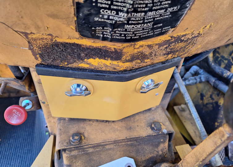

It is really tight around the orbital motor so hoses are most likely not viable. I know that anything under the dash on the 20C/30B is a pain to work on as MF welded the whole front console of the tractor up solid so its impossible to access anything. The previous owner on mine cut an access hatch in it. You can see in this the cover I made for it. It helps a lot, but access still sucks.
