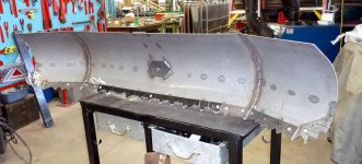

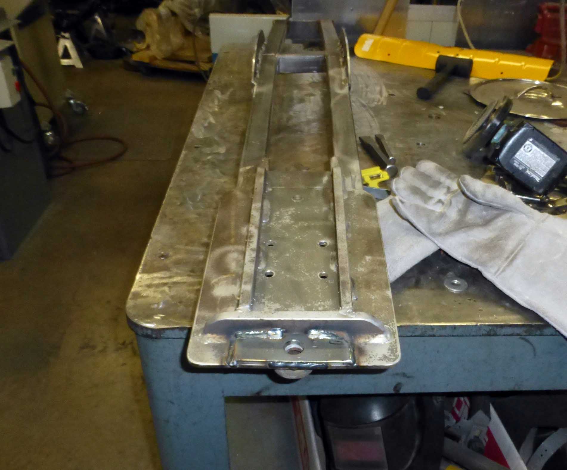

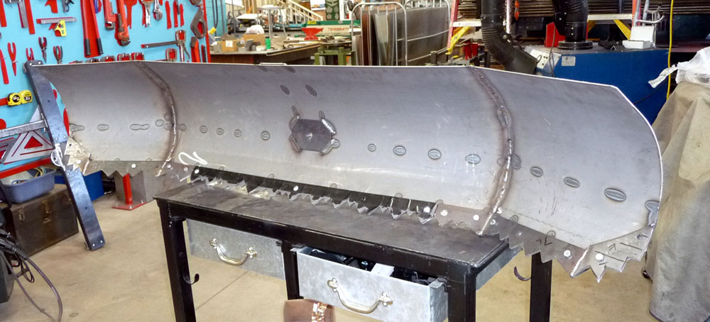

I eat, drink and bleed MIG. Many of my projects are dirty or painted, so the grinder is your friend. Have not stick welded anything for many, many years.
