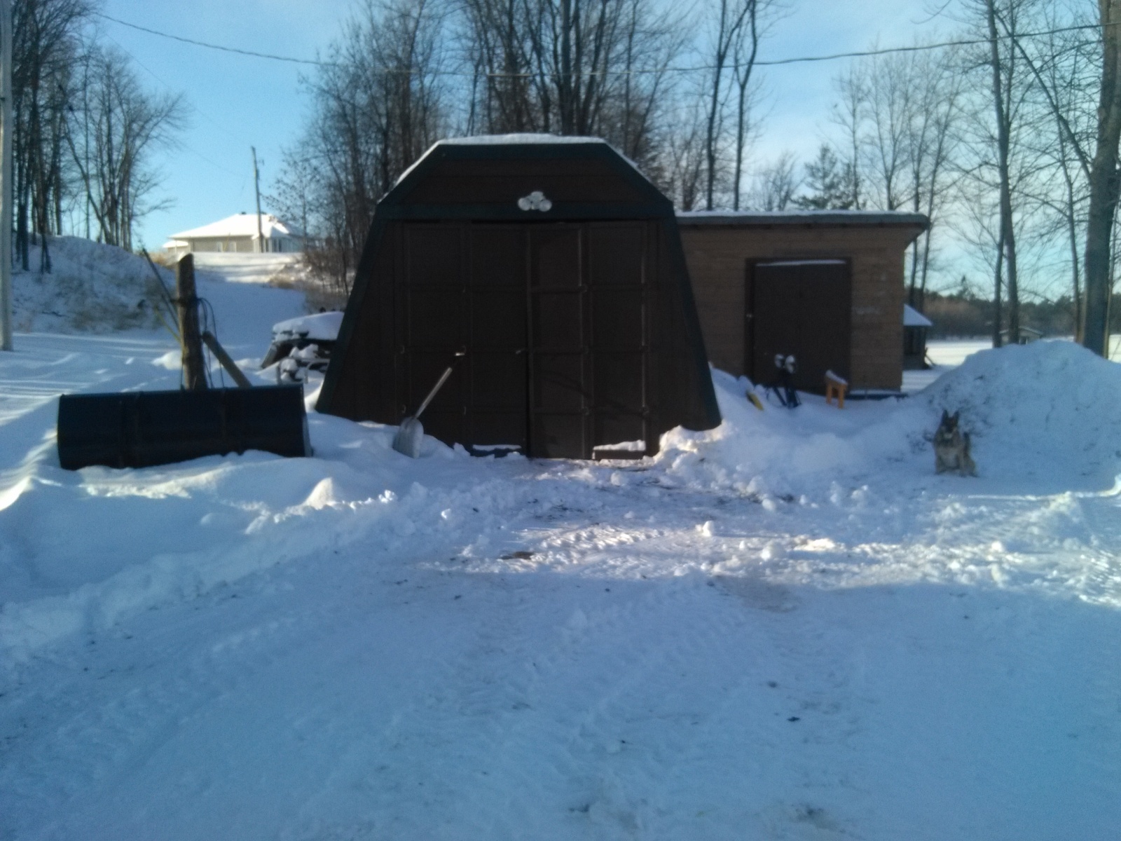

I also hard sided the front, didn't like the zipper door and made wood doors for the front.
Any pics you can share on the hard sided front? Want to add to my snow/wind load rated shelterlogic (the big one).
Sorry Msamt, I just read this, I haven't been getting notifications lately from this site, yes, I'll take a few pics today and post them for you.

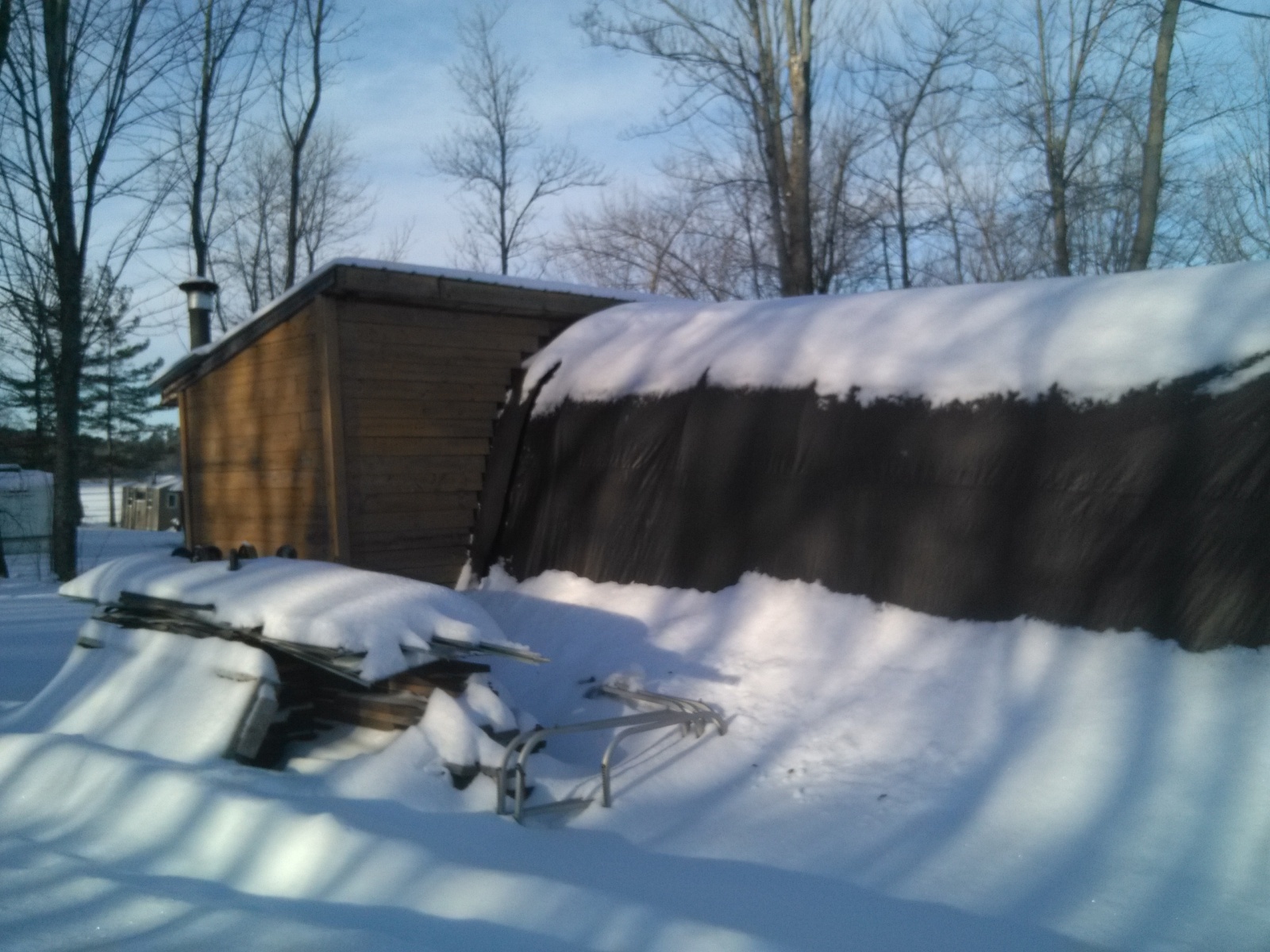

Here they are...You can see the addition I added at the back of it. I have a wood stove in the addition, this is my second tarp in 5 years, I also added the second frame of the new one inside "doubling" it's strength. The frame is now 2 feet apart as opposed to 4 originally.

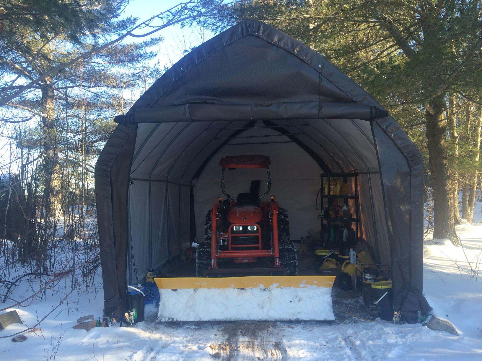

This is the one that I use....20 X 12 X 10.....it has a steeper pitch roof...snow does not accumulate but simply slides off....I also have the round top 24 X 12 X 10 however it does have a tendency to accumulate snow on top under certain conditions such as wet snow etc....
   / How well do shelter logic hold up in heavy snow areas? #90
That is the one I use for my Kioti.
